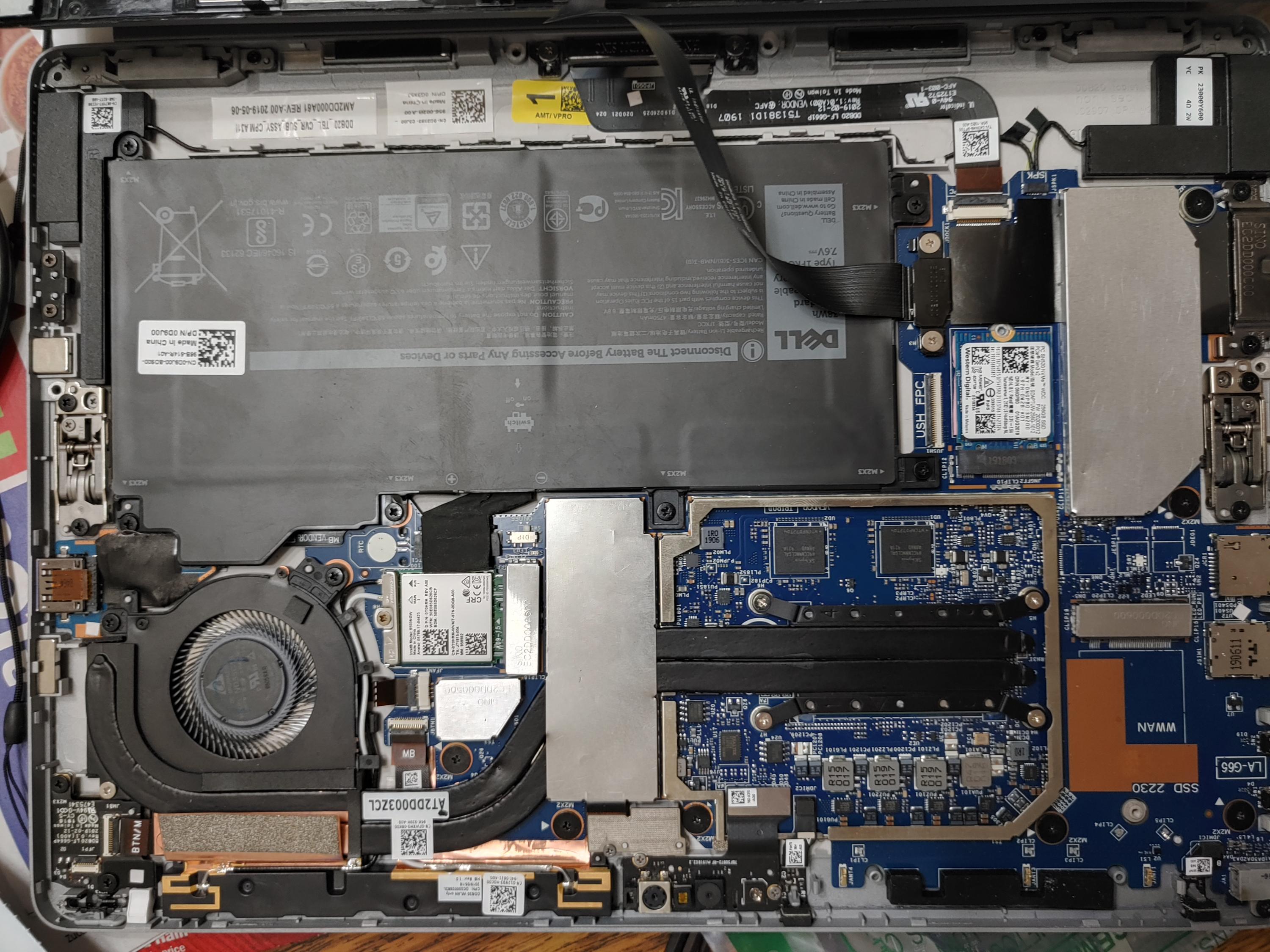

    Latitude 7200 2 in 1

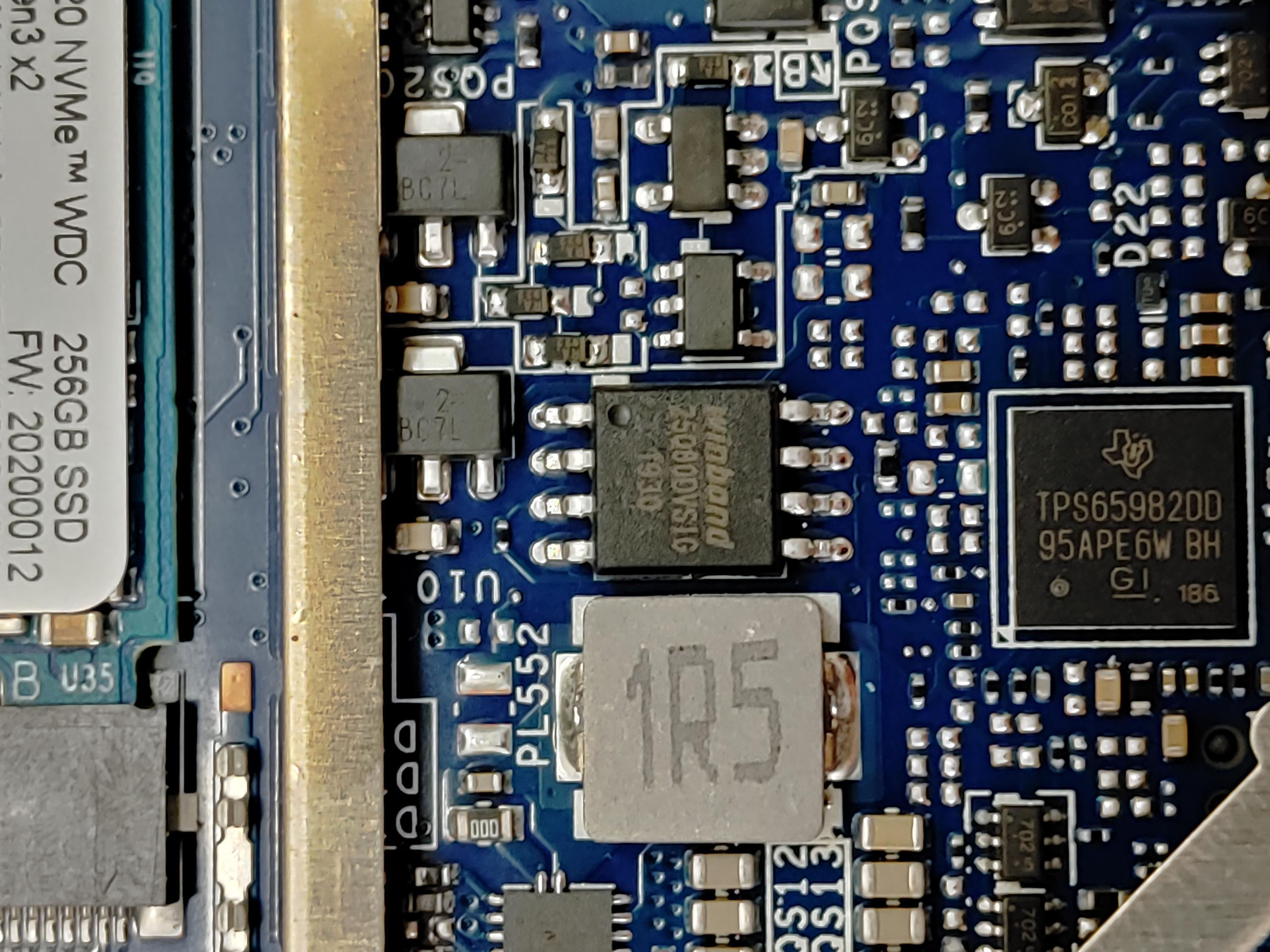

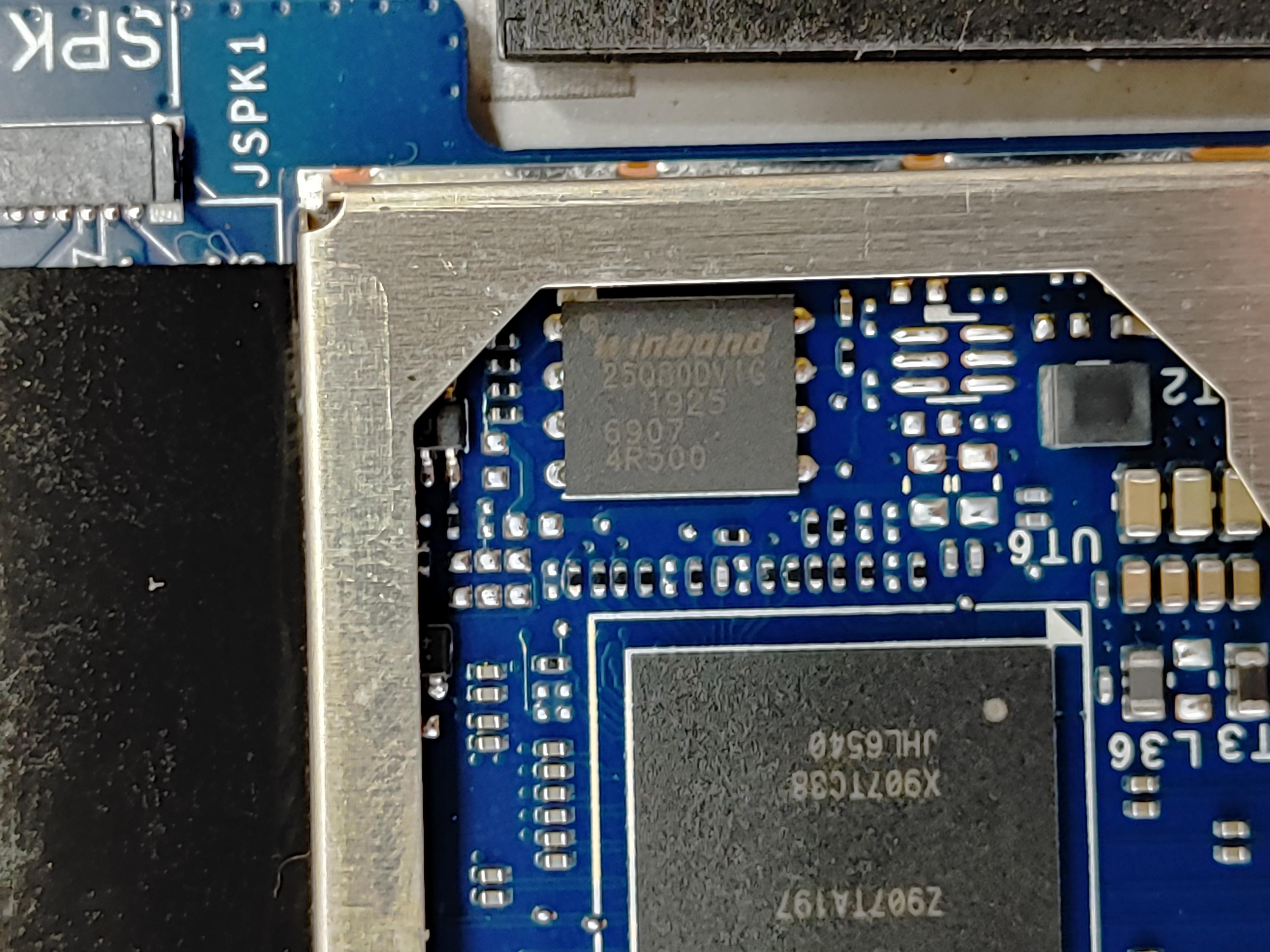

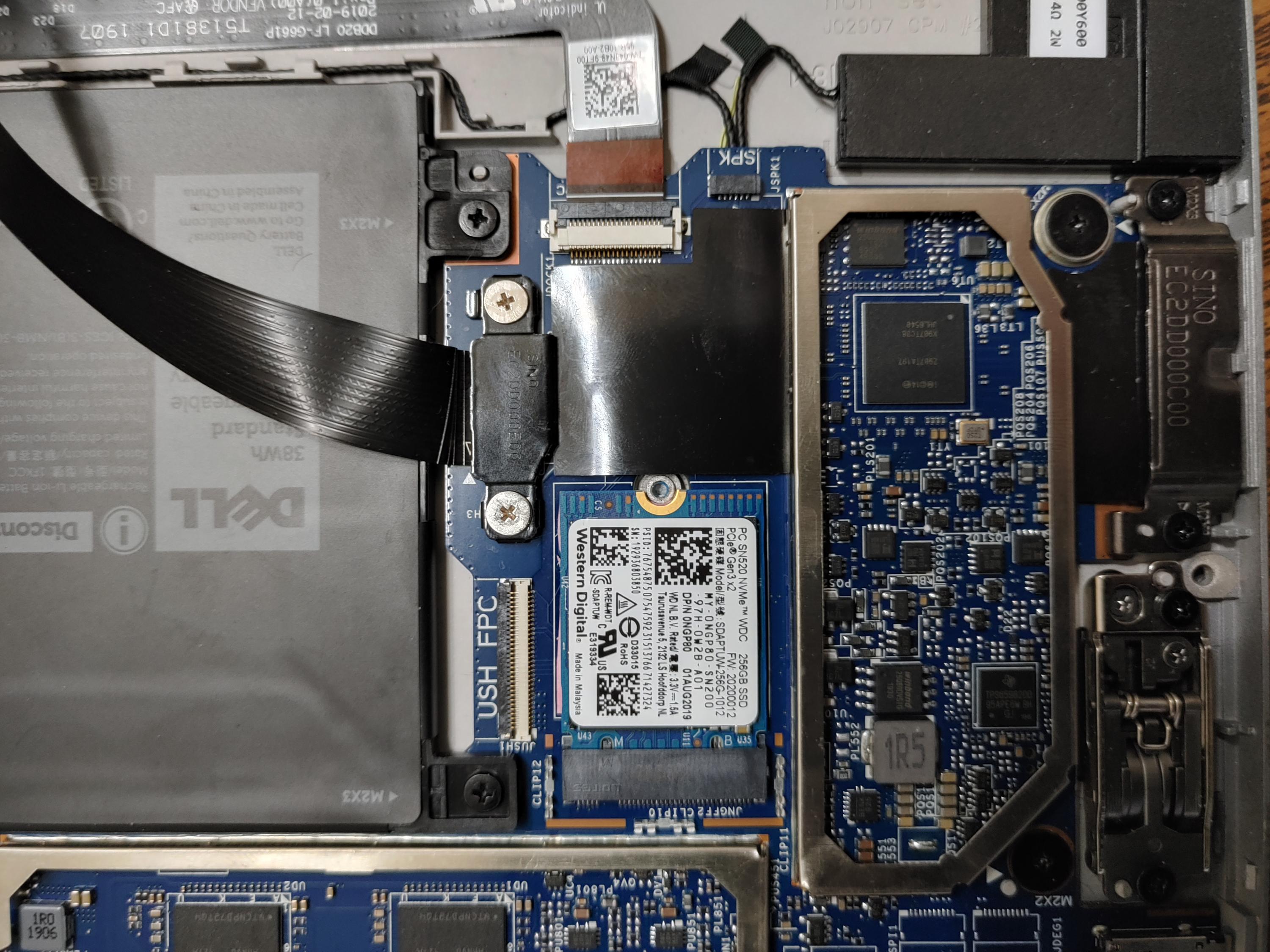

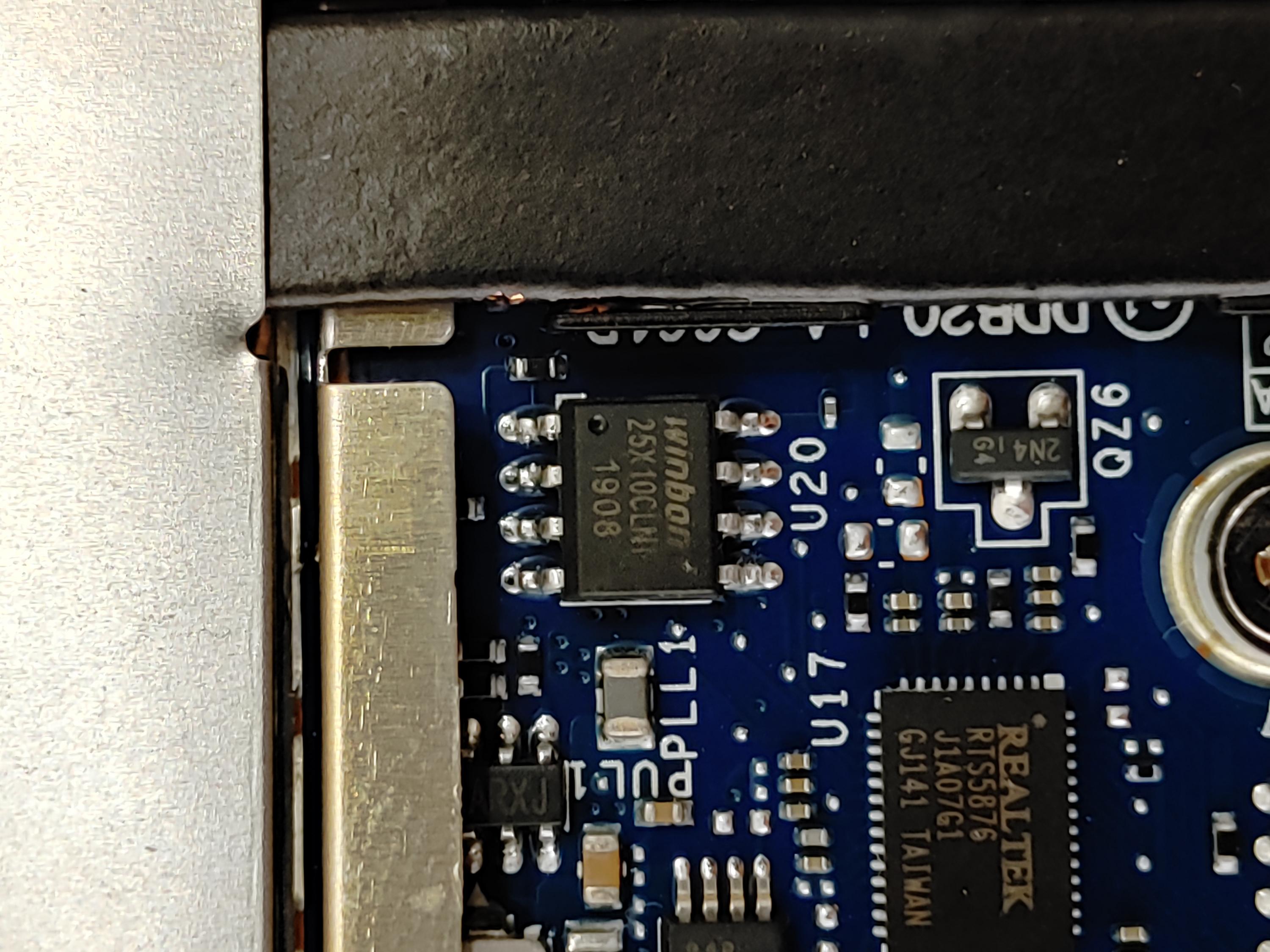

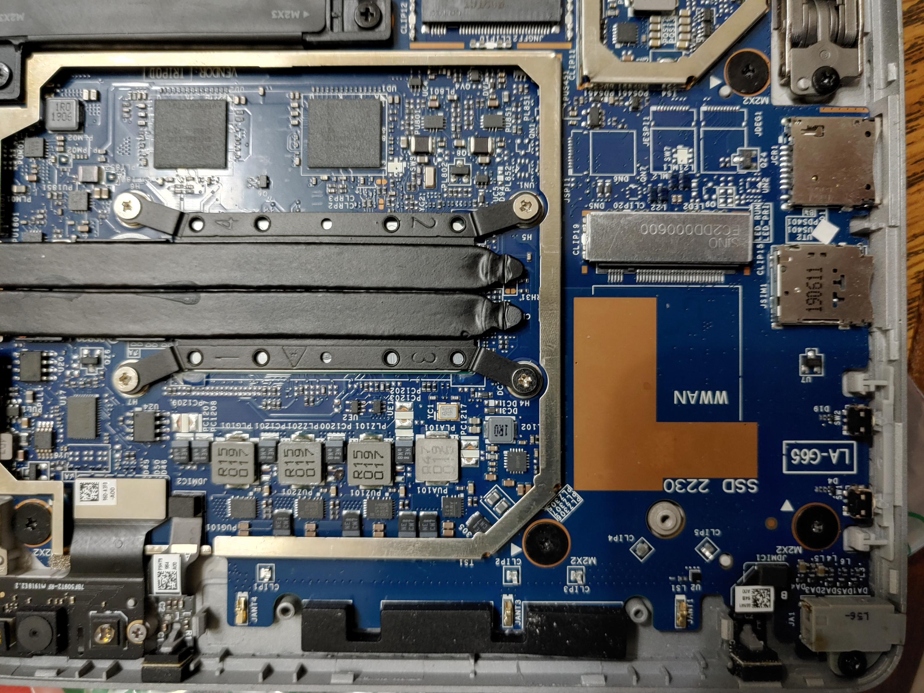

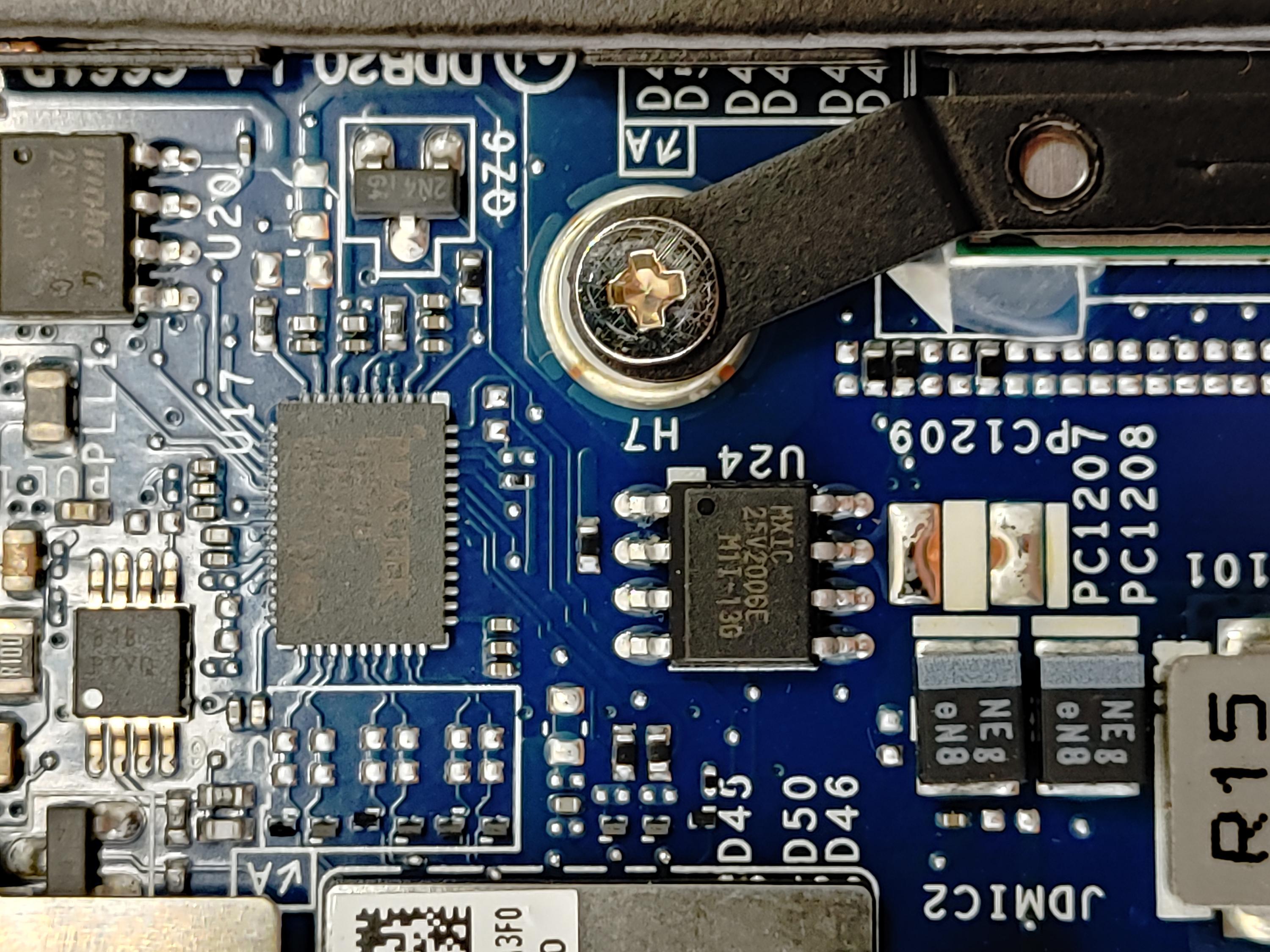

    I need to figure out how to unlock the bios on a latitude 7200 2 in 1. It won't boot up from the internal hard drive for some reason and I can't allow it to boot from usb with the bios locked down. I'm looking for either the master password or some help locating what the bios chip and a dump of a good one because the only thing I see on this motherboard are way too small to be bios chips.

    Re: Latitude 7200 2 in 1
    None of them is your main bios. Winbond 080 could be ec bios. main bios should be either 8mb or 16mb-not sure which is correct on this platform. So look for bios chip with 64 or 128 letters on it. Eg:W25Q64FV
      I'm thinking it may be on the other side of the motherboard, which requires a whole lot more work to remove
      • mikegarvin34
        • Feb 2020
        its on the back mec5106 i think
