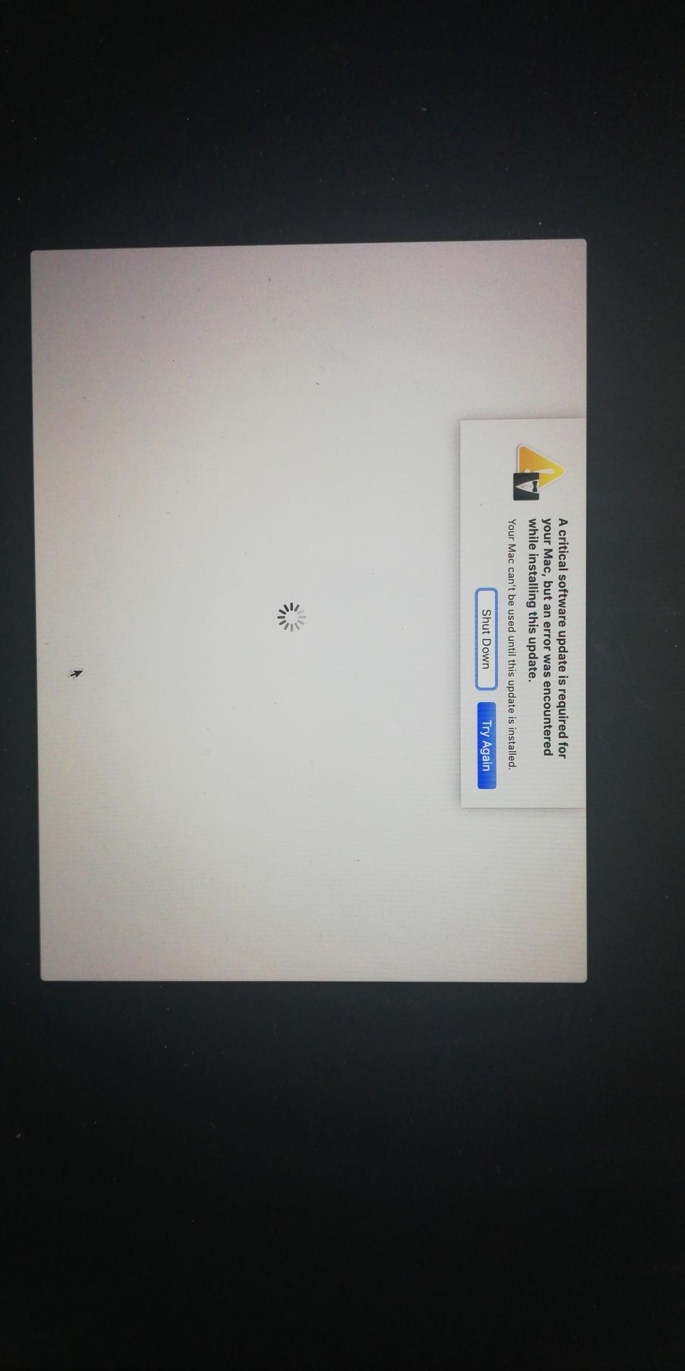

    Mac pro a1707
    I have problem with mac pro a1707-820-00281-a when and try to install software mojavi or any one it ask me error cirticl update and still on this screen ..
    any one have answer ?
    I attach photo for the problem and the bios for this mac.

    T1 or touchbar related problem, touchpad, corrupt operating system… can be a lot of stuff. Better take it to Apple if there is no liquid damage.

      Thanks dear for answer but the problem came after i update the software it ask me to restart and work with this problem ..

          Go to terminal and set your date and time to 01-01-2016.
          I think it will solve this problem

                                    Hi, can someone help me to clean ME bios of this Macbook pro a1707 dump file?
                                    Motherboard 820-00281-A.
                                    After an update (go wrong), at the boot stuck at this warning windows "A critical software update is required for your Mac, but an error was encountered while installing this update" or "Your Mac can't be used until this update is installed"
                                    Thanks very well!!

                                      Hey all
                                      Also a 820-00281-A with a failed critical updated.
                                      I know it could be touchbar and T1, but can someone clean ME of my backup?
                                      Thanks in advance

                                        So it was the touchbar all the way.
                                        Tested in another assembly, installed OSX just fine.
                                        If someone needs a working bios, mine is OK.
                                        Just needs to be ME cleared.
                                        Thanks!
