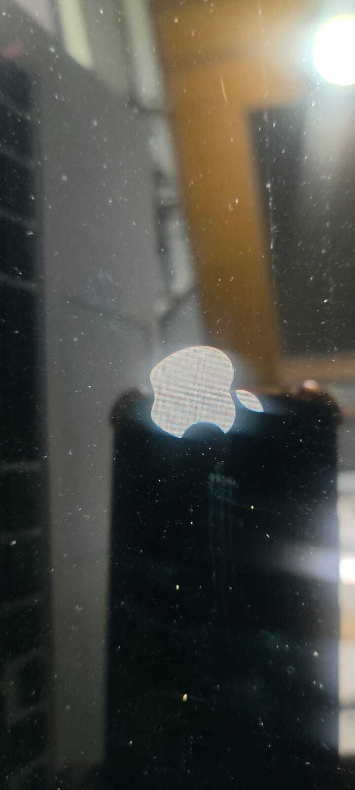

    Hi, working on this Apple MacBook Air 820-00165-A (1.8 GHz Core i5-5350U EMC 3178) not booting to OS. There was no liquid spill, checked under the microscope, no signs of spillage. Only not booting to OS, hangs on the Apple logo., bar moves till the end but does not do a complete boot. I re-flushed the EEPROM, with the correct serial # injected & verified the checksum. All fine, after writing to a new EEPROM still the same, hangs on Apple logo. I am uploading the original bins file. Please someone have a look & kindly do a ME Region cleanup again if I have not done correctly. Thanks

    try...

      Thank you Sir, keep you posted if works or not..

        Yes Sir, all works fine & Boots like charm. Can you inform me how did you build up a clean ME region because my method clearly did not work?? or is there any Video tutorial on Youtube so that I can understand this well (& you have 2 things added to my Bin file -- ME 10.0.35.1012 - 10.0.35.1012_SLM_PRD). Thank you for all the help.

            hi sir plz solve my problem
            macebook logo hang
            820-00165-a
            model a1466

              post EMC..

                EMC no 2925

                  try..

                    same problem
