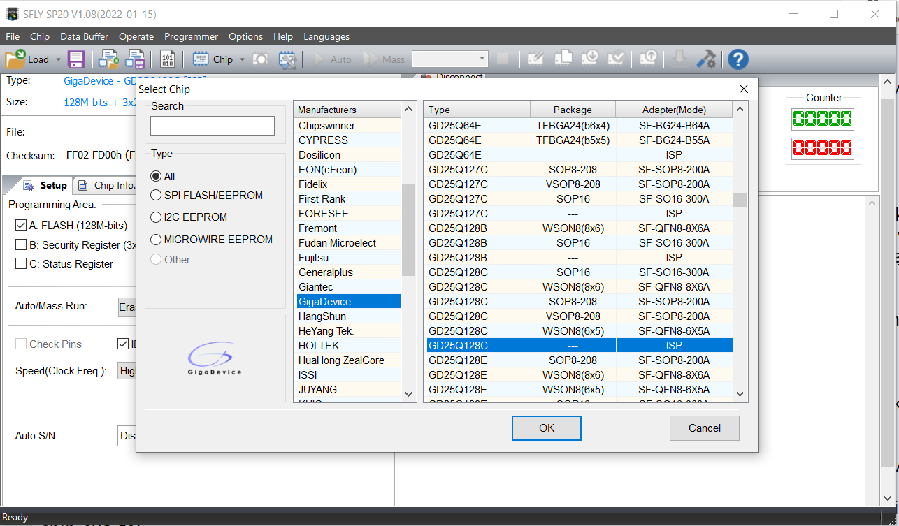

                            HP ProBook 430 G5 2VP86EA , Motherboard DA0X8BMB6F0 rev F
                            Greetings,
                            1. I have an HP ProBook 430 G5 2VP86EA laptop
                            The BIOS is locked with an admin password and I do not remember it
                            Its BIOS chip model: Gigadevice HH1742 25B127DSIG AP15471 3.3v
                            I placed an order from the EBAY website for a replacement BIOS chip for the laptop motherboard model: DA0X8BMB6F0 rev F
                            The store wrote me that the chip model they will send me is: GigaDevice 25Q128CSIG
                            I want to make sure with you is it possible and electrically safe for the replacement chip model to be compatible with my laptop instead of the current locked BIOS chip?
                            Beyond that, I do not know if you can explain to me that the computer manufacturer HP refuses to give me support:
                            Will replacing the BIOS chip remove the password and I can finally enter the BIOS?
                            Because one of the stores on EBAY wrote to me that it would be necessary to replace the i/o microcontroller EC chip as well, claiming that the password is also stored there and that I would have to use a programmer to do it otherwise there will be an error message and flicker on the screen and and the computer will not work.
                            I do not understand anything about it.
                            2. I have technical questions in case the chip I ordered will not be able to remove the administrator password from the BIOS:
                            What model can a programmer read and write about my BIOS chip model?
                            I do not have a programmer
                            But I installed softwares of some programmer models and my BIOS chip model was not supported by these programmers softwares:
                            https://www.alisaler.com/category/so...mers-software/
                            On top of that my BIOS chip model works with 3.3v and I have not found a programmer that supports it.
                            I would appreciate if you could explain to me and recommend me a programmer model that supports my chip.
                            I saw on the Amazon website this model with a wire that connects to the motherboard without having to solder the chip:
                            https://www.amazon.com/gp/product/B07SHSL9X9
                            But this model does not support my BIOS chip.
                            Neither in terms of software (chip model does not appear in its software)
                            and neither in terms of hardware (3.3v)
                            I would appreciate it and thank you if you can answers my questions and explain to me as much as you can.
                            Last edited by leezhihao2020; 02-07-2022, 07:11 AM. Reason: I forgot to ask some questions
                            • hoaca388
                              Badcaps
                              • Jan 2022
                              • 11683
                              Re: HP ProBook 430 G5 2VP86EA , Motherboard DA0X8BMB6F0 rev F
                              I'm using this ( SP20P ) : https://item.taobao.com/item.htm?spm...id=37536726969
                              you can try to find it on AliExpress.
                              NOT FOR PROGRAMMING EC.
