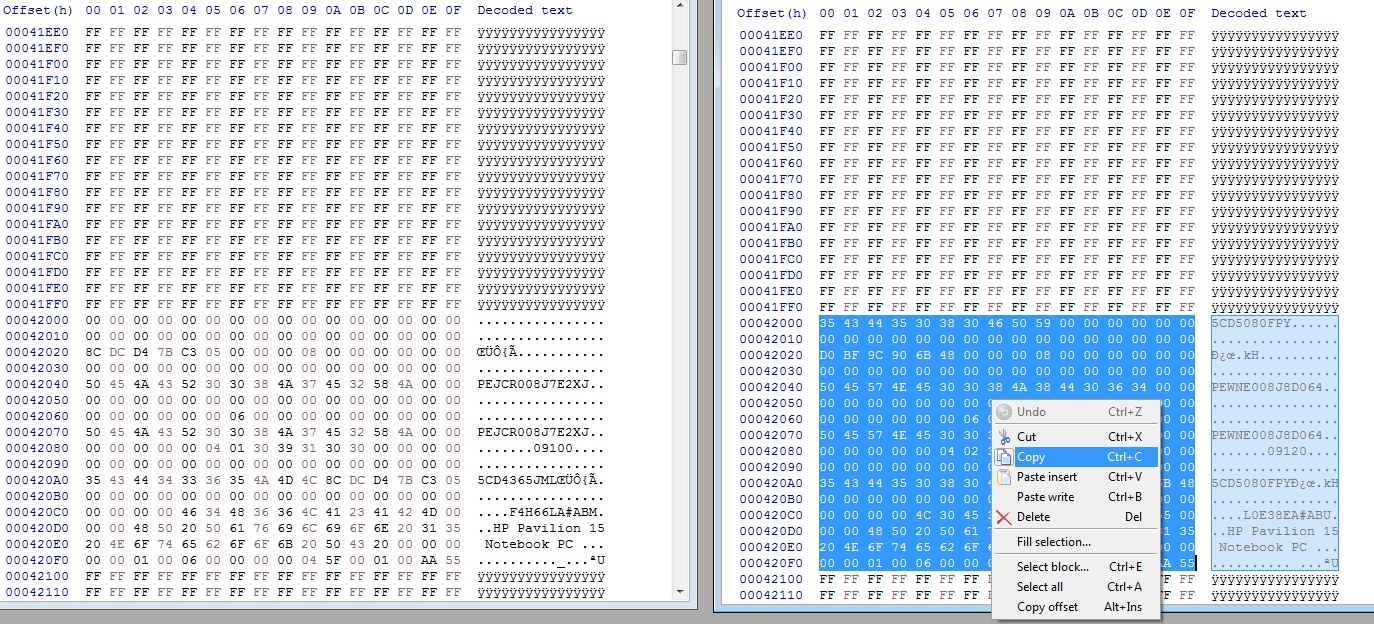

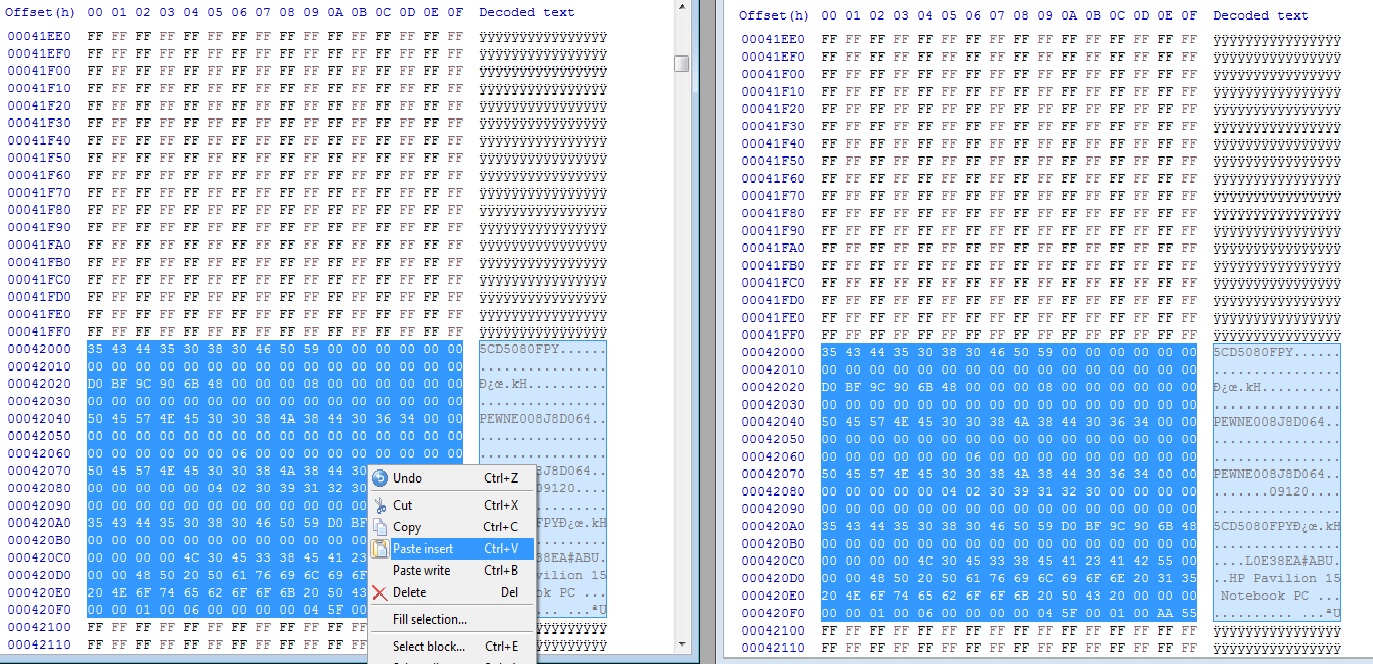

    bios hp 15 DAY23AMB6F0 repair
    so i have this hp and its got one bios that doesn't power and one that does power but i have no serial in it.
    can i get some TLC with this bios please <3
    • 20977
    Re: bios hp 15 DAY23AMB6F0 repair
    Try this one,your DMI included.
    • dj_ricoh
      • Jan 2013
      • 2073
      • uk
      perfect. thank you
      is there a thread how you done it?
        • 20977
        I just used a hex editor, HxD https://mh-nexus.de/en/hxd/ .I copied your old DMI over to the other bios.Its usually quite easy with an AMD bios as the DMI is in one block.
