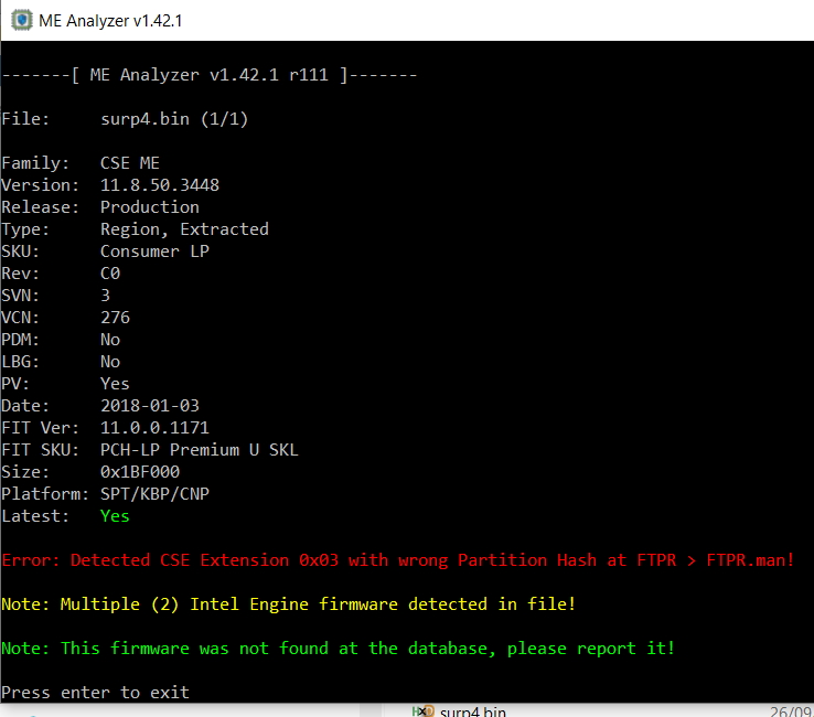

    Hi, it's very difficult to find a worked bios dump for this model due to bootguard enabled and other things (I read this info from winraid forum) so I decided to made a clear ME but with no success. I don't understand the error message that ME analyzer return. Someone can to try to repair this file ? Thanks
    This is your dump bios or the new bios file that you have download?

      my dump
      BOARD X911788-008 MODEL 1724

        Try and report..

          Make sure you always use the latest version of MEAnalyzer.

            Originally posted by Claudiomfa
            Try and report..
            Your Clear Bios as the same behavior as other Bios I have downloaded but at least it's the original. (Thanks) . Probably it's works but the system stuck on red bar with open lock and surface logo. I don't know if there are other hardware problems, but the operating system won't load. I don't know how to update the EC because on this card I can't find it's memory that they say is a 25w20. Probably with vertyanov and keyboard connector ?
              • 22077
              Re: Surface 4 pro 1724 corrupted bios
              Try this repaired bios .
              EDIT: if it still boots to the red red stripe shut down completely, then holding volume up rocker press the power button, do not let go of the volume rocker until the Surface Logo appears, that should get you into the bios, then enable secure boot.
                Seem as the volume + button don't take any effect, you know how reprogramm ITE ?
                  No, don`t know how to program ITE on this motherboard. Here`s one more bios to try;
