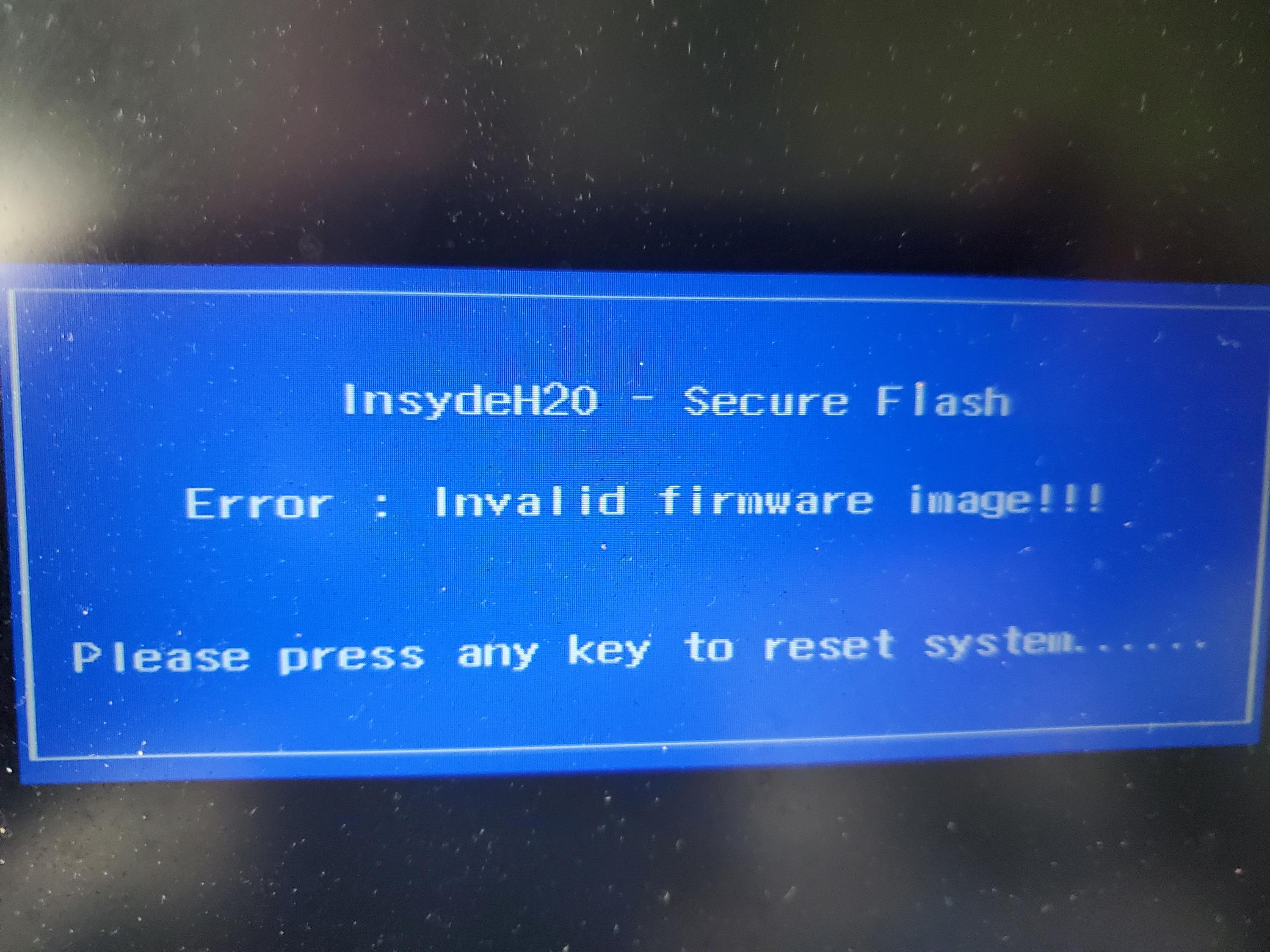

                          I have a vostro 3560 that has black screen with one beep continuous. the dell bios update from a15 to a20 does not work says software not compatible.
                          after trying to boot 20 times works
                          the beep code says checksum error.
                          how can I update this bios to the a20. dell site says urgent but does not work o win 10 64 bits
                          I download these bins but no sure how that works. please help

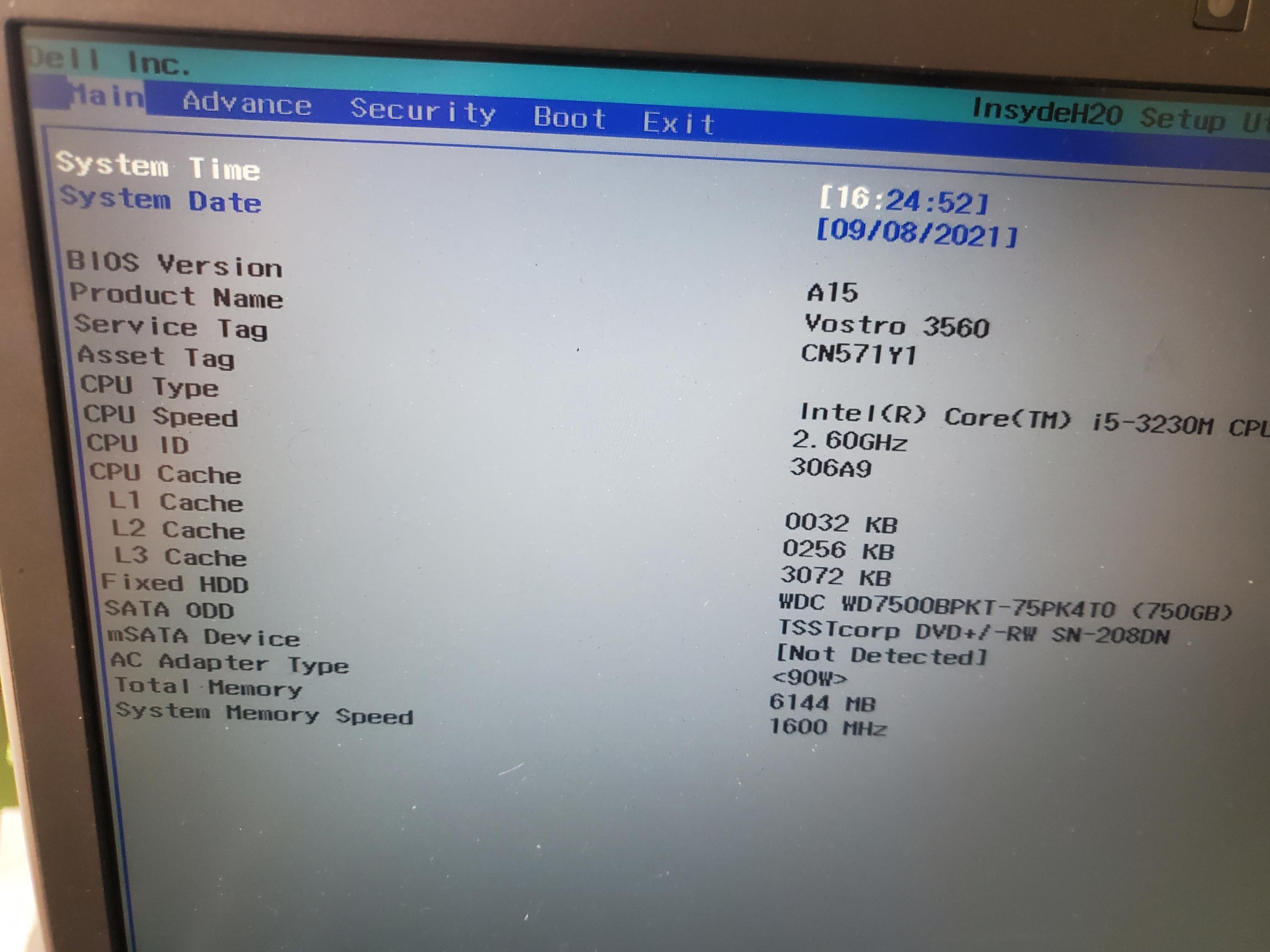

                              I use a couple bios software to backup but they don't recognize the bios
                              bios backup tool kit
                              my bios is insydeh20 a15 bios

                                Software won`t backup. If you can boot to the bios check the version number,then boot into windows and flash the bios to the next version upthen the next.
                                Check the CMOS battery voltage as well.If you can`t boot up at all buy a programmer and a sop8 clip ,the cheapest is the CH341A .
                                • leofaria

                                  Thanks for the reply. the updated version is a20 from the dell site but when I run the pc will restart and say wrong firmware
                                    • 22084
                                    Re: re-dell vostro 3560 bios
                                    Try and flash A16 first ,then A17 ,A19 ,then to A20 if you want. Each time you flash you risk bricking the laptop.If it does get bricked then you will need a programmer.
                                    A16 https://dl.dell.com/FOLDER01874731M/1/3560A16.exe
                                    A17 https://dl.dell.com/FOLDER02148905M/1/3560A17.exe
                                    A19 https://dl.dell.com/FOLDER04862241M/1/3560A19.exe
                                      Thanks I will try
                                      edit same error with the a16

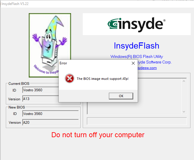

                                        Hi All,
                                        i try to upgrade my Vostro360 from A13 and using 4Mb.bin from here i see there's a chance to do that. What i see unfortunately is "The BIOS image must support the ATp!".
                                        What kind of tool it's better to use to upgrade the BIOS on this model?
