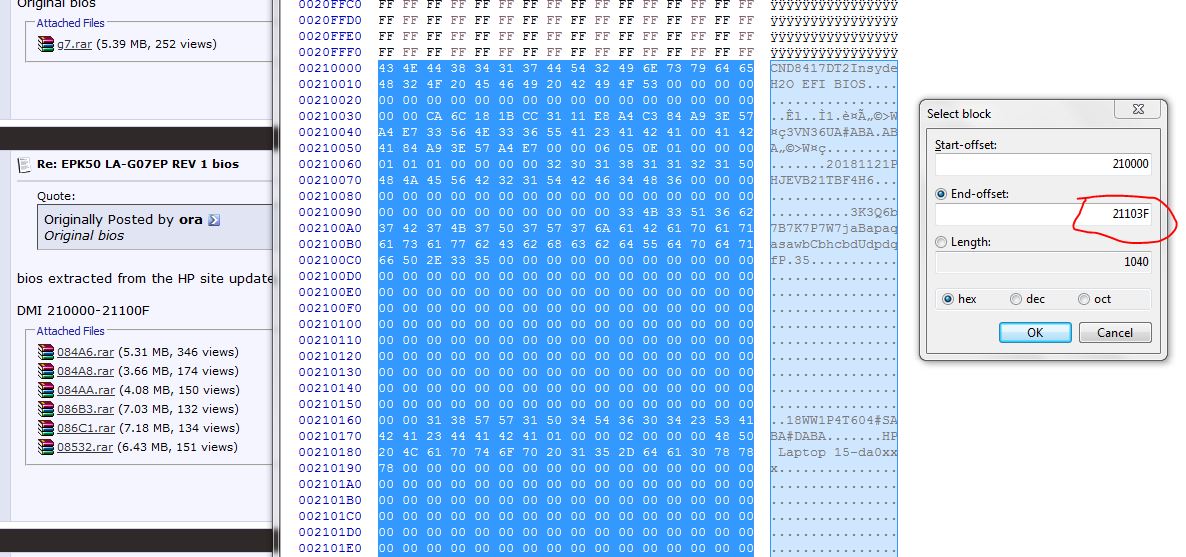

    Originally posted by Ripukas
    Hi, how you identify bios variant? maybe you have EC (ene) file?
    EPK50 LA-G07EP
    you need the HxD program, you can find it on the net for free .... enter the bios in the program ... click "search", a window will open, write in it the word "bid" and press "ok", press the F3 key three times and you have reached the bios version..go to post # 13 and take the version you need from there ..

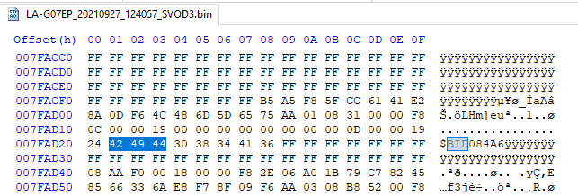

      Hi. I'm a noob, please help me. I opened my original bin file in HxH -after reading it and saving it with a CH341A programmer-, followed your steps and after hitting f3 three times I don't see anything resembling the versions on post #13 you mentioned, so I'm stuck. I'm giving my laptop info and posting the original corrupted .bin file as well, in case you can help identify what version I need.
      Laptop model: HP 15-da0077nr
      Motherboard number: EPK50 LA-G07EP Rev 2.0
      I'd be eternally grateful.
        press the F3 key until you reach the BID version, in your case 084A6.

          Thank you very much man. Another question: if I flash this bios, I'm not going to have my motherboard information loaded, right? Like serial number for example. If not, how can I modify the new .bin with the existing information from old bios?
          I'm assuming that with HxD I can do this, but the question is how.
          Thanks.
            • 21662
            Re: EPK50 LA-G07EP REV 1 bios
            Thank you very much man. Another question: if I flash this bios, I’m not going to have my motherboard information loaded, right? Like serial number for example. If not, how can I modify the new .bin with the existing information from old bios?
            I’m assuming that with HxD I can do this, but the question is how.
            Thanks.
            Post #13 by @peste has the DMI offsets that you can use to copy the DMI from your old bios to the new virgin bios (the end offset was wrong,i edited the post).Select the start and end offset in your old bios,then copy, select the same start and end offset in the new bios, paste-insert then save .
            210000 - 21103F

                            Originally posted by DWCS
                            EPK50 LA-G07EP REV 1.0 Main and ec bios need cpu i3 cpu ID - sr3w0
                            8th gen
                            Please read posts 13,21 and 25 .Use a hex editor to find your BID in your bios backup (post #21) to find the matching virgin bios (post #13) ,then copy your DMI to the new bios (post #25)
                              search for the text BID.
                                bios extracted from the HP site update, the laptop has six bios variants, yours is 084A6
                                DMI 210000-21103F
                                Thank you
