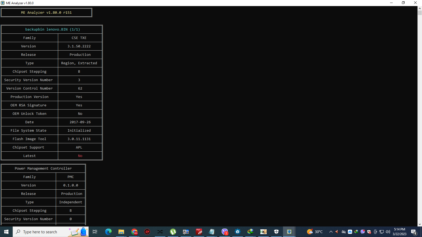

Lenovo 320-14iap no power needed bios `
  • kalilinux25
    • Mar 2018
    • 2089
    • ZAMBOANGA SIBUGAY
    Lenovo ideapad 320-14iap
    dg424/dg524 nm-b301
    rev 1.0
    2017-03-09
    no shorted coils i think bios problem or ec
    backup also here

    Re: Lenovo no power needed bios `
    try post#4...
    https://www.badcaps.net/forum/showthread.php?p=900975
        The bios linked to by peste is good,test all voltage and signals on page 48 of the schemmatic.
        https://www.badcaps.net/forum/showthread.php?p=907334

          Hi sir can you please check my bios it for
          DG424/DG524 NM-B301 REV 1.0
          2017-03-09
          motherboard cpu is
          SR2Z6 Intel Celeron N3450
          SERIAL NUMBER PF12DQM0
          LENOVO 320-14IAP
          Please check if my bios is back or need clean sir update

            Originally posted by kalilinux25
            Hi sir can you please check my bios it for badly need it to clean its me region
            2017-03-09
            motherboard cpu is
            LENOVO 320-14IAP
            it my backup
            Hope someone can clean this bin and clean me region also.
                    Why if I used a latest bin from official website it wont power the board? Do I need also to flash the EC bin? , but if I put back the original bin it will power the board , but it has a issue stock on windows loading screen even live os is tested.
                    this is the ME Analayzer showing the backup bin
                      • 21163
                      320-14IAP Laptop (ideapad) - Type 80XQ 5RCN**WW
                      Flash the bios and EC -> https://www.badcaps.net/forum/showpo...78&postcount=4
                      Copy your DMI from your backup using the attached CopyDMI script .
                      Copy DMI info easily with Hex editing software and Macro script: https://www.badcaps.net/forum/showthread.php?p=1214739
                      0x0421000 - 0x0422FFF

                          Re: Lenovo 320-14iap no power needed bios `
                          Update regardign about this unit it was not about the bios it was a very tiny rust in the ec chip , I really need to invest a microscope now a days, but thanks for this
