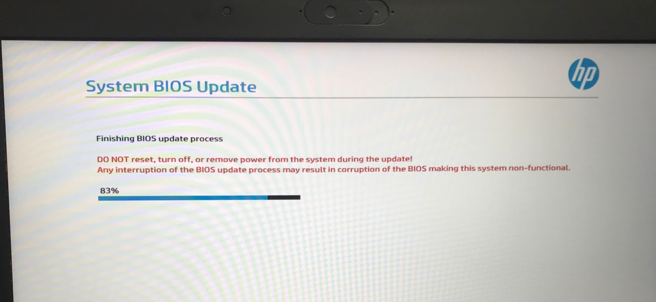

            #105
            Hp elitebook 830-g5
            Hi friends
            pls anyone help me to repair this bios
            updating fail and auto restart
            6050a2930901-mb-a01
            thanks in advanced

              #106
              Re: Hp elitebook 830-g5
              Originally posted by Murtaza527
              Hi friends
              6050a2930901-mb-a01
              thanks in advanced
              bios region fixed but not cleaned try

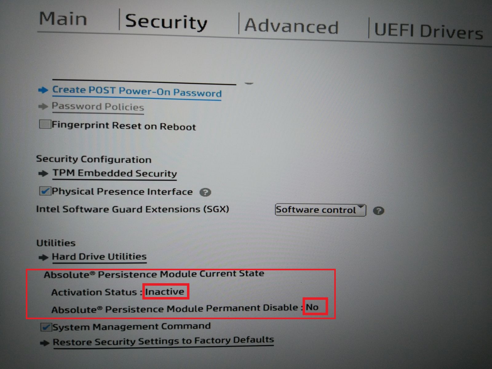

                                  Re: Help with HP 830 G5 bios
                                  Hi Guys I have hp 830g5 bios dump and i think is a moded dump because it is blocked by Absolute software and it freezes my OS even i format the system.. CAN u help me and give a clear dump ..THANks
                                  • kulokutoys
                                    • Jun 2010
                                    • 132
                                    • Phillippines
                                    #117
                                    try
                                    • Vesko356
                                      VIP Moderator
                                      • Aug 2018
                                      • 4386
                                      • Bulgaria 🇧🇬
                                      #118
                                      ...and i think is a moded dump because it is blocked by Absolute software and it freezes my OS...
                                      It's not a modded bios, but a ordinary one just the Absolute persistence module is enabled as I see. There is no bios password in your dump, so you can view the current state under the security tab.
                                      Edit: image for reference added
