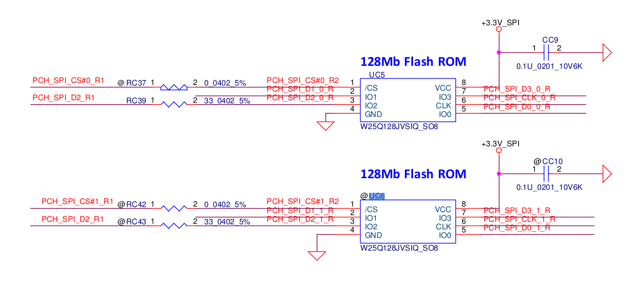

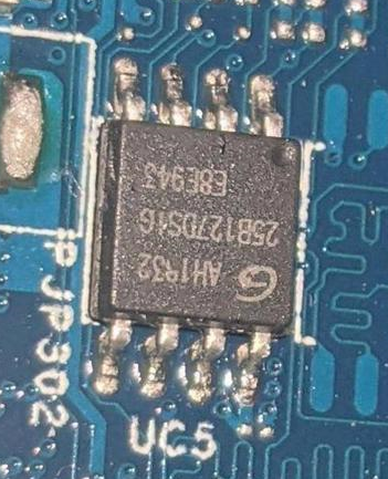

            #105
            Hello everyone.
            Dell Latitude 7390 I5-8TH
            LA-F312P Rev: 2.0 (A01)
            s/n 3WJM5S2
            LEDs flash at startup, no screen.
            I probably (if this is possible) damaged the bios chip because I forgot to remove the batteries.
            In fact the chip is not automatically detected and even by putting a similar bios I cannot do the dump with Ch341A. (only 0).
            I suspect that the Chip is burnt, I would like to buy a blank one on ebay, but I don't know which one to get for these two reasons:
            1. chip model not perfectly readable (doesn't even seem to be winbond)
            2. There are two chips with 8 pins (as visible in the photo)
            That the real bios is on the opposite side from where the ram is?
            Thanks for giving me help.
            image 1: I think it's the bios chip (it's the one attached to the post)
            image 2 the other chip with 8 pins.

              #106
              Originally posted by Spikeman
              Hello everyone.
              s/n 3WJM5S2
              I did some research and figured out which bios chip. So I performed the dump and very hopefully I wanted to write a bios test that you have already released in this thread.
              But with desolation I see that they are all around 8Mb, while mine is 16Mb. So it doesn't seem very convenient to me to delete the 16Mb bios to write an 8Mb bios over it.
              I read that: "EC/ME FW on 8Mb and Bios Region on 16Mb". So I'm wondering what should I do.
              Thank you
              Since I find it inconvenient for the forum to upload a 16mb file, it also seems like I don't have permission to upload a .bin file, maybe I should zip it?
              I uploaded it online anyway
              Bios dump: 7390.bk.bin
            • Markus1741
              • Sep 2020
              • 843
              • N/A

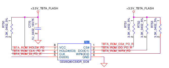

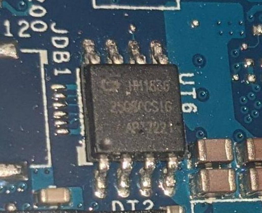

              #107
              Hello two things UT6 chip is for Thunderbolt interface stay away.
              Your BIOS is UC5 I did an ME clean of your BIOS you can program it and only that.
              You also can't program an 8MB BIOS on a 16.8MB chip, that's not possible.​
              To upload something create a RAR or ZIP file then it works too.​
