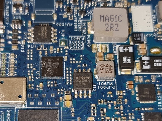

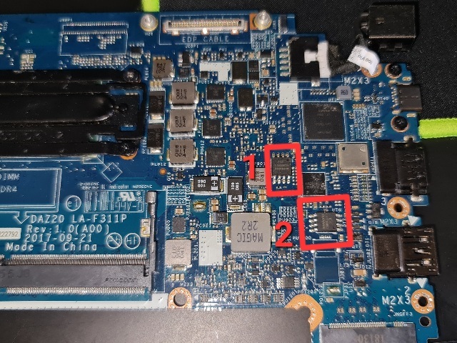

                          #93
                          Please Help Laptop did not turn on, suspect the bios is corrupt, power rail normal, ram, ssd, display normal
                          I need the bios file for
                          Dell 7390 i5Gen 8th
                          DAZ20 LA-F311P Rev 1.0 (A00) 2017-09-21
                          I try to read the bios using CH341A usb programmer, it is 1MByte in size
                          There is two identical Chip near each other
                          Winbond 25Q80DVSIG 1808 and 1809
                          Much appreciate for the help

                            #94
                            Dell 7390 i5Gen 8th
                            Wrong chip.
                            • octowell
                              • Mar 2024
                              • 4
                              • Indonesia
                              #95
                              Originally posted by hoaca388
                              Wrong chip.
                              Yes, i think it should be 16MByte chip
                              But this is from the laptop itself never change the chip
                              Im also confused why those 2 chip is only 1Mbyte
                              Couldnt find any chip labeled winbond on this mobo
                              Maybe any pointer & reference?

                              EDIT : 16 March 2024
                              Device Detail:
                              Dell Latitude 7390 Non-Touchscreen
                              i5 8th Gen
                              8GB DDR4
                              256GB NVME
                              Board DAZ20 LA-F311P Rev 1.0 (A00) 2017-09-21
                              Service Tag : 60F44Q2​
                              Found the Bios Chip (GD25Q127 128MBIT SOP8), and already Solved the bios issue
                              Only the device type shown in BIOS is Dell 7290 not 7390
                              Thanks all for the help
