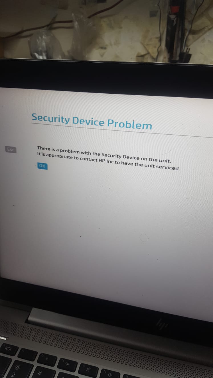

                HP MT44
                part number
                TRYPTICO 6050A2945701-MB-A0
                need hp mt44 ec patch file, without any error
                many time i try and make his ec bios but give
                ( security device problem error )

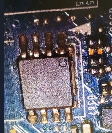

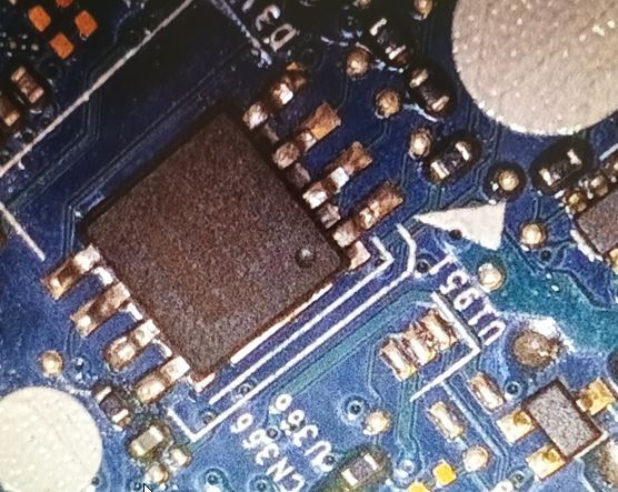

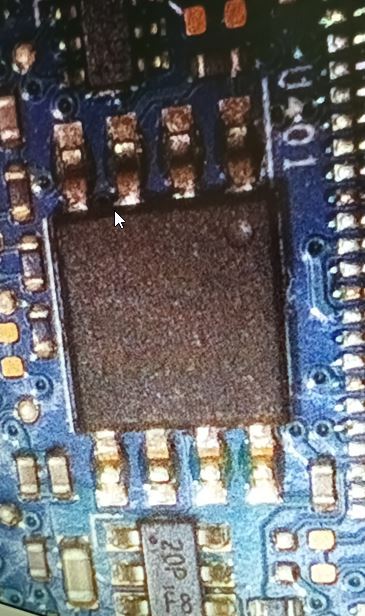

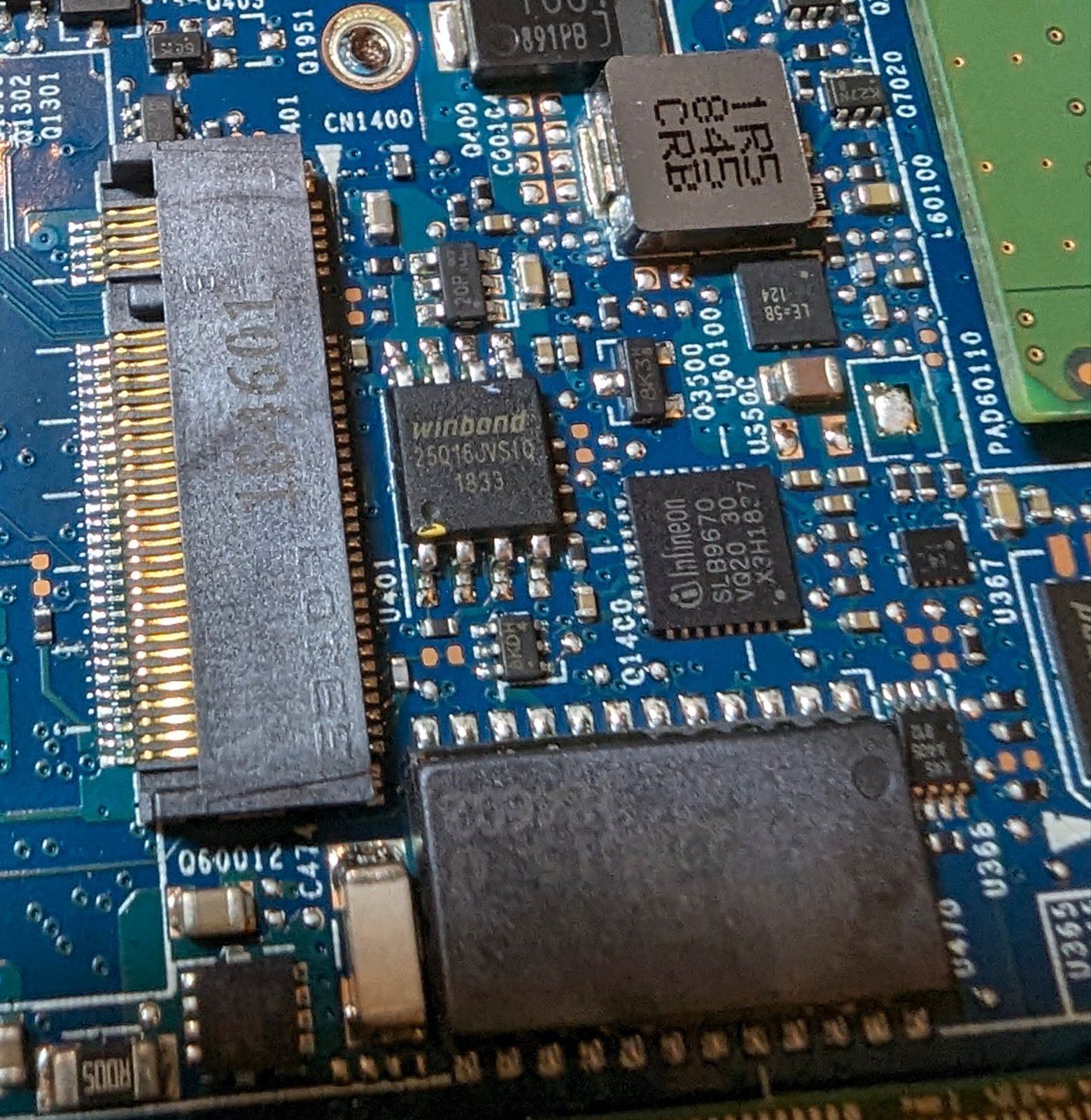

                  Also have a HP MT44 Mobile Thin Client. with 2 bios chips:
                  Winbond 25Q128JVpQ
                  Winbond 25Q16JVSI0
                  which chip contains the bios password / which chip should i read ?
                  Thanks in advance, will send the serialnumber later.

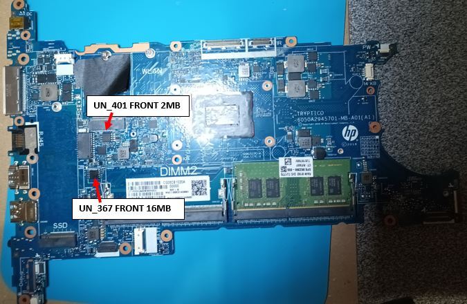

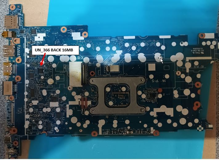

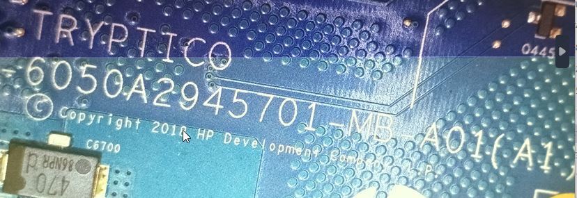

                    Hi everyone 2nd post in this forum, I had a Laptop HP mt44 Mobile Thin client with MB:TRYPTICO 6050A2945701-MB-A01 with a password protected bios. I replaced the original Winbond WQ128JVPQ (UN_366,and UN367) for the WQ128JVSQ bit bigger and easier to solder (with hot air), I read the ic's with a hex editor and edit them and program the eeproms, I checked it, I reassembled them and I find the PC in this damaged state no display and the yellow power led is flashing on the side where the powerplug is in the laptop I tried rewriting the original files back but nothing changes. The connections are OK, I used a ch341, I can't explain what happened. Hope some 1 can help me. The voltages on the IC are OK and no shorts.....
                    Model: HP mt44 Mobile Thin Client
                    Serial: 5CG9020CKW
                    MB type:TRYPTICO 6050A2945701-MB-A01
                    See fore more specs: image hp MT44 SPECS.jpg
                    from all ic's i made a backup before de(soldering) see attachments

                      if you wrote back the chips with the original bios, and it doesn't work, you must have read them with errors before..

                        I verified the buffer from what is in the bios chips and all are the same as in the bios chips (made several backups from each chip)

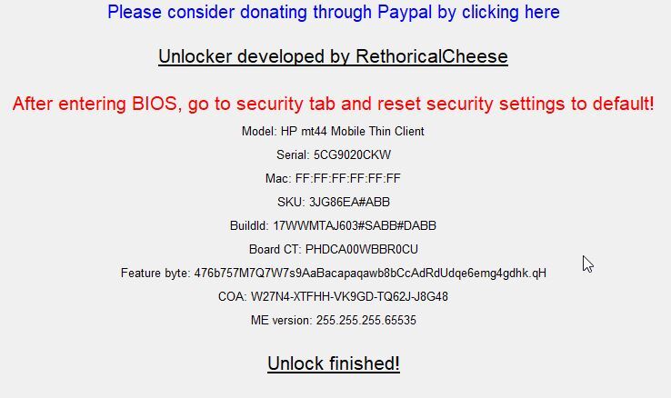

                          model : hp mt44
                          SN : 5CG92594ZZ
                          Prod id : 5JT04PA#AB4
                          Problem : bios password need to unlock

                          try this:

                            The bios you posted is from an 840 G6 with serial number 5CG02746NX .The serial you posted isn`t recognised at HP support .What model is the laptop ? , what is the mt44 , post the motherboard model number

                              Thank u So much . Password cleared

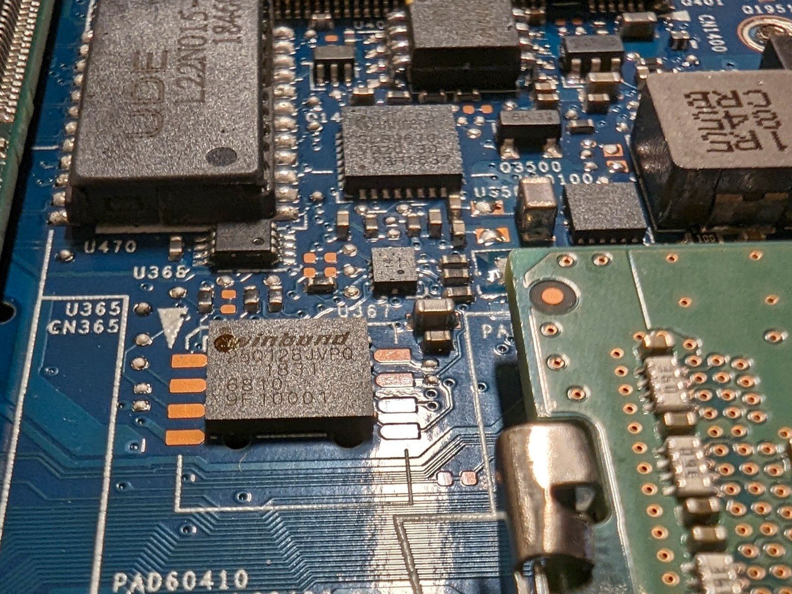

                                  I Think the problem is in the Winbond 25Q16JVSIQ bios chip becasuse all backups (4x) i made from this chip are a little different. Wrote all backups back in the chip, 4x no succes. is there a universal *.bin file 2048Kb (2MB) for this chip ?
                                  Serial: 5CG9020CKW
                                  Tried the universal *.bin file found on this website but no succes.....
                                  Some one knows how to get some live in his laptop.
                                  all messed up but first time i have this type of laptop
