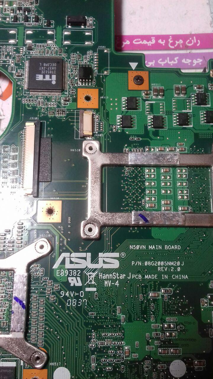

Asus n50v bios remove password
    Backup! THIS FILE HAVE BIOS PASSWORD

    Re: Asus n50v bios remove password
    Plz help
      • 21889
      You need to remove the pass by date code.Remove CMOS battery to reset the clock.Press alt+r at the ENTER PASSWORD screen to get date code .
        i tested it but no working for me
          • 21889
          Try with a QWERTY keyboard .What code does it show on screen
            I pressing alt+r at the ENTER PASSWORD screen but no action for me
              official bios not working
              dont have tested bios
                • 21889
                Try this bios . AAAA99BD
                  NOT WORKING
                    • 21889
                    Try this new one .
                        I confirm that this method not work on new models. I Have tried on my laptop ux430ua and "alt+r" not work. Anyone knows other shortkeys for the latest asus laptops?
                            Anybody have some update about not working ALT+R keys combination with new asus laptops ? I have UX433F and ALT+R do nothing .., Thanks
                              Make a bios backup using either some bios backup software or a programmer. Then I can try to tell you what is the password.
                                Thank You for reply , flash is in WSON package, I must desolder it and read in programmer.
                                  If you have Windows on it or can boot from usb, try some software to read bios region only. Not sure about this particular asus but usually it is possible to read or decrypt passwords on asus.
                                    OK, original dump with password , thank you for your time RethoricalCheese ..
                                      Sorry, but looks like with this model you still need to desolder, delete password, program and resolder. I am unable to decrypt this one.
                                        Thank you for your work, this dump is from desoldered flash and read via programmer. I think Asus have new one encryption method..
