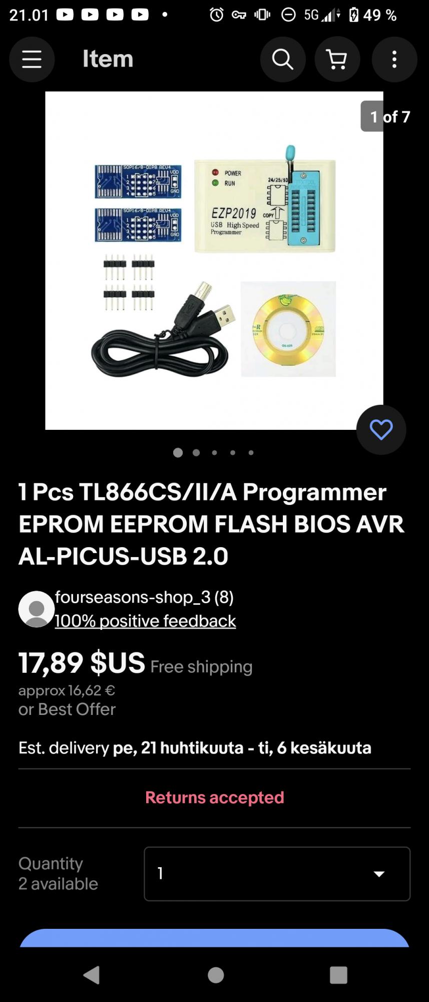

                            #153
                            Re: hp pavilion x360 bios bin need
                            Originally posted by Kiekko
                            Hi. Is this correct TL866CS/II/A Programmer for me? Picture included.
                            • lapfix
                              • Mar 2020
                              • 2756
                              • my workshop
                              #154
                              the picture it's not TL866CS/II , i will recommand RT809F
                              • Kiekko
                                • Aug 2022
                                • 31
                                • Finland

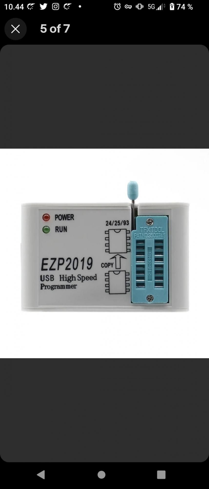

                                #155
                                If it isnt TL866 II, what is it?
                                Picture included.
                                And is RT809F better somehow than TL866 II?
                                  • 21672
                                  #156
                                  Picture included.
                                  EZP2019
                                  • Kiekko
                                    • Aug 2022
                                    • 31
                                    • Finland
