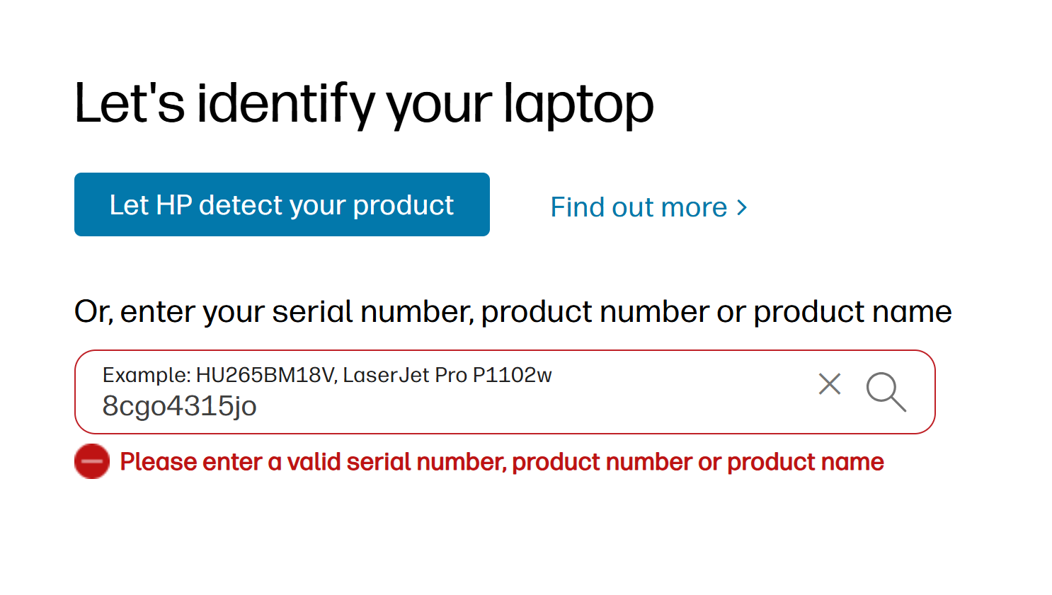

            can helpme whit bios, i have a original but i dont have sure if fine or corrupted, can helpme please?
            sn: 8cgo4315jo
            14-dh0025la
            3 ligths slow and 2 fast thats my problem
              sn: 8cgo4315jo
              14-dh0025la
              Check the serial number again.

                    sorry, its a 8CG04315J0
                              sn: 8CG04315J0
                              14-dh0025la
                              this post have a good serial
