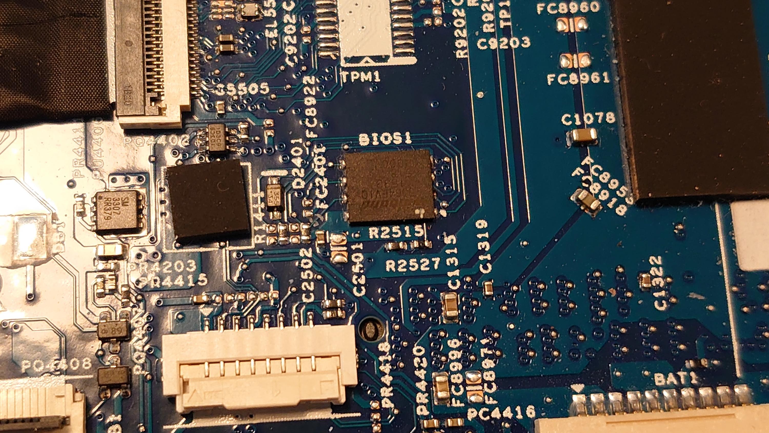

    There is a picture of the chip. Can you tell the model? WSON? Is this good wson adapter?
    https://www.ebay.com/itm/13414832288...mis&media=COPY
    Im so newbie, that I cannot desolder the chip.
    My chip is this. https://www.ebay.com/itm/17539198799...mis&media=COPY

      The chip is 6x5mm. I think.

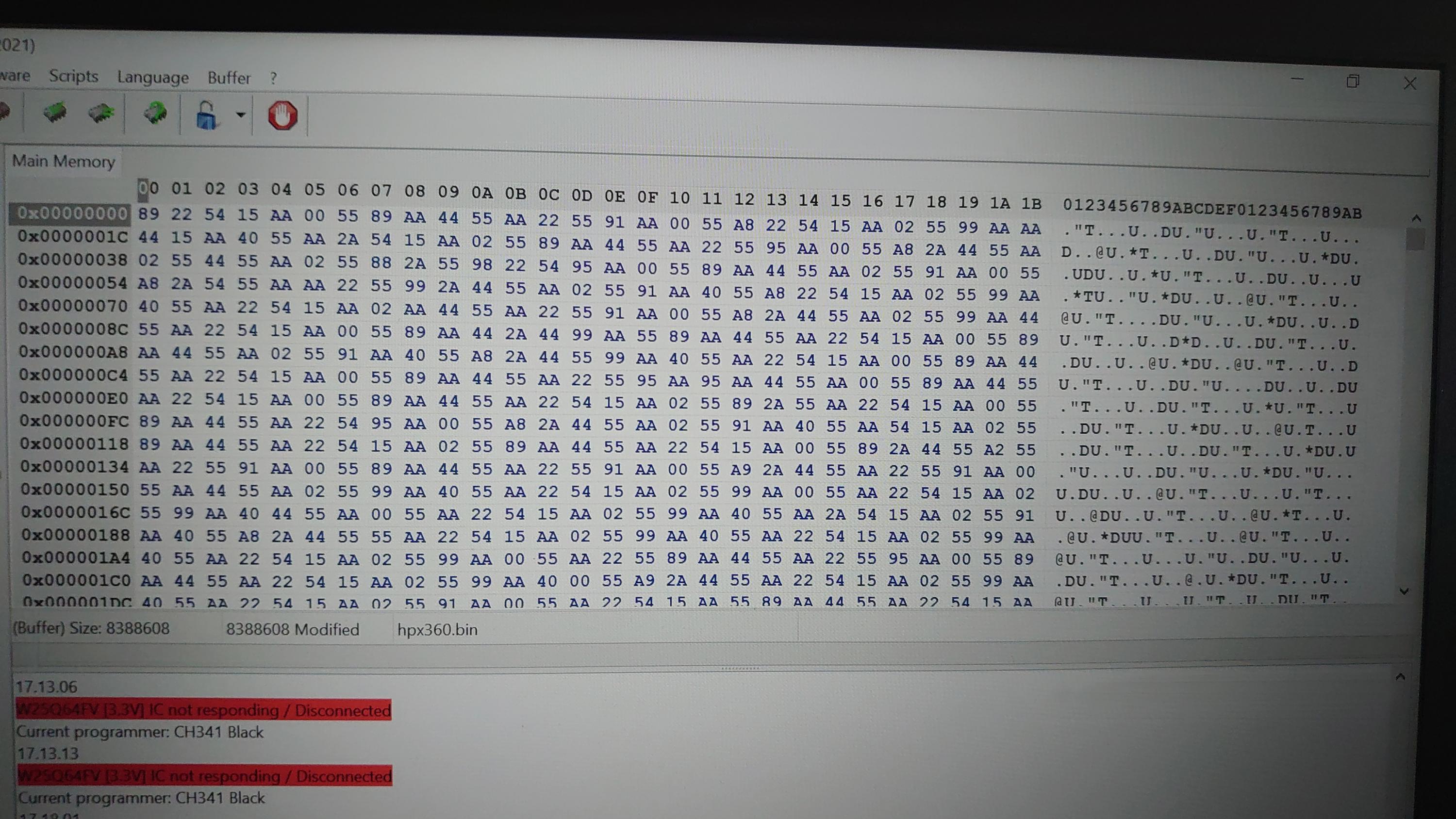

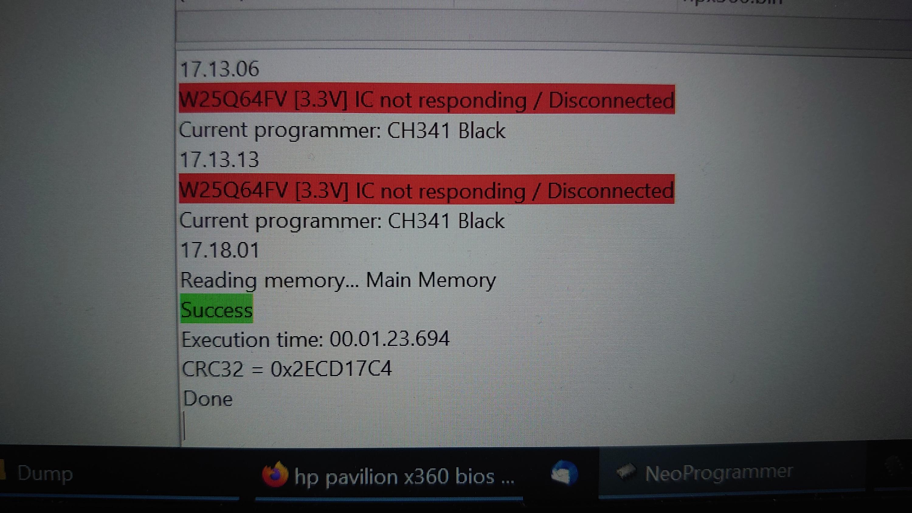

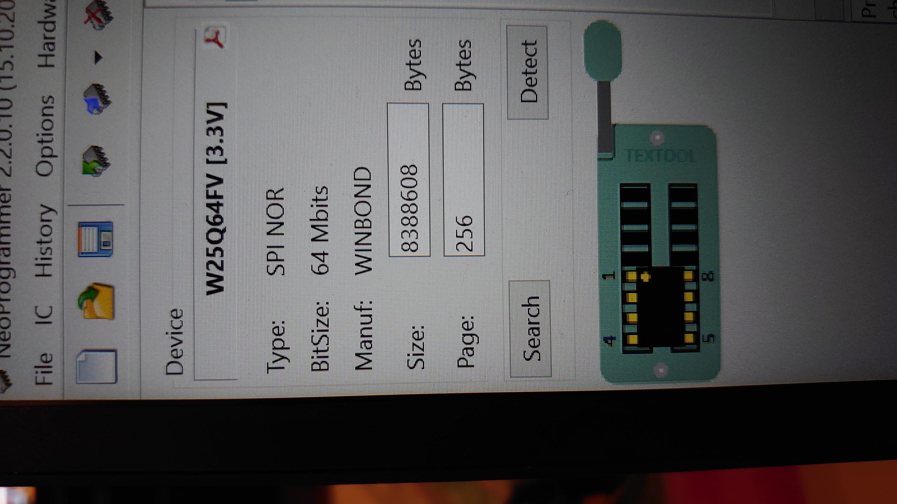

        Hello. Finally i got it. Read success with NeoProgrammer. Can someone help please?
          Not yet. One is that you have chosen the wrong chip, the other is that the programmer has read it unsuccessfully.

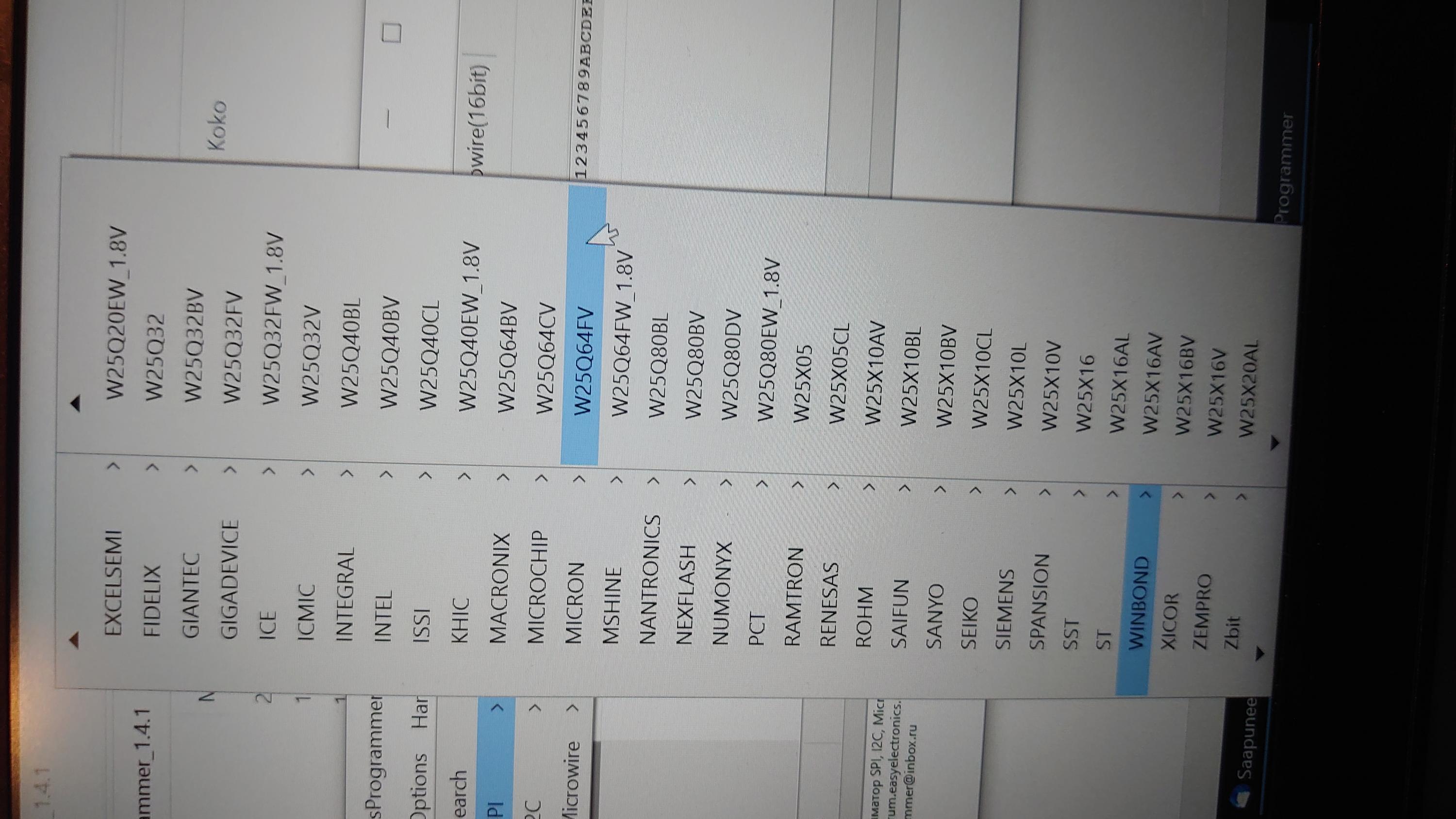

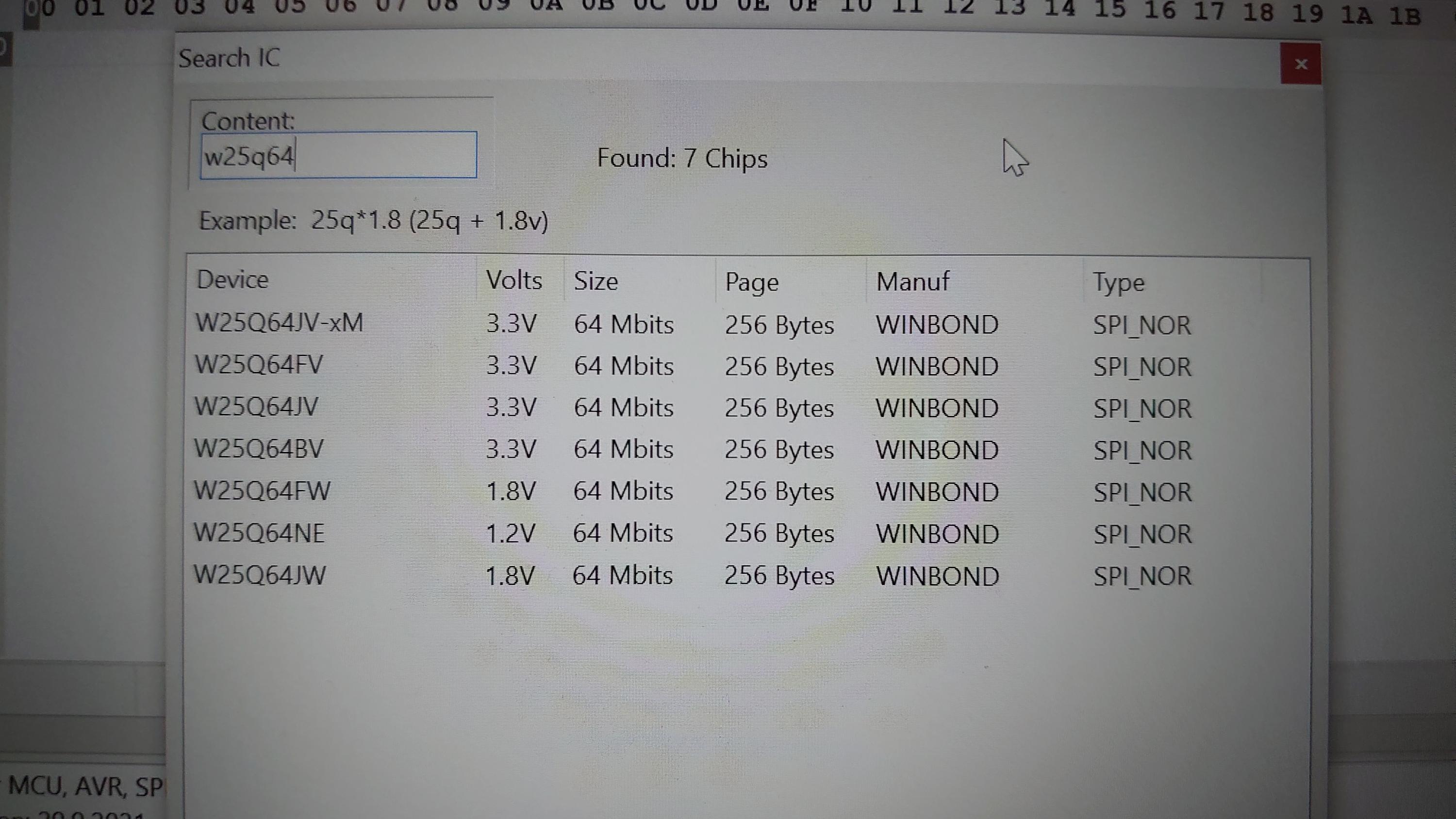

            Ok.. Here is pictures. Are you sure? I have chosen W25Q64FV
            My chip is:
            Winbond 25Q64FV10
            1533
            6518
            1R000
            It says read success. ??
              My chip is:
              Winbond 25Q64FV10
              Its corrupt.Try reading it again,but this time try the CH341A with a USB powered hub,or plug the charger in before reading the chip

                Is my chip however Winbond 25Q64FVIQ? I cannot find that from programmers.
                Or is that W25Q64FV correct?

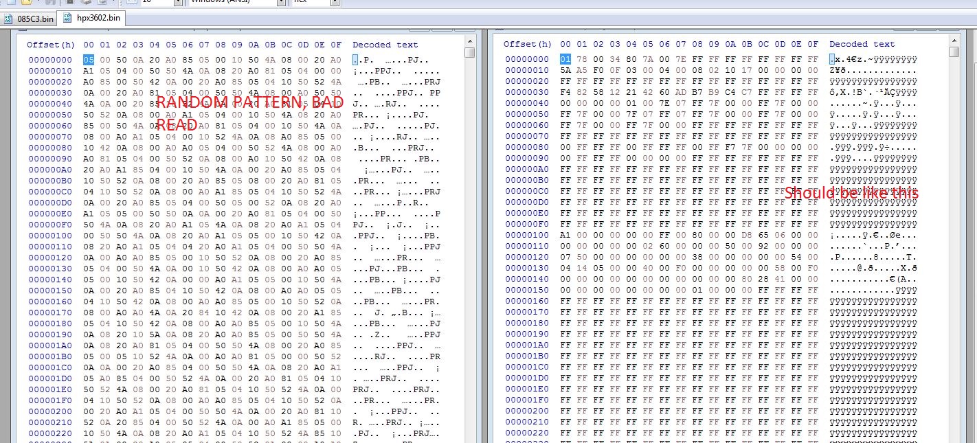

                  Here is new bin read from AsProgrammer. Working?

                    Its different to the other,but it still has a repeating pattern of crap. Something isn`t right.Check all the connections and make sure youve got all pins lined up correctly.did you oslder wires or use a pogo pin adapter.Did you modify the CH341A for 3V voltage

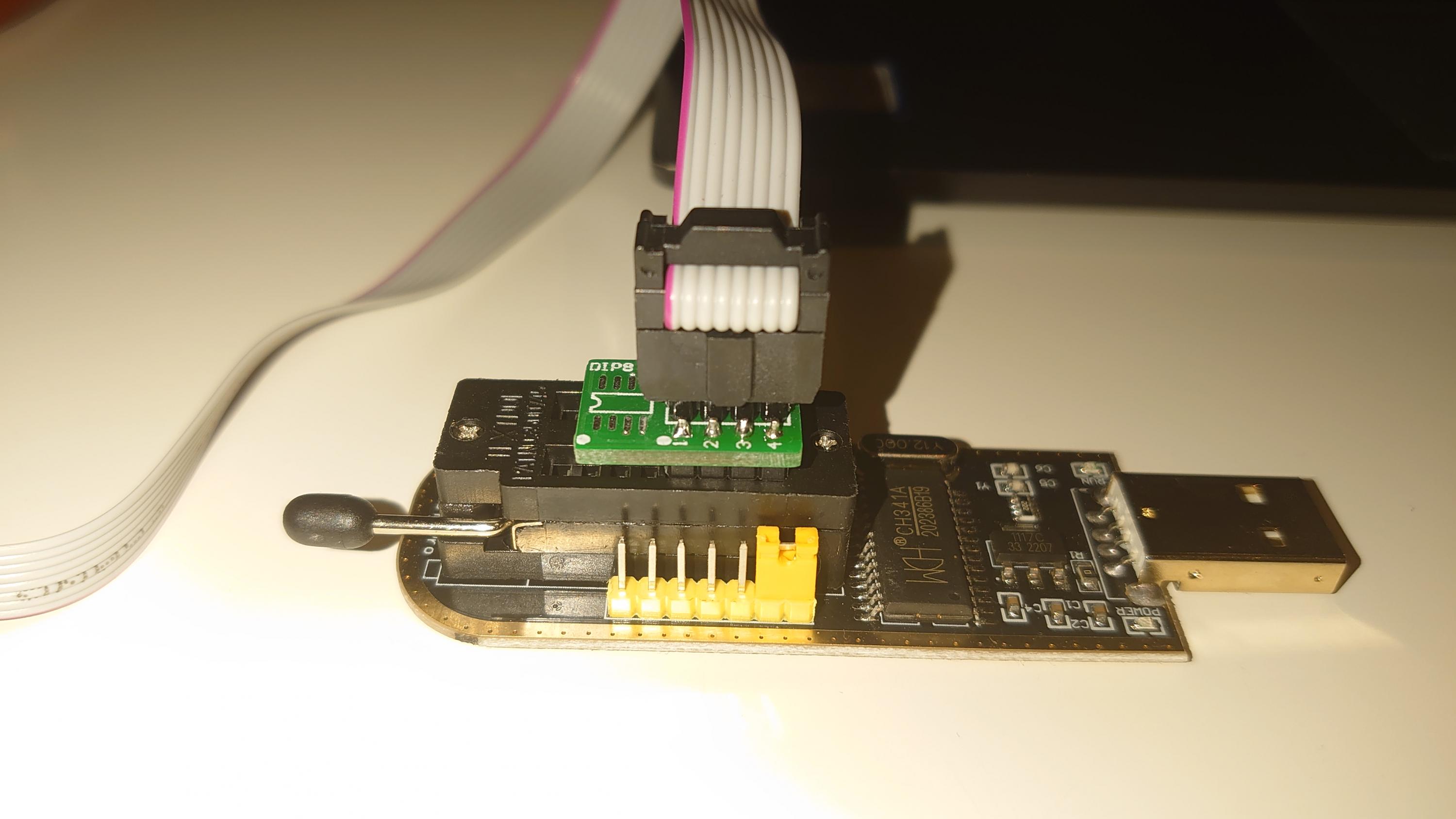

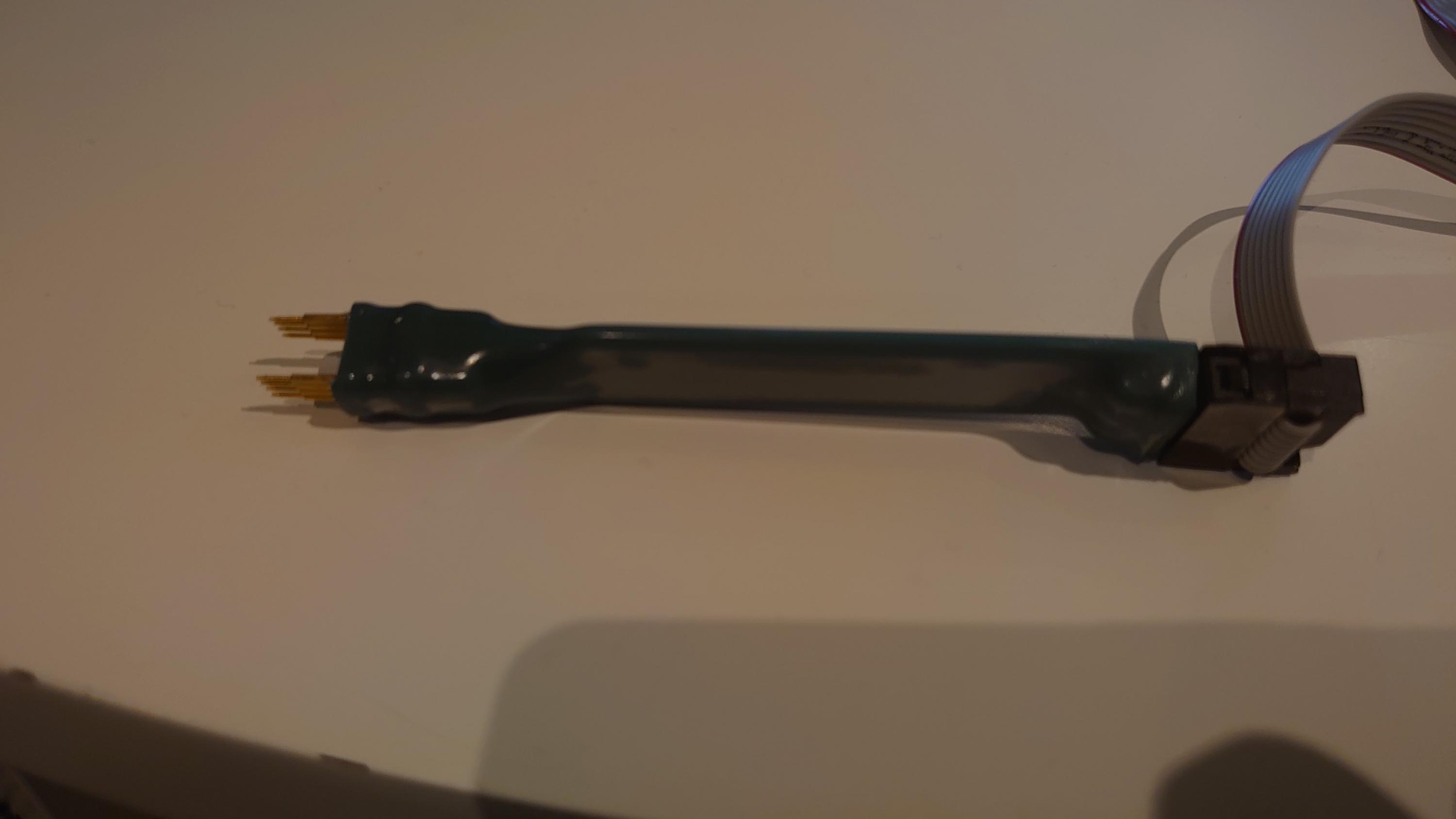

                      I did not solder wires. I use this adapter. I did not modify voltage.
                      Is adapter ok? What about voltage?

                        I am trying. What about these bins?

                          I am trying to figure out how to do this. Are my tools correct to read bios? I dont understand voltage at all. Do I have to do changes to CH341A tool? Or can I read bios not change to CH341A? How can I know the bios is read succesfully? I saw the picture above. Do I have to push the pogo pin adapter or not? I did push it. Are the last ones bins ok or not? Can someone take my hand and lead me to correct solution? Please.

                            None of the files are fine.

                              I really want to know what I am doing wrong. Can you know? I have taken pictures of my tools. How can I solve the reading problem?

                                    I find it very likely that you have to remove the chip from the motherboard and read it directly on your programmer.
                                      That is not possible. I can not remove the chip from the motherboard. So let's try to solve the problem other way. Thank you. I am so newbie, so i am listening you what I have to do.
                                        https://www.badcaps.net/forum/showpo...40&postcount=2
                                        1.1.1.6. CH341A
                                        Read the guide there: https://winraid.level1techs.com/t/gu...rammer/32948/3
                                        If you have a black PCB, it is very likely that it needs to be modified for 3V operation instead of 5V. Failing to do so could damage the ROM IC.
                                        Watch the instructions there:
                                        https://www.youtube.com/watch?v=-ln3VIZKKaE
                                        https://www.youtube.com/watch?v=HwnzzF645hA
                                        Some other suggestions.
                                        Try using a powered USB hub.
                                        Choose the bios chip manually from the list,don`t use auto-detect.
                                        If you have a PC install the CH341A on it and use the PC`s rear USB ports.
                                        Try in USB 3 ports.
                                        If you have a soldering iron do the 3V mod,and resolder all the pins on the CH341A ,the build quality on some is terrible.
                                        Buy a better programmer,such as a TL866II
