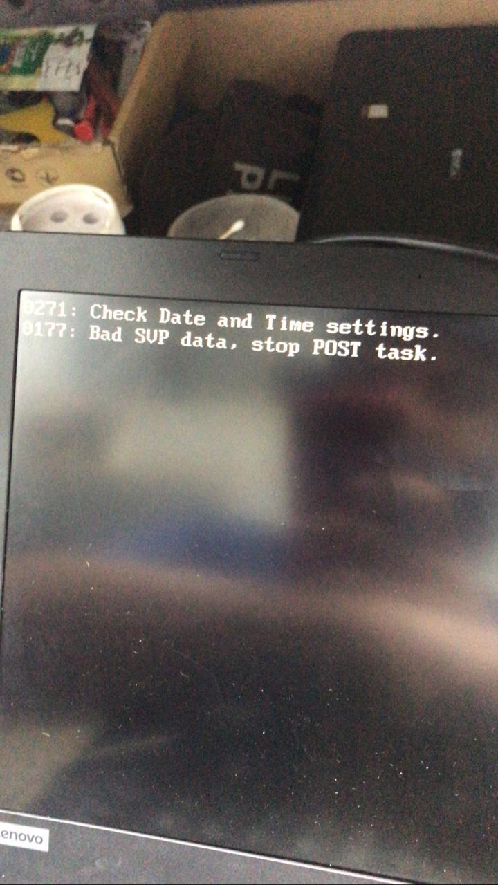

          • HAMZA123
            • Aug 2023
            • 3
            • United Arab Emirates
            Click image for larger version  Name:	55004509-ed19-4e4d-88ab-5d85b4fc7189.jpg Views:	0 Size:	111.2 KB ID:	3259693L580 GIVING THAT EROR I PUT NEW BIOS BOTH BUT STILL COMING ERROR
            • Maxpower3
              Bad Veteran
              • Feb 2018
              • 1317
              • France
              EC Data corrupt.
              What is the history of the PC.

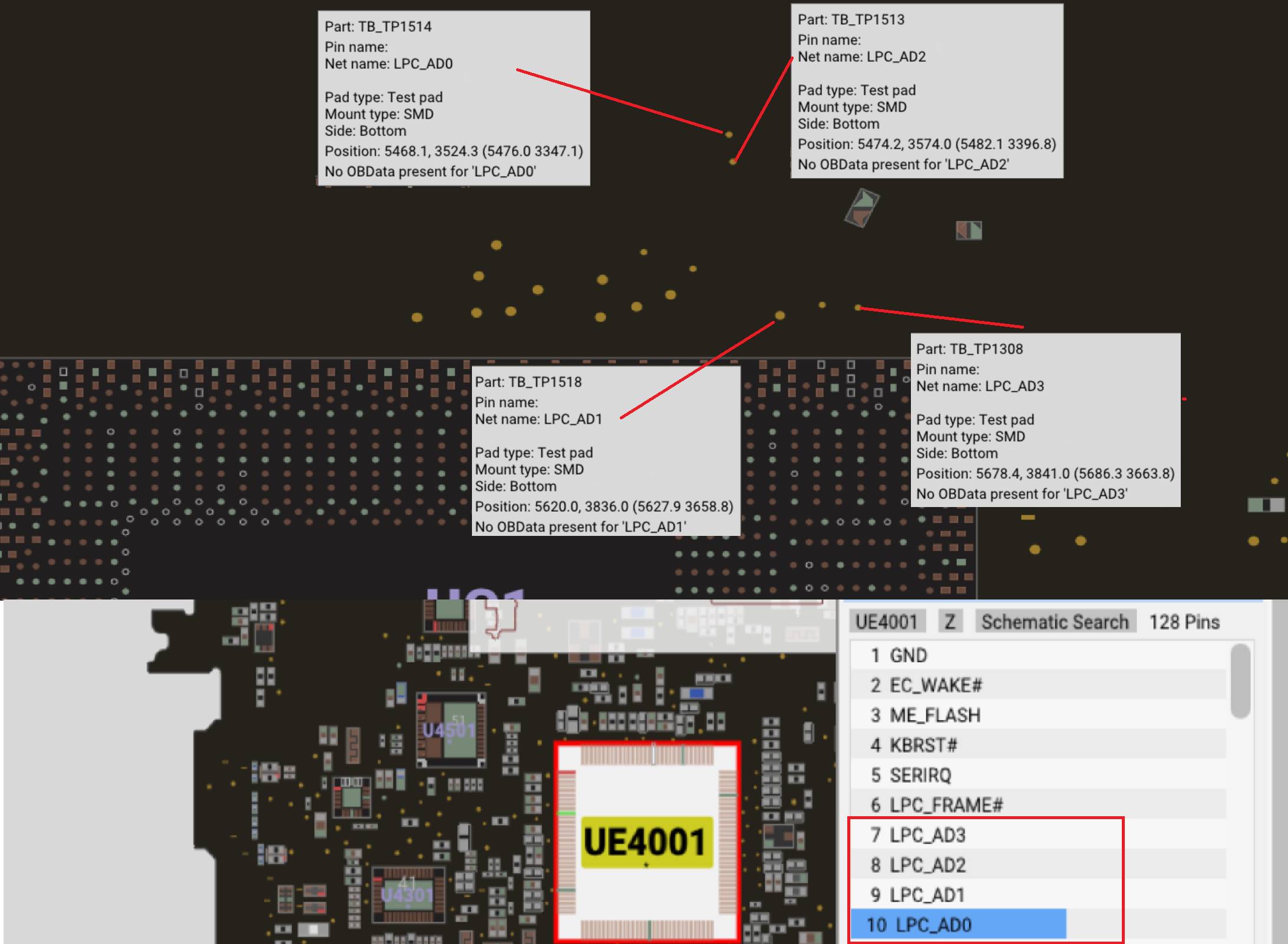

                                  • Maxpower3
                                    Bad Veteran
                                    • Feb 2018
                                    • 1317
                                    • France
                                    #37
                                    Originally posted by theBread
                                    Hey
                                    I've got an L580 with locked BIOS - as far I've seen in the EC bypass thread the password is not stored in the EC itself
Name:	Nouveau Image bitmap (3).png

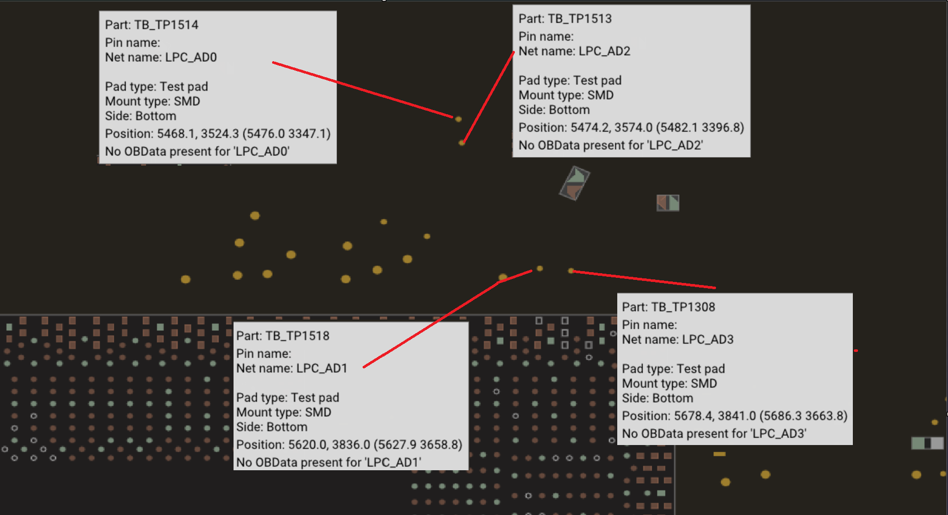

                                      • Maxpower3
                                        Bad Veteran
                                        • Feb 2018
                                        • 1317
                                        • France
                                        #39
                                        Ah well ok, my bad, didn't catch that part. Will try the bypass, thank you for pointing it out ^^'
                                        Be careful, there are always risks with bypass. Understand and read the different situation threads carefully.
                                        edit : mistake on lpc AD1
                                        Click image for larger version  Name:	image.png Views:	0 Size:	358.3 KB ID:	3638027
                                        • theBread
                                          • Apr 2022
                                          • 16
                                          #40
                                          Success with LPC_AD2 - thank you very much! It seems that different pins have different symptoms when the timing is bad. Also, it seems to be a "good" sign if most of the machine metadata (like board UI, SVP etc.) is corrupted during the procedure - it announced to cancel the POST task, but I could type F1 and get to the BIOS anyway (just don't save the BIOS in that state!). It also may happen that you partially success and get access to a "harmless" part of the BIOS with less settings, but that's not the interesting part
                                          Sorry for dumping the whole process, I know you described everything necessary in your post, but I wanted to document and share how it worked for me ^^'
