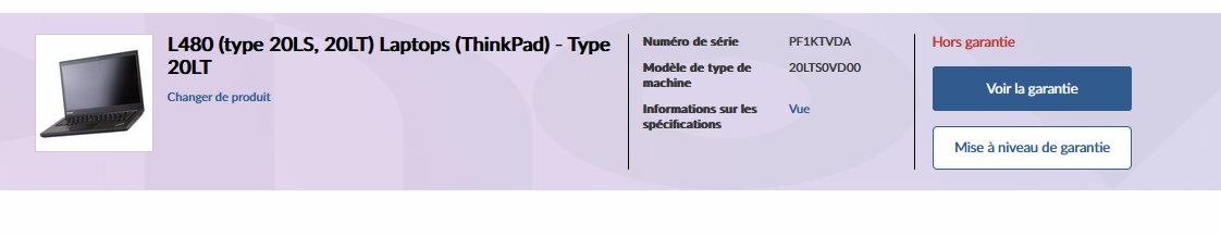

      Good morning, I have a Lenovo nm-b461 board, I changed the power integrated, it gives video, but when I type the keys it marks them double, they tell me to program the power, but the power is on an IT8996E-256 and the files I find are for a 128, can you help me please, thank you
      Sorry, I don't have the serial number, it's erased.
      • Maxpower3
        Bad Veteran
        • Feb 2018
        • 1317
        • France
        #43
        SER#
        8SB20Q10967L1HF919020P
        1S20LTS0VD00PF1KTVDA
        Type 20LT
        SN PF1KTVDA
        Click image for larger version  Name:	image.png Views:	0 Size:	80.2 KB ID:	3673227

          SER#
          Type 20LT
          SN PF1KTVDA
          Thanks, do you happen to have the EC programming?
          • Maxpower3
            Bad Veteran
            • Feb 2018
            • 1317
            • France
            #45
            Look above, I edited the post. I don't know the original version. You know

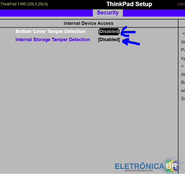

                    #49
                    Hi. Please help me. My bios has a tamper detection error on the bottom cover
                    Type: 20LW
                    SN: PF-0Y2MY6
                    • Maxpower3
                      Bad Veteran
                      • Feb 2018
                      • 1317
                      • France
                      #50
                      Type: 20LW
                      SN: PF-0Y2MY6
                      Check the sensor with a multimeter or shunt it.
                      It is possible to disable it in the BIOS.
