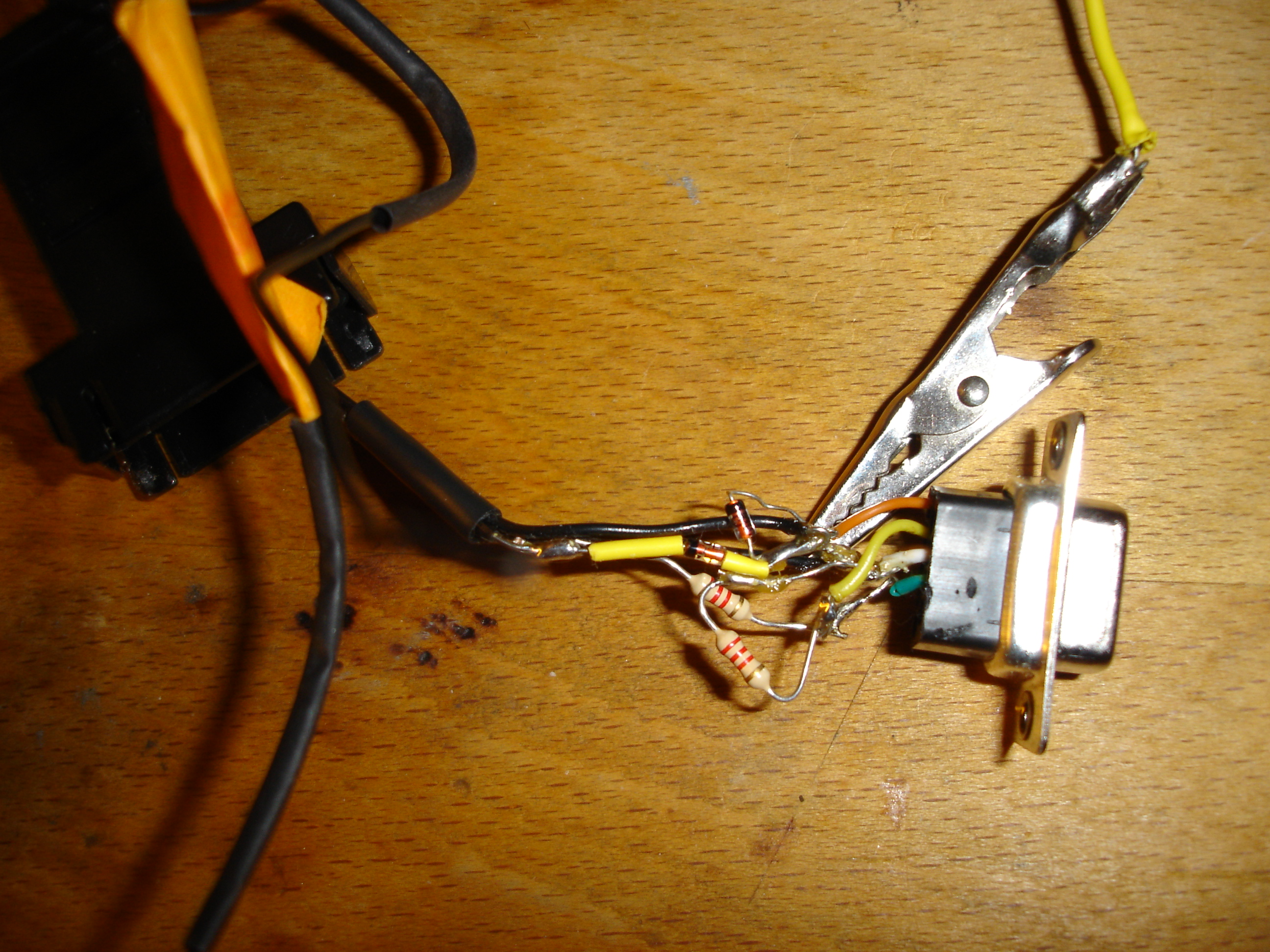

                  No you don`t need a KMX. With the 24RF08 or equivalent chip on some thinkpads you just need to short pin 5 and 6 together at the right time while booting up to remove the password. The R52 definitely uses the PC8394T ,and you can use any TTL device to read the chip ,using the scl,sda points. I made a
                  simple-i2cprog years ago, its easy to make.If the RT908F can read ttl try it.
                  To read the chip use R24RF08 reader and decode the password with IBMPass, if R24RF08 reader doesn`t work try the pc8394 tools
