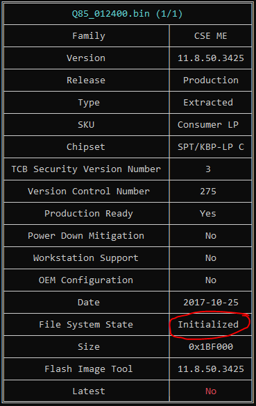

                            Can someone check if my bios is ok?
                            my laptop turns on. but takes more then one minute from on to hp logo with max fan,
                            tryd some bios from here, and got the same thing.
                            when the laptop finally booted up, it works fine, its only the boot that takes very very long time
                            backup of it is attached
                              • 21969
                              #274

                              Have you tried cleaning the ME firmware ? -> https://www.badcaps.net/forum/showpo...41&postcount=3
                                yes i cleaned the backup to try, if it helps, but it results with the same more then1 minute delay

                                  Here is ME cleared.

                                    Re: pls Bios HP Probook 450 G5
                                    Originally posted by DanielDacko
                                    Here is ME cleared.
                                    thanks, but same issue, more then 1 minute delay
