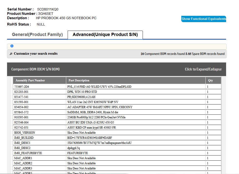

                      Thanks it is all good, but where can i find some info like Feature byte, System board CT number, etc... ?

                        #111
                        Re: pls Bios HP Probook 450 G5
                        Given on the sticker
                        Or check on YouTube there is tons of video available

                              Thanks but can not find CT number no more sticker on pc...
                                Check inside the battery compartment, and enter your serial here to get some more info such as Feature Byte - https://partsurfer.hp.com/Search.aspx

                                  #116
                                  Thanks SMDFlea, peste,qayyum786 CT number was the only missing one and this number was on the battery !

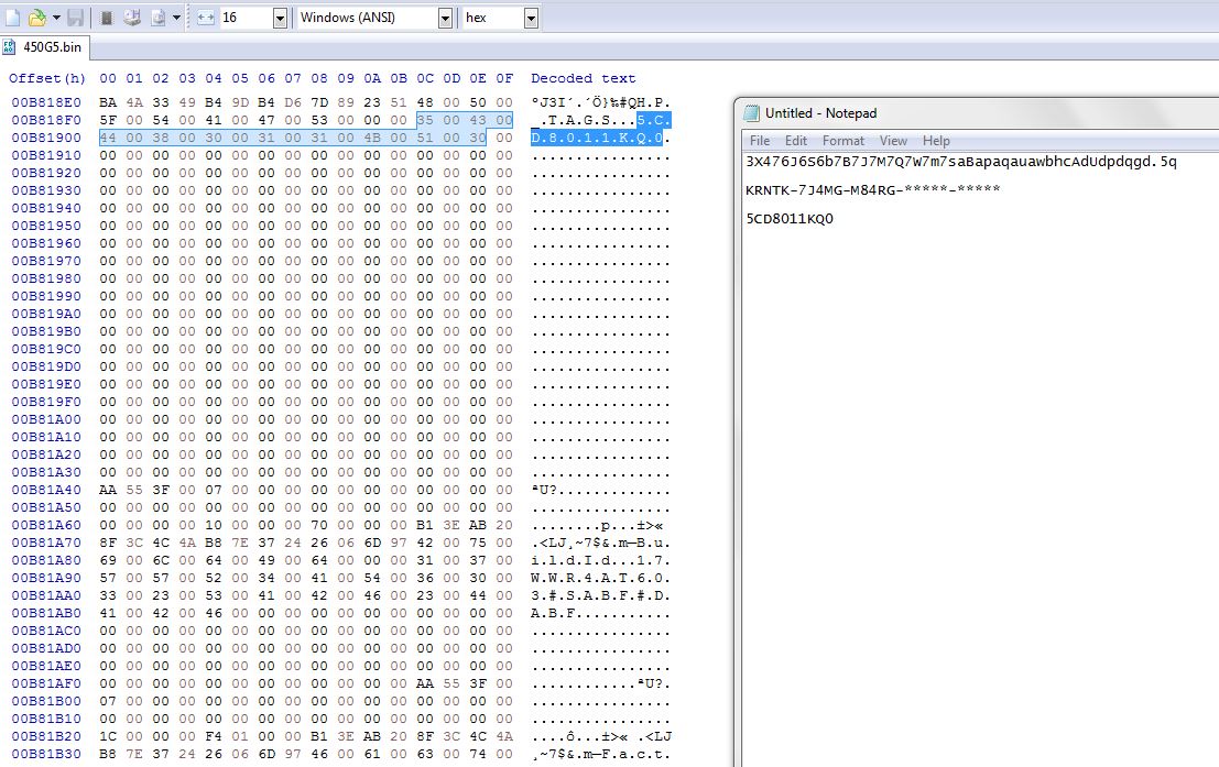

                                    • 21968
                                    #117
                                    You can find all the info in the bios using a hex editor,including the windows key. Text searches have to be in Unicode for the serial etc, apart from the win key which is in normal encoding,you can find that by scrolling down from the area where the serial is.

                                      #118
                                      Thanks for these infos
