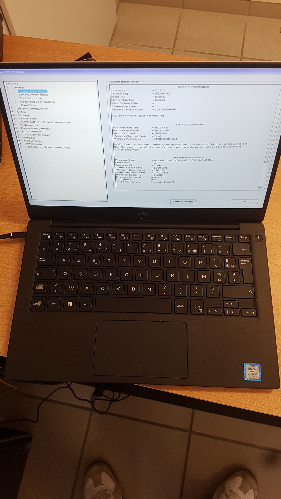

                          Hello, I have received this model LA-D841P Rev 3.0 with an i7 processor Service tag: 87G3GH2 and when it starts it takes about 30 seconds to display an image. I attach the bios, I don't know if it is your original or if they have manipulated it elsewhere.

                            Re: XPS 13 9360 LA-D841P Rev 3.0 (A02) bios need
                            Here's your new bios file, try it and give me results.
                            Service Tag: 87G3GH2.
                            all donations are welcome,
                            • oualid
                              • Aug 2016
                              • 49
                              • españa
                              Hello, thanks for your answer, I just tried it and it takes more than 30 seconds to show the image and then the fans are running very loud all the time
                              • hardware1
                                • Sep 2021
                                • 2943
                                • N/A
                                In the first boot it can take more than 30sec, but after that if you shutdown the device then start it again what will happen?
                                • oualid
                                  • Aug 2016
                                  • 49
                                  • españa
                                  the same, apart from that the mouse movements are very slow and the keyboard is also slow to respond
                                  • hardware1
                                    • Sep 2021
                                    • 2943
                                    • N/A
                                    Are you using a genuine charger, because sometimes in dell devices if the charger is fake it could affect on touchpad and more.
                                    • oualid
                                      • Aug 2016
                                      • 49
                                      • españa
                                      the charger is original
                                      • hardware1
                                        • Sep 2021
                                        • 2943
                                        • N/A
                                        Ok, try this one.
