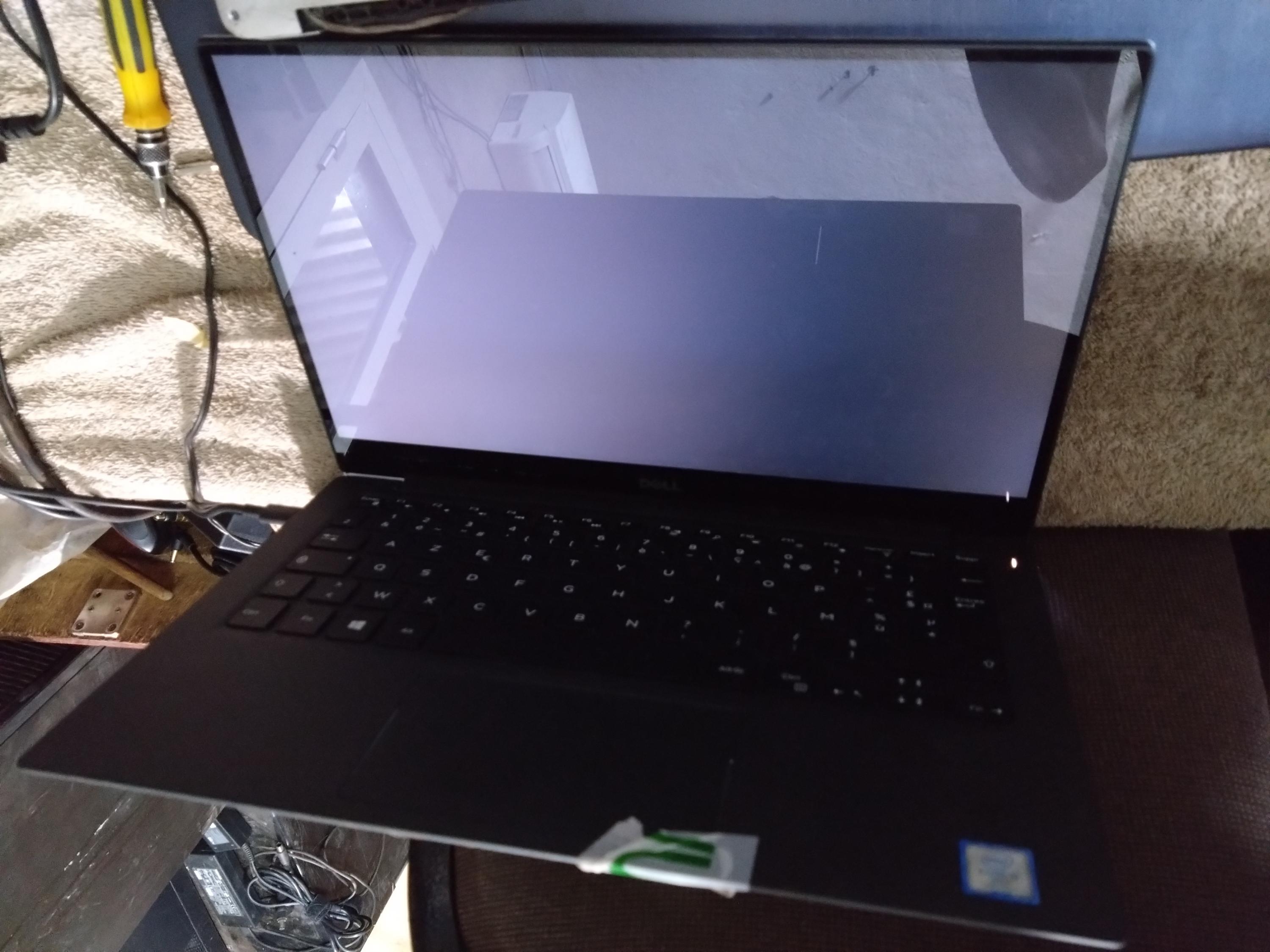

          Re: XPS 13 9360 LA-D841P Rev 3.0 (A02) bios need
          Originally posted by qayyum786
          Service Tag: 3S2M0N2
          FLASH BIOS AND FEW MNT AND LET IT RESTART SEVERAL TIME
          thank you for the bin but the led on the screen is on but there is no writing on the screen or dell logo. Can you give me another bin?
          here is a picture of what he does
            You Flash smdflea file and my file with same results
            Chk First on external Display or on keyboard caps Lock button if you can see any see any symptoms there

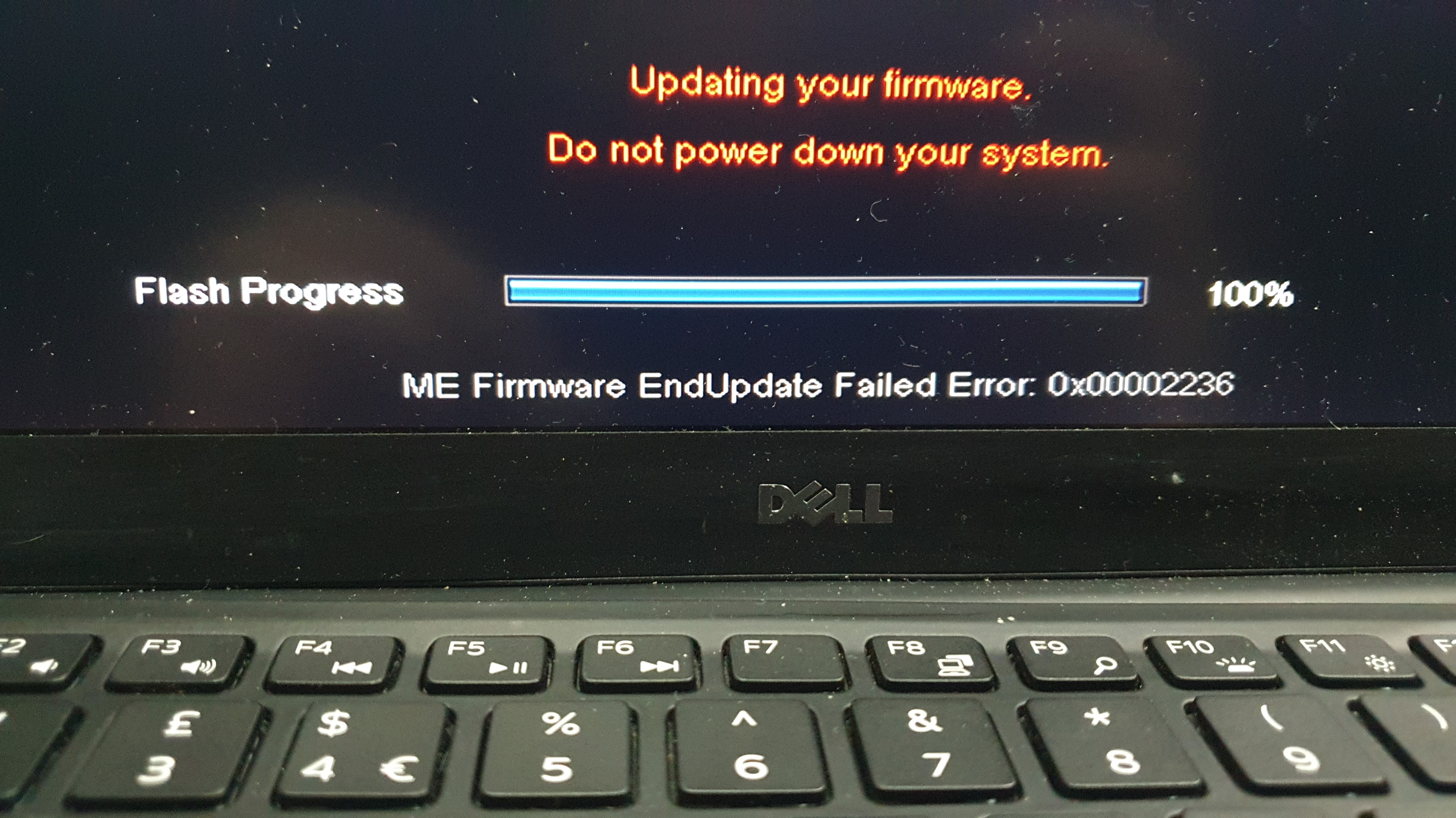

                                    I am having an issue with my xps 9360, where the BIOS updates fine, but then freezes as it tries to update the ME region.. it just gets permanently stuck (attached).
                                    I think because of this, I keep getting this annoying popup whenever I start the laptop about an issue with my thunderbolt dock or something (even when there is nothing connected to the laptop).
                                    Anyway, I would like to try to flash the ME region manually using my programmer, but I do not know much about laptop motherboards, and was wondering if someone could help me.
                                    Firstly, is the ME region a part of the BIOS, or is it on a separate chip? If so, which chip? I have found three possible candidates, UT5 and UT6 (which are both WSON8 6x5) and U18 (WSON 8x6, what I am used to on PC).
                                    I am attaching the Boardview I am using for this so you can have a look for yourself.
                                    Usually I would assume it is U18, but I have seen some BIOS and ME files on this forum, and they seem to be two separate things, hence why I am not sure.
                                    Thanks in advance.
