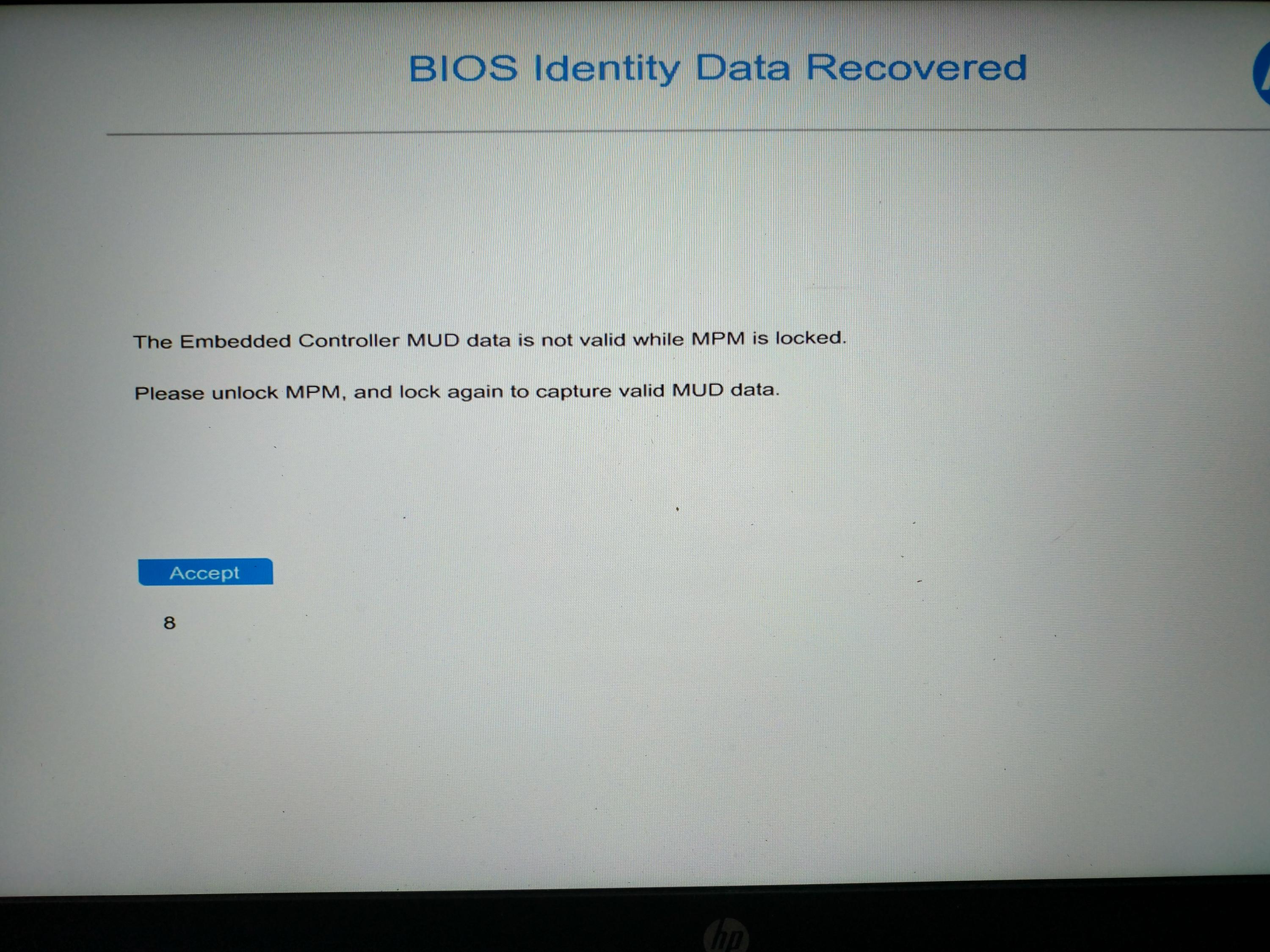

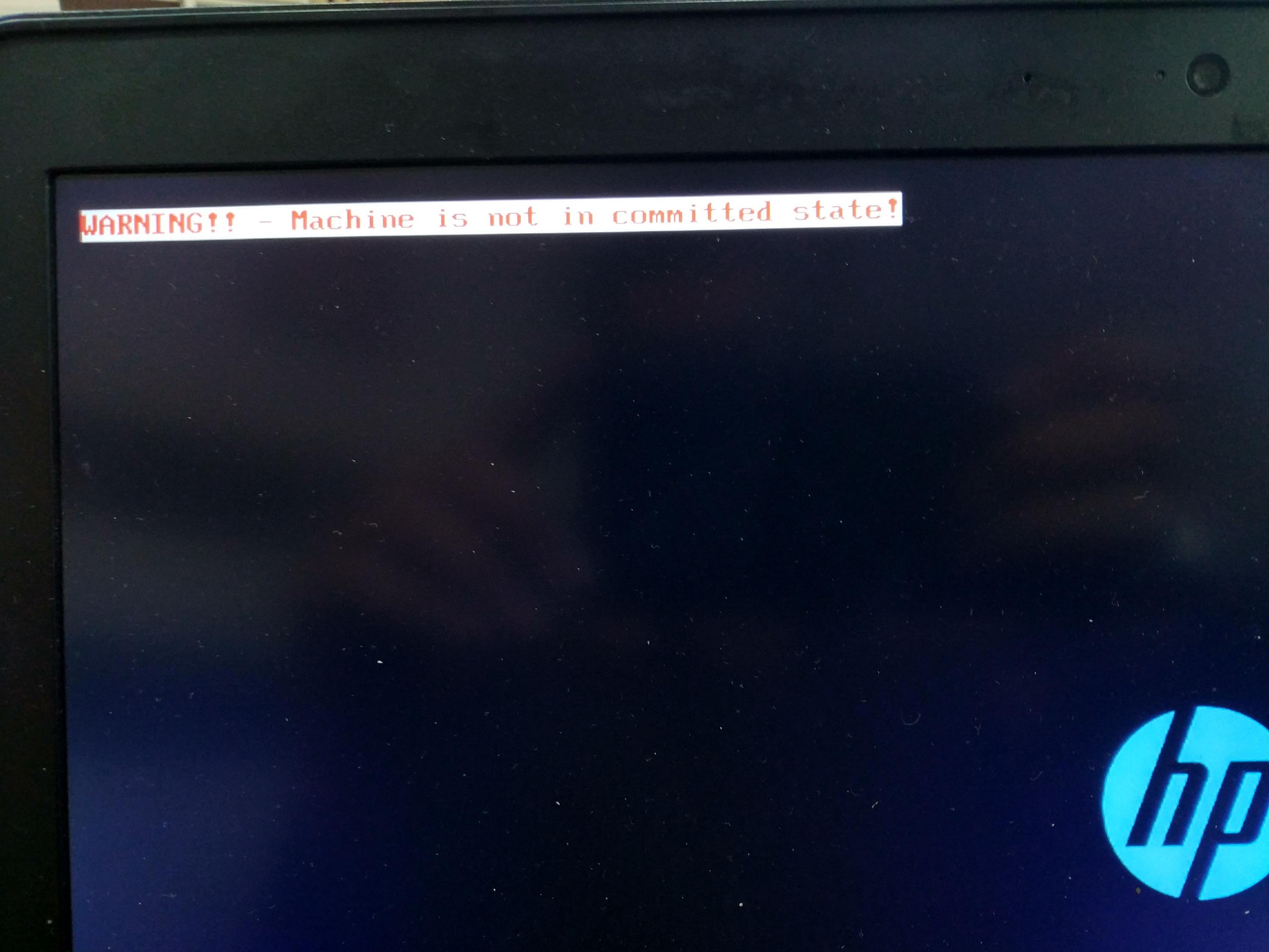

    Hi Dear
    I had bios by password and when I program new bios zbook 15 I have 2 problem
    1-delay boot bios
    2- error when bios boot up
    I attach old bios by password and error picture
    tanks for help me

    Re: my zbook 15 bios problem
    Machine not in commited state is an AMT error . Read post #164 for probable fix :
      https://www.badcaps.net/forum/showth...id=8&styleid=7
      Tank u for help me
      For next error "mpm is lock" are there any solution ?
        • 21692
        Unlock mpm with this tool .
          thanks for your helping
