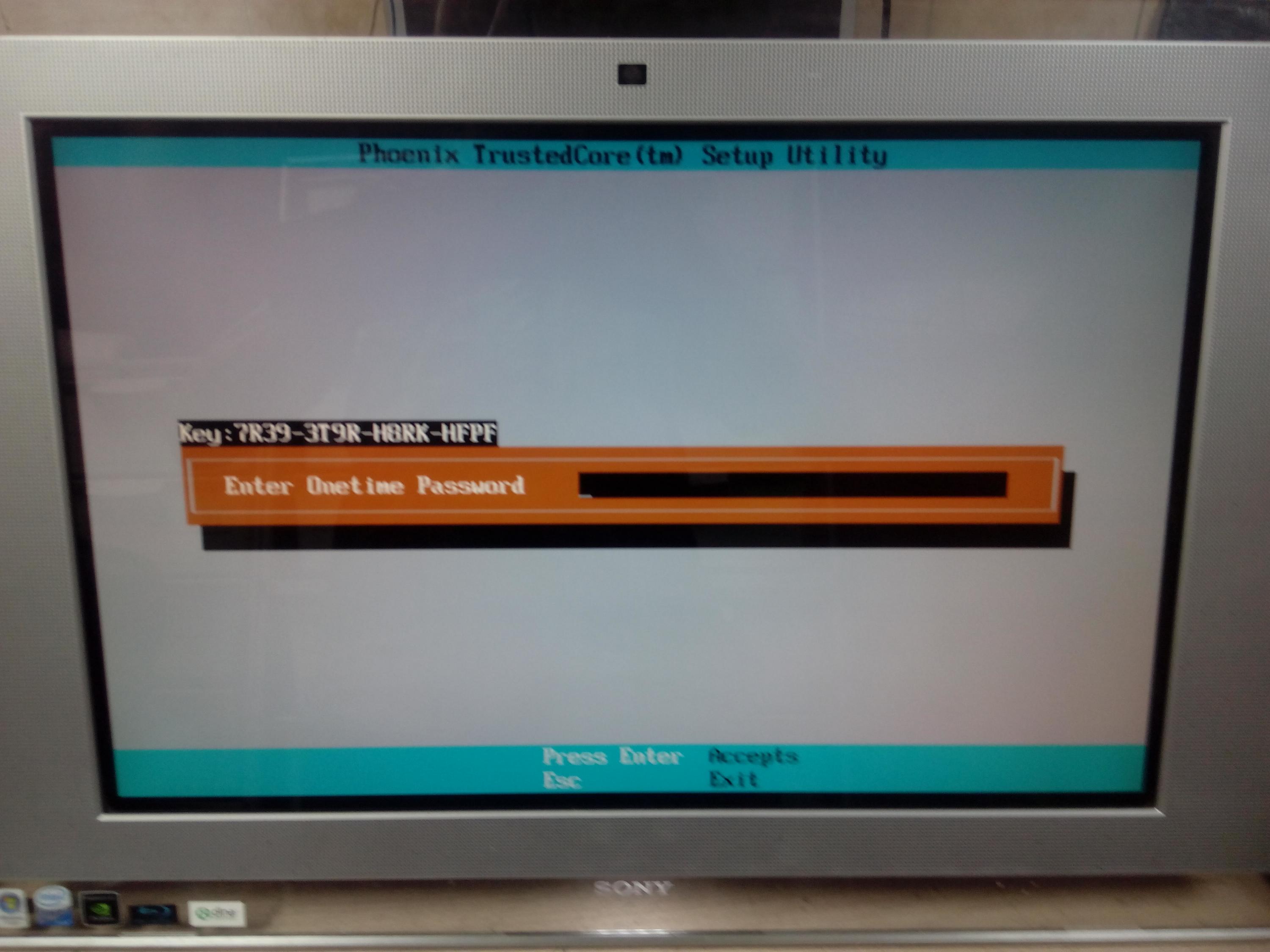

    Hello!
    May be anyone have bios dump for this model.
    In my bios set bios password. I can't reset it.
    May be anyone can edit dump, my dump attached.

      This PC not work with it generator. Other type of password.
      After 3 times of wrong password system write Key like ****-****-****-****.

        Re: Vgc-lm1er (mbx-179) bios password
        look here, sony 4x4 hex digits https://dogber1.blogspot.com/2009/05...ered-bios.html
        install python 2.6 from here if you want to use the python script,otherwise use the win binary. https://filehippo.com/download_python/4744/

          Sorry for long answer... Too much work.
          This method now work too. Password generated look like form a site.
          May be anyone have dump for it?
          In attached file photo from bios
            The password is 84424337 .Thats a one-time password, it will be different next time.
