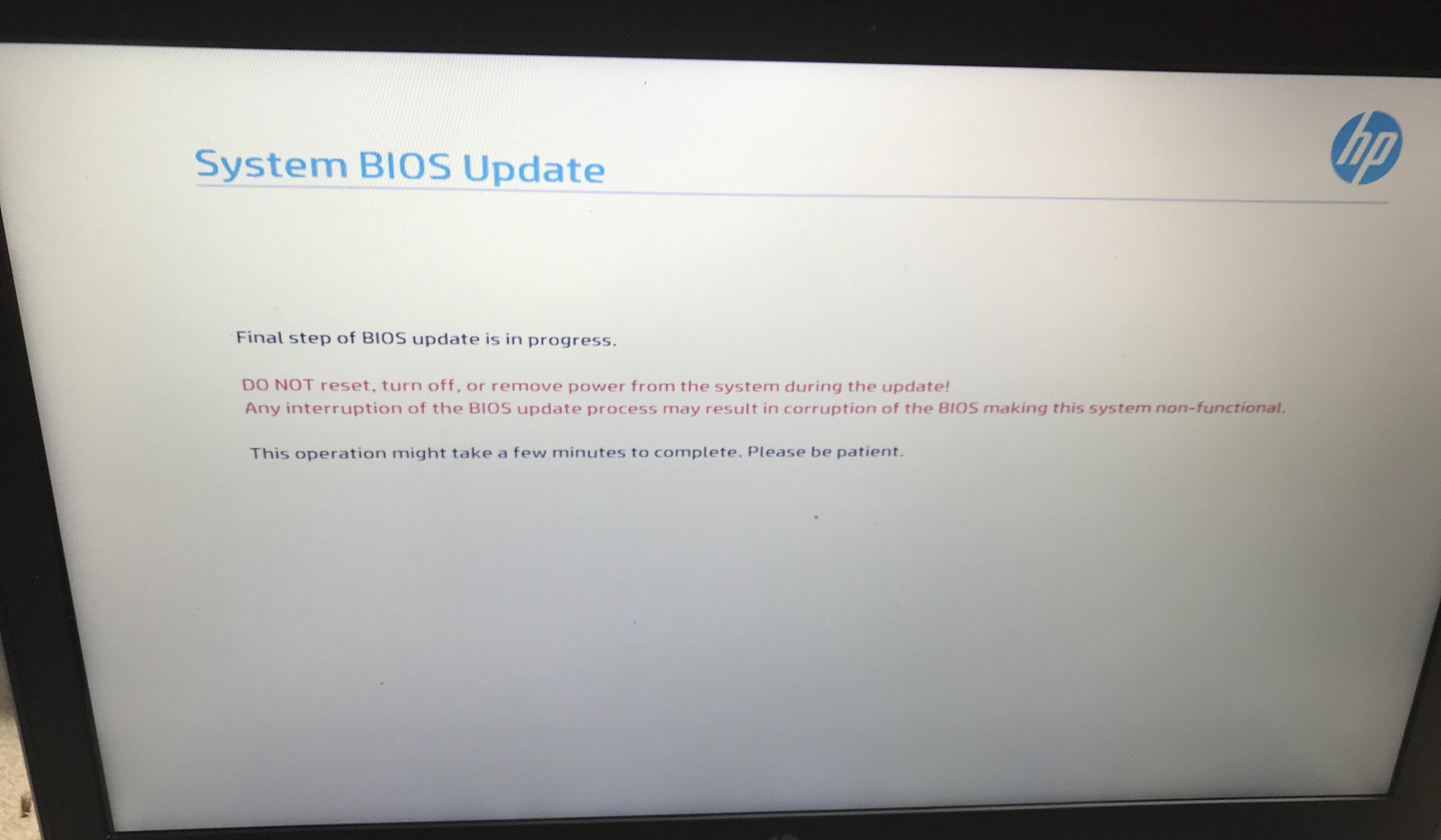

                    Hello guys,
                    Can anyone help me or suggest me anything? thanks in advance.
                    I have unlocked HP's in the past using the unlock tool.
                    But this time am stuck with an HP EliteBook 850 G3.
                    This model have two windbond chips. one is 8MB and the other one is 16MB.
                    I dumped the 16MB, then used the unlock tool and tried, but did not worked! still asking for admin password when entering into the bios!
                    Is there something with the other chip? I mean, the 8MB chip?
                    Also, how does the Branding works? ..How and when to use the NbDmiFit tool?
                    Please help me guys, I have tried all the HP EliteBook 850 G3 bios bin from all badcaps users but none of them worked for me. please help me. thanks.
                    Here is my origianl file:

                      #50
                      Re: Bios password remove 850 G3 HP
                      Originally posted by 5chematic
                      Hello guys,
                      try ..if it works enter the DMI information

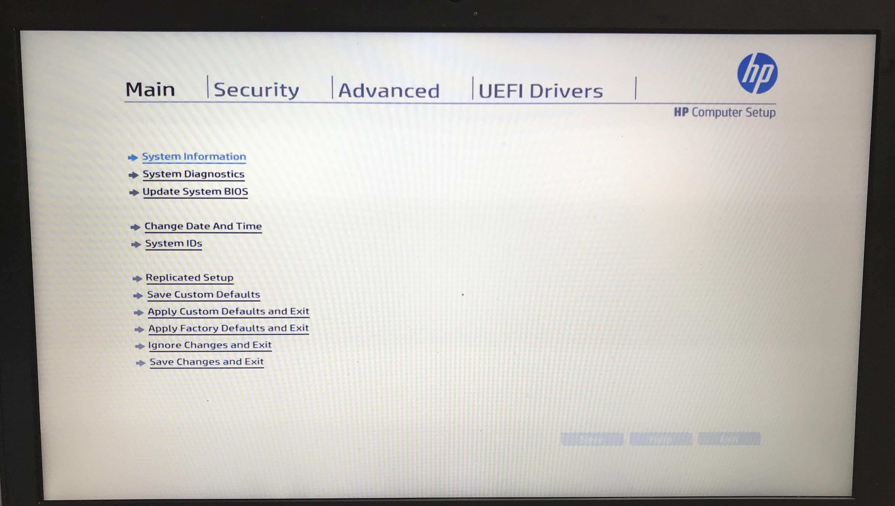

                          Hey! Thank You! So Much Peste!!!
                          So far I'm not sure if everything is okay... At first I was a bit of scare as when I first turned on...
                          It took a while to turn on... I was about to give up as it was acting as all the other trieds that the screen goes black and stays like that.
                          But then I was crossing my fingers saying: come one, please come on... and then the following screen came on, let me post a picture so you can see:
                          Peste, can I ask you please how you did it? ..if I used the unlock tool with no spaces and so on. how come it did not worked with me?
                          And Peste, how do I go with what you told me? I mean this:
                          "if it works enter the DMI information"
                          Thank you again Peste.

                              #54
                              Thank you Peste, it did work, thanks. but I tried to use the same bin with another one and no screen display and a flasing copslock.
