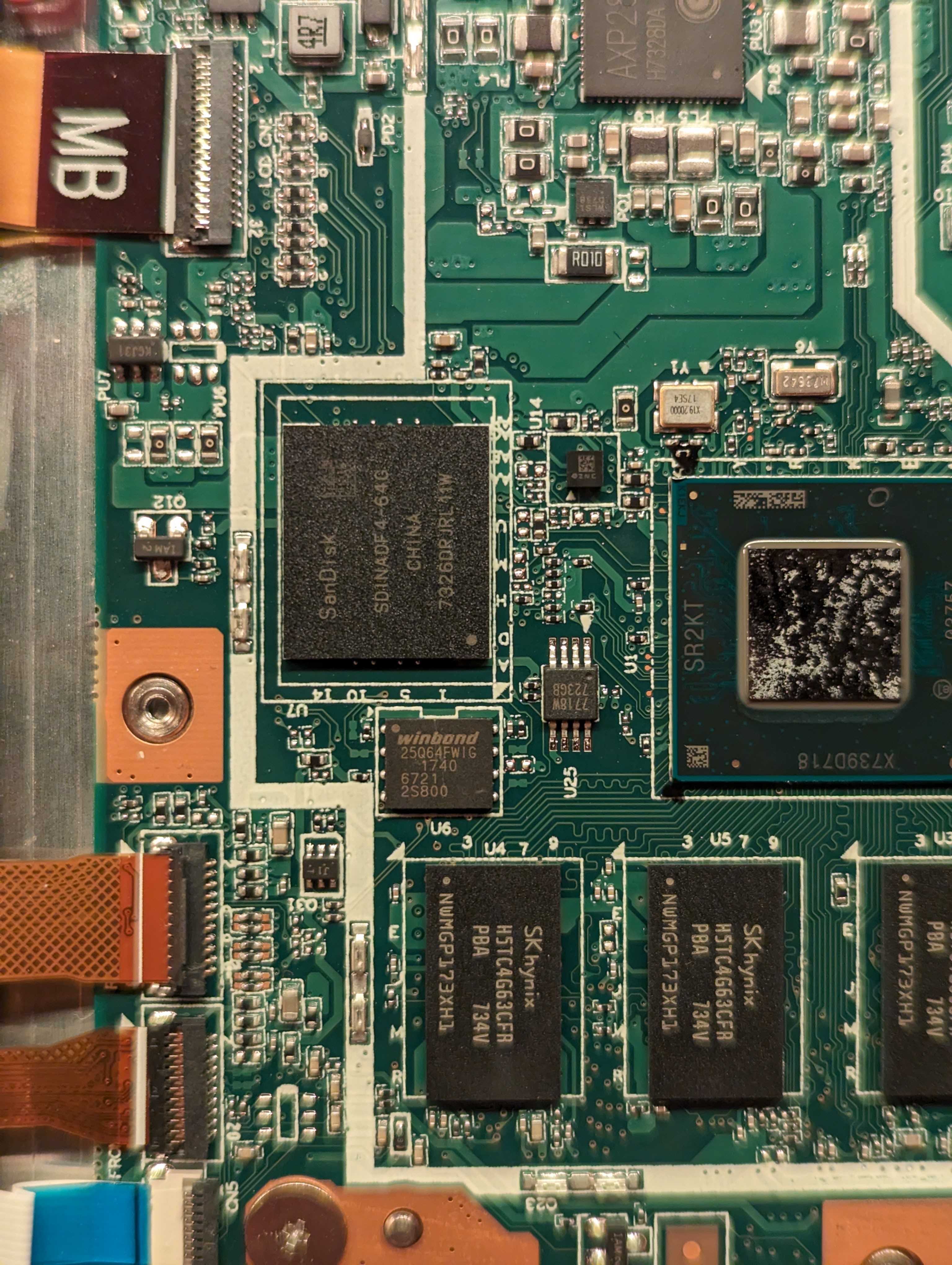

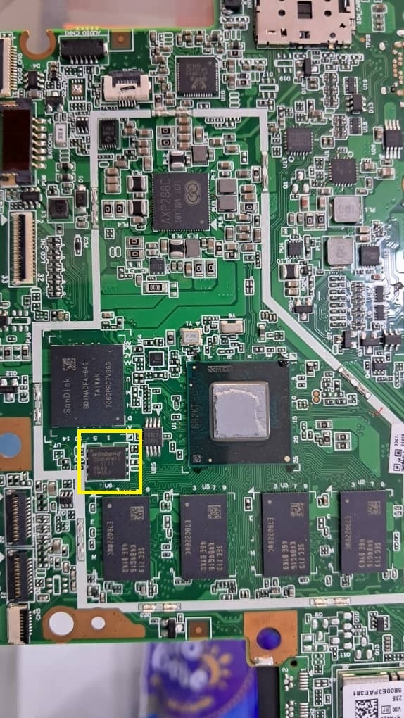

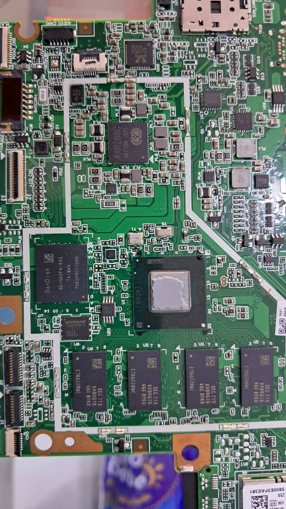

          Lenovo MIIX 320-10lCR any help
          I want to specify a location for bios chip in mainbord

            #45
            Need the name of this chip, the picture is not clear.

              #46
              I want to specify a location for bios chip in mainbord​

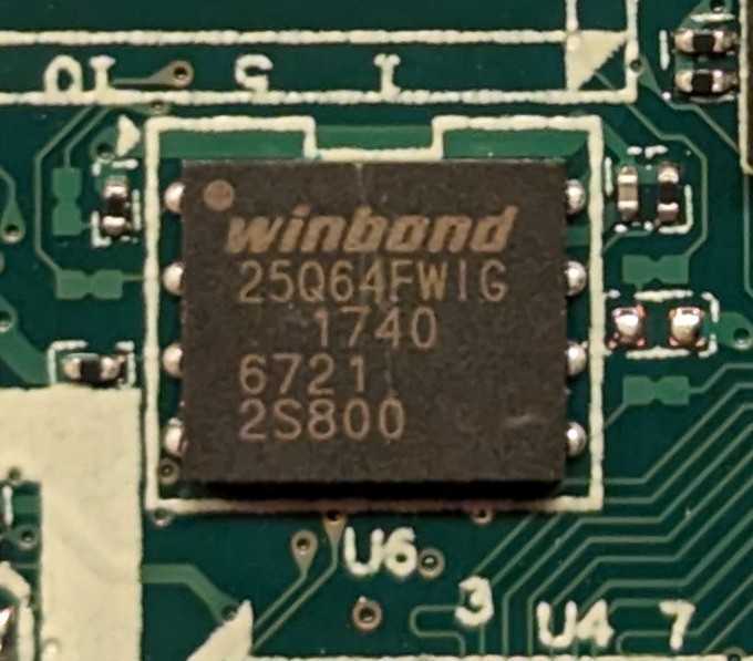

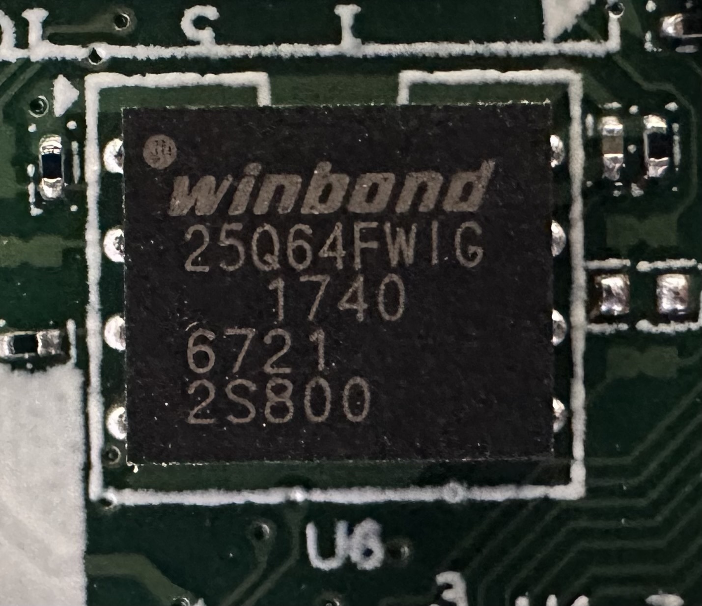

                #47
                Hi !
                For mine MIIX 320-10ICR the bios chip is 25Q64FWIG
