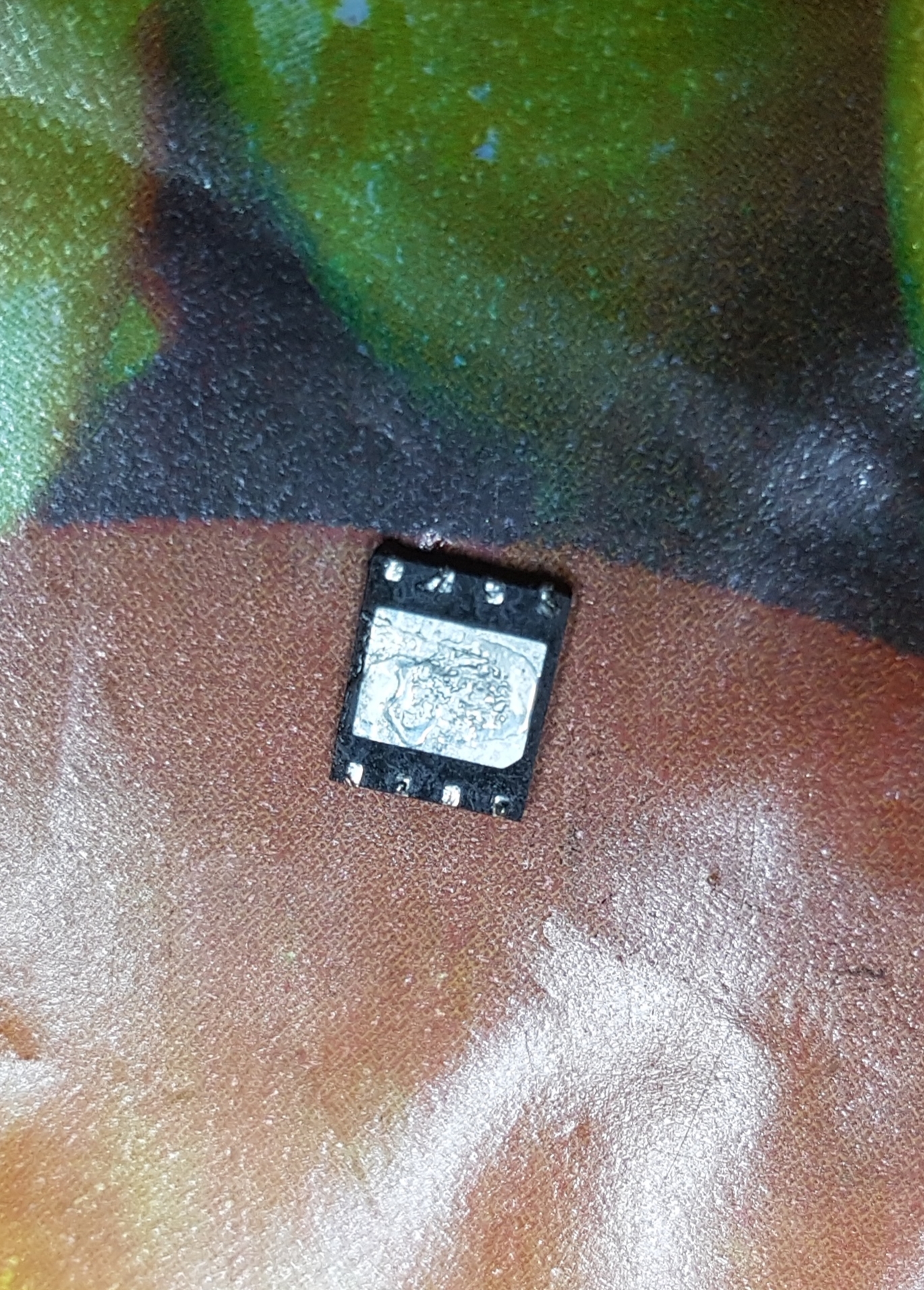

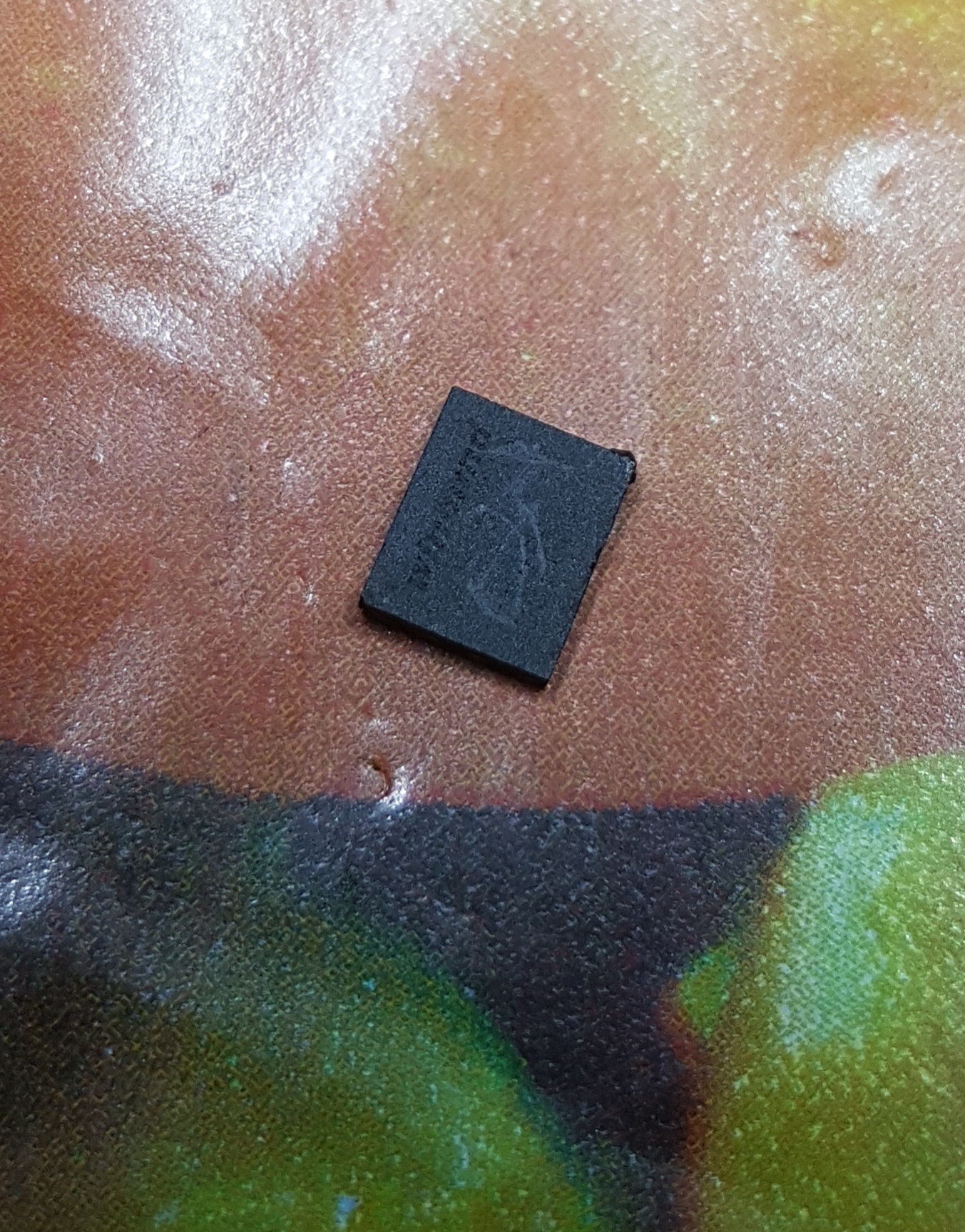

          Re: Lenovo MIIX 320-10lCR bios password
          Hi, I have watched the video and he mentioned a dot on the bios that should be pointed in a direction.
          But the problem I see no dots on my bios chip.
          This is a bios chip of a Lenovo Ideapad Miix 320.
          You can see in the pictures below.
          Thanks.
            Thanks.
            it should be in the top left, in the position where you took the picture.

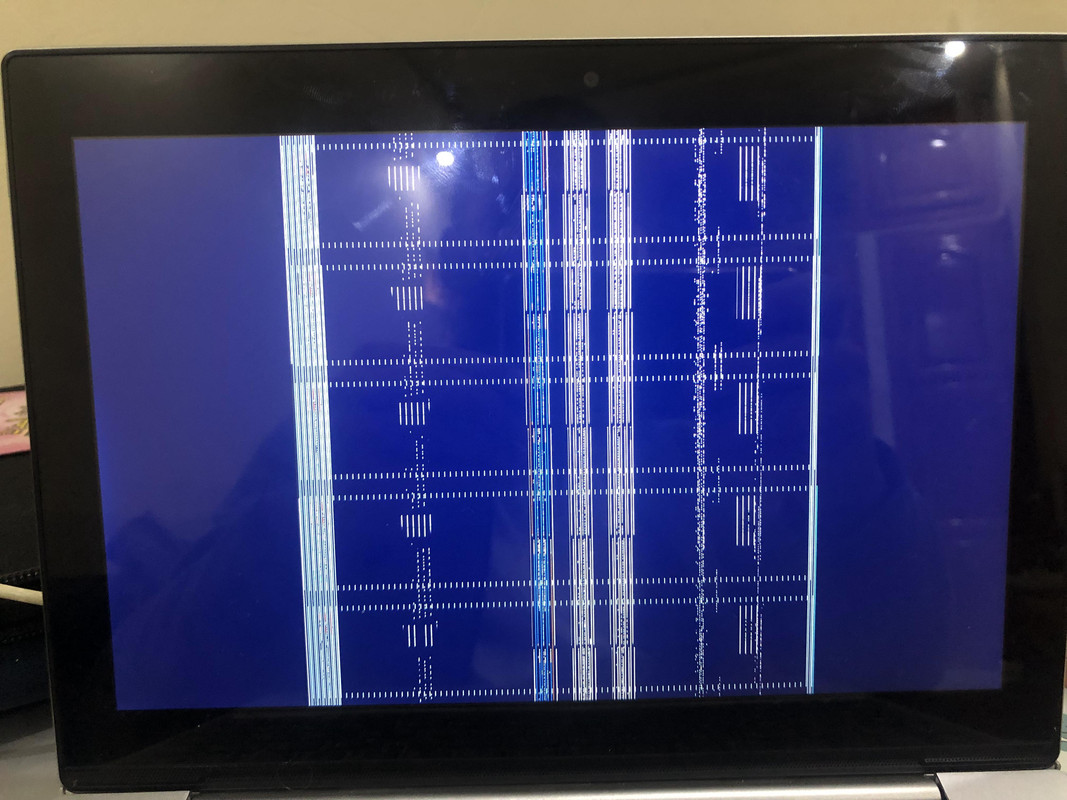

                              hello
                              write dump put no power on show only led
                              rewrite original file work put with password
                              any help for remove password ??
                                  Password is: kxwslr
                                  work good put aftter instal windows
                                  show this
                                    Check display with external monito/LCD TV via HDMI portand see result
