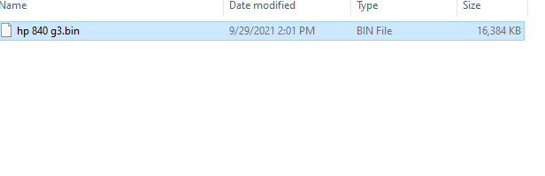

                          • Temp_user1
                            • Oct 2021
                            • 7
                            #533
                            Re: bios dump elitebook 840 g3
                            what size should the bin file be?
                            do i get the bios from winbond 25q64fviq or mxic mx25l12873fzni
                            And yes i am using ch341a.
                            The picture is what got from reading mxic chip.

                              • Temp_user1
                                • Oct 2021
                                • 7
                                #535
                                So is it the other chip?

                                  #536
                                  the bios is empty..remove the bios chip from the motherboard before writing or reading..or glue wires between chip and proframator, do not use the clip..if errors..use these programs ... and post again ..
                                  https://www.badcaps.net/forum/showpo...04&postcount=7
                                  https://www.badcaps.net/forum/showpo...6&postcount=10
                                  https://www.youtube.com/watch?v=DWWigscuQDY
                                  • Temp_user1
                                    • Oct 2021
                                    • 7
                                    #537
                                    Is this the correct bin file?
                                    Also thanks peste for helping me out.
                                    • Vesko356
                                      VIP Moderator
                                      • Aug 2018
                                      • 4386
                                      • Bulgaria 🇧🇬
                                      #538
                                      Yep.
                                      Become a Badcaps supporter
                                      Thanks to all supporters.
                                      • Temp_user1
                                        • Oct 2021
                                        • 7
                                        #539
                                        I cant get into bios also its stuck on the hp logo.
                                        • Temp_user1
                                          • Oct 2021
                                          • 7
                                          #540
                                          Flashed the locked bios on it again.
                                          Still doesn't work.
                                          rip
