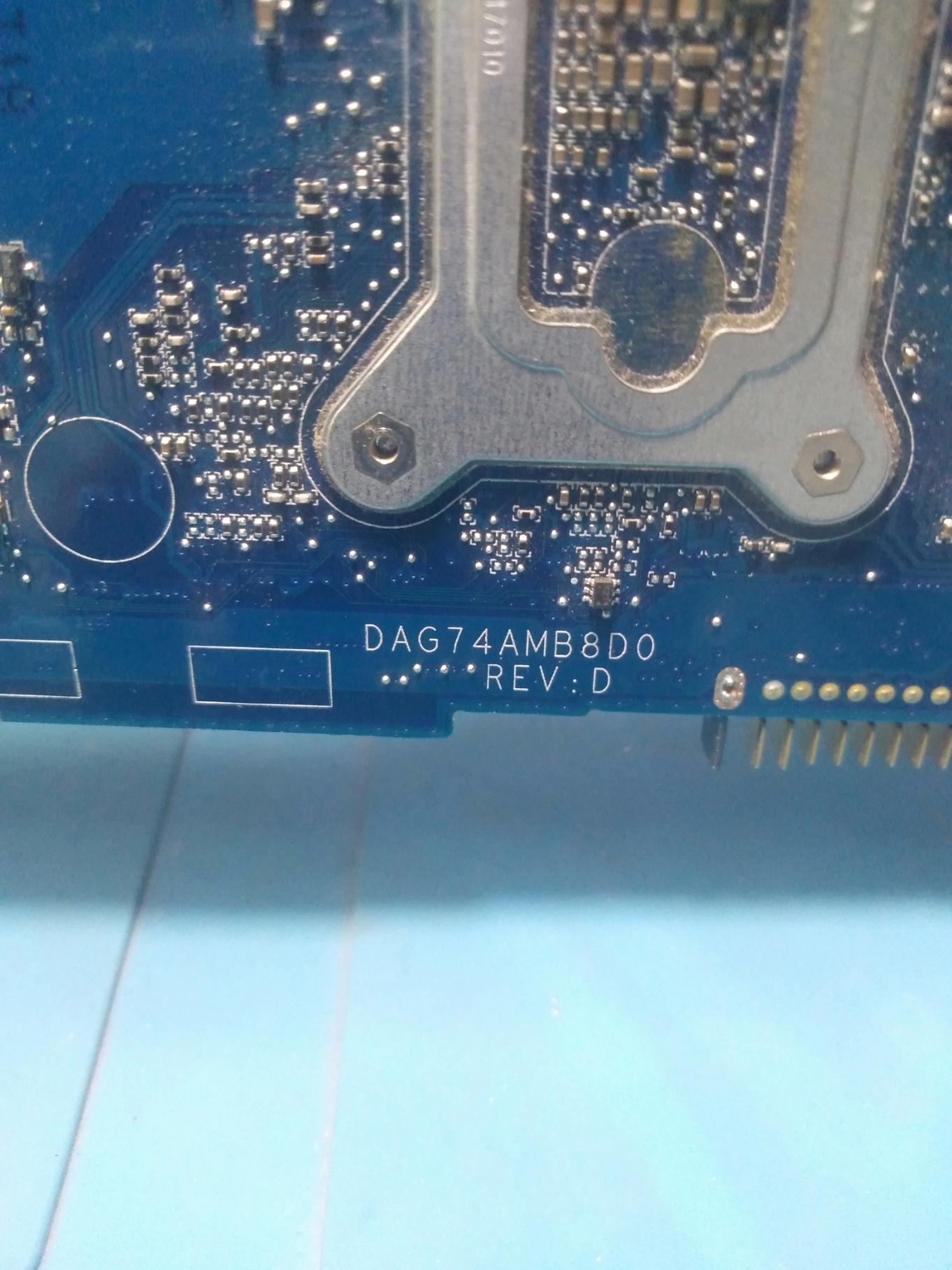

HP DAG74AMB8D0 Rev D bios needed
  • jmedina100
    • Apr 2017
    • 3
    • nicaragua
    Re: HP 15-CC002NX bios needed
    any body have the bin of KBC EC ITE 8987E

                      Hi can someone help me and repair my bios please. The laptop fan runs and stop again and again repeatedly here is the original dump
                      • peste
                        • Dec 2016
                        • 13920
                        • ROMANIA
                        #31
                        bios extracted from the HP website update, the laptop has three bios variants, yours is 08361
                        DMI 220000 - 223FFF
                        KEYWIN 228000 - 22803F
                        • Stunt
                          • Oct 2019
                          • 203
                          • South Africa
                          #32
                          DMI 220000 - 223FFF
                          Thanks man it worked liked charm. I really appreciate your time

                              You must find the BID number in your dump to know which one from the list to choose. Upload your backup dump here, or see the image as example how to find the BID number yourself:
