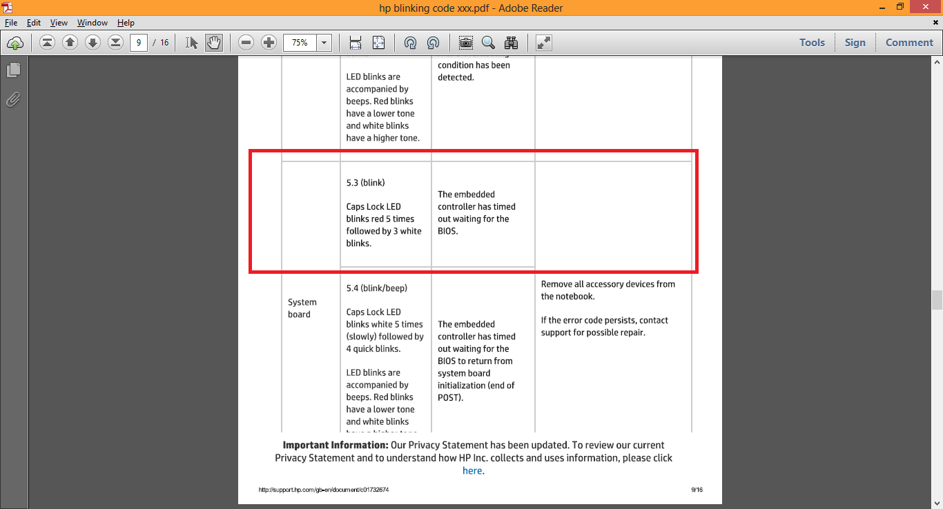

                              now the problem is the chip cannot finish veryfying on the programmer, so i replaced the chip and flashed with the bios from hp site but same issue capslock blinks 5 times then on the 6th blinks it blinks continously
                                Re: HP 15-CC002NX bios needed
                                anyone please help on this when i change the chip and flashed it again with the bios from hp site that is working before but now caps lock blinks 5 times then on the 6 times it blinks 3fast blink and so on .
                                      - Maybe you need to programming the KBC chip also.
                                      - Check around bios chips, if any resistor was out of direction, missing, etc.
                                        thanks for the response meritosari i checked already around bios chip there is no resistor moved.maybe it is the kbc. but the blinks from the caps lock is not redlight its white
