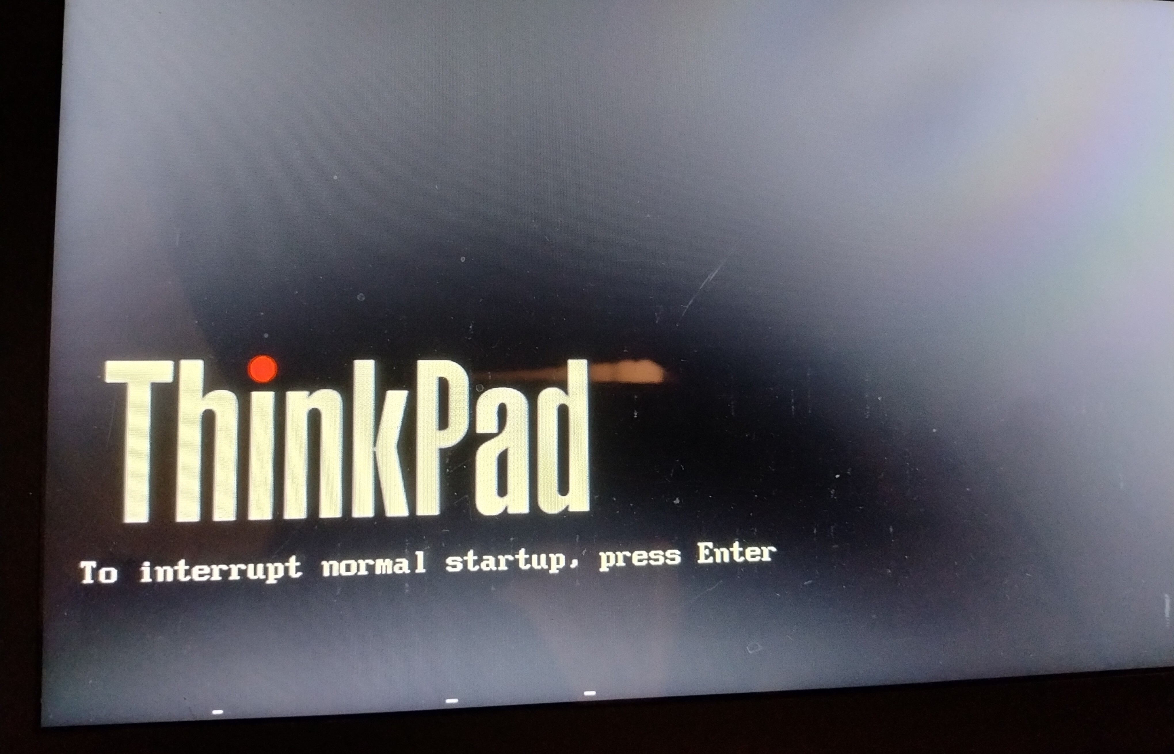

            Re: Remove_SMM... UEFI.
            mod MxP - not success just Melody beeping
            PATCHED nvar - there is an image but it doesn't ask to press esc or spase
            PATCHED - I flashed it, but the password is gone
            flash backup bios?
              restore backup?
              then no,
              go security and type blank password and save
              or load defaut work too
              after restore original
                PATCHED work ??
                returned the backup, the password was restored))
                now flash PATCHED to know for sure if it works
                  you have cleaned the security tab.
                  type supervisor password and power on password
                  blank twice and save or type a new password
                  then restore bios
                    this is not the usual patch, no need f1 or space like autopatcher, just nvdata cleaning
                    wait and try F1
                    it will never ask for password again forever
                    EDIT: If nothing works, read PATCHED after cleaning security and review it for me
                      then restore bios
                      its work + need clear sequrity chip

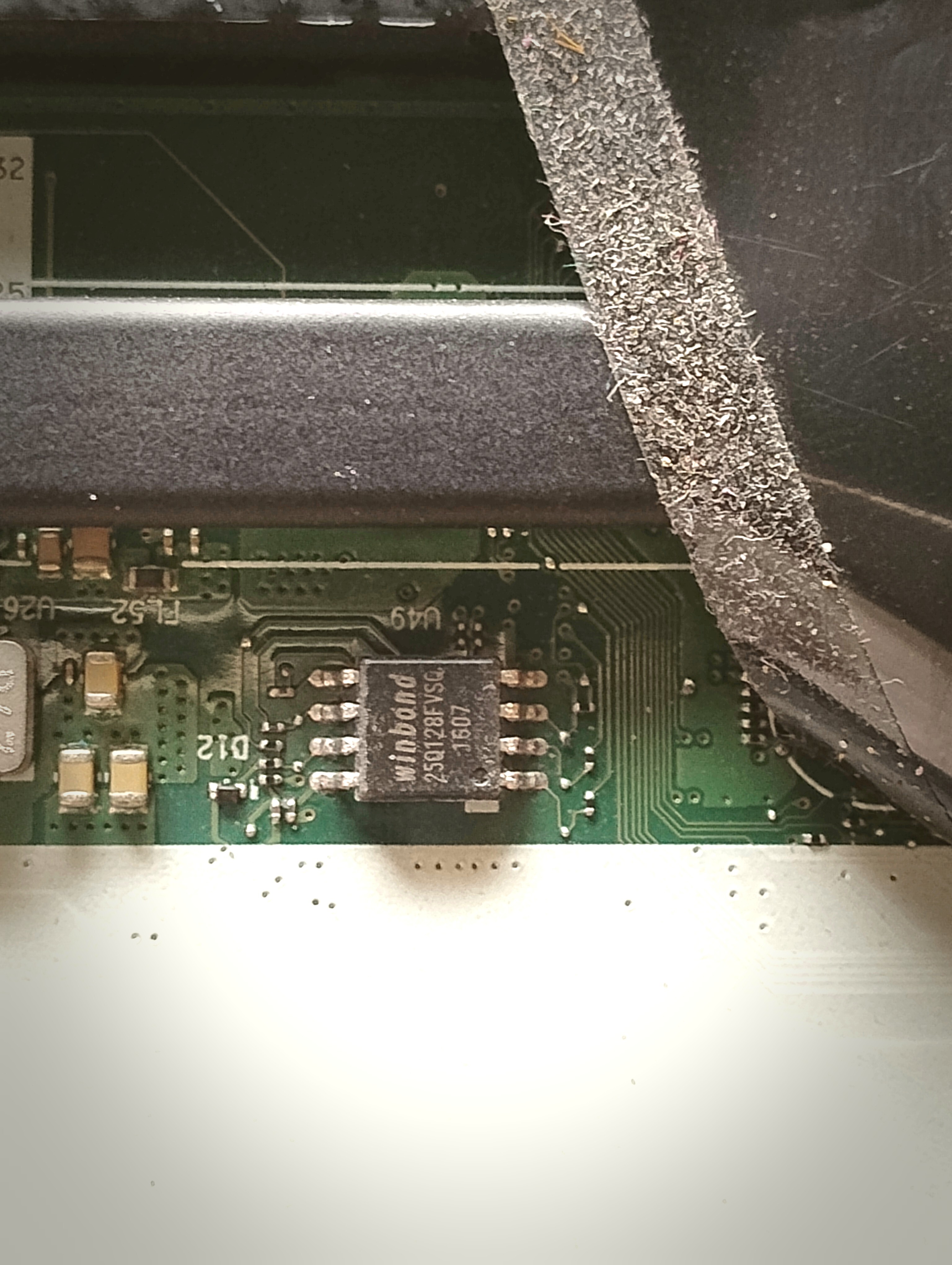

                                            Hey everyone!
                                            I need help with my Lenovo Chromebook 100e Gen 3.
                                            Here are the details:
                                            • Motherboard: LA-L131P
                                            • MFG Date: 2022/01/07
                                            • MTM: 82J80001BR
                                            • MO: MPNXB2103001
                                            • Factory ID: LI123
                                            I bought a new Winbond 25Q128FVSG chip.
                                            The chip currently on the board is the same model but with different ending letters.
                                            I can’t use the CH341 clip on the chip that’s on the board because it’s too low-profile and doesn’t make proper contact.
                                            The Chromebook is Google account locked, and I’ve already tried everything.
                                            I understand that I need to replace or...
