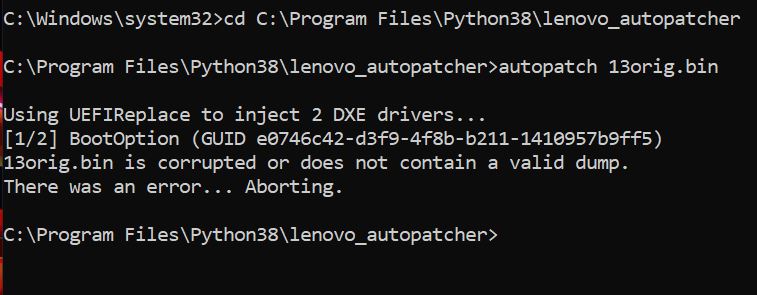

      Hello! Please help with reading bios. Tested few dumps from few T450 and 13 - always issue "dump corrupted or does not contain a valid dump".
      here some axamples:
      Cheched on another clean W10 pro...same issue. I cant understand problem in dump or in pyton...
      Created dump in Colibry and dump has been patched. New issue - after replacing patched dump with original laptop stuck on a black screen. Original dump not solvind an issue...

        Tested on T450...now when im recovering original dump laptop making just 5 beeps 2 times and do not load bios. Only Lenovo logo and black screen after "Enter"...
        Finally! Competed sucessfull: 2x T450, T440, Cardon X1 gen 2 (micronix).

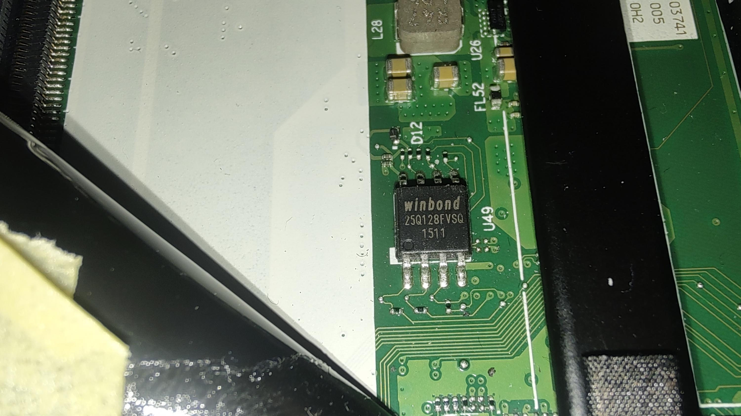

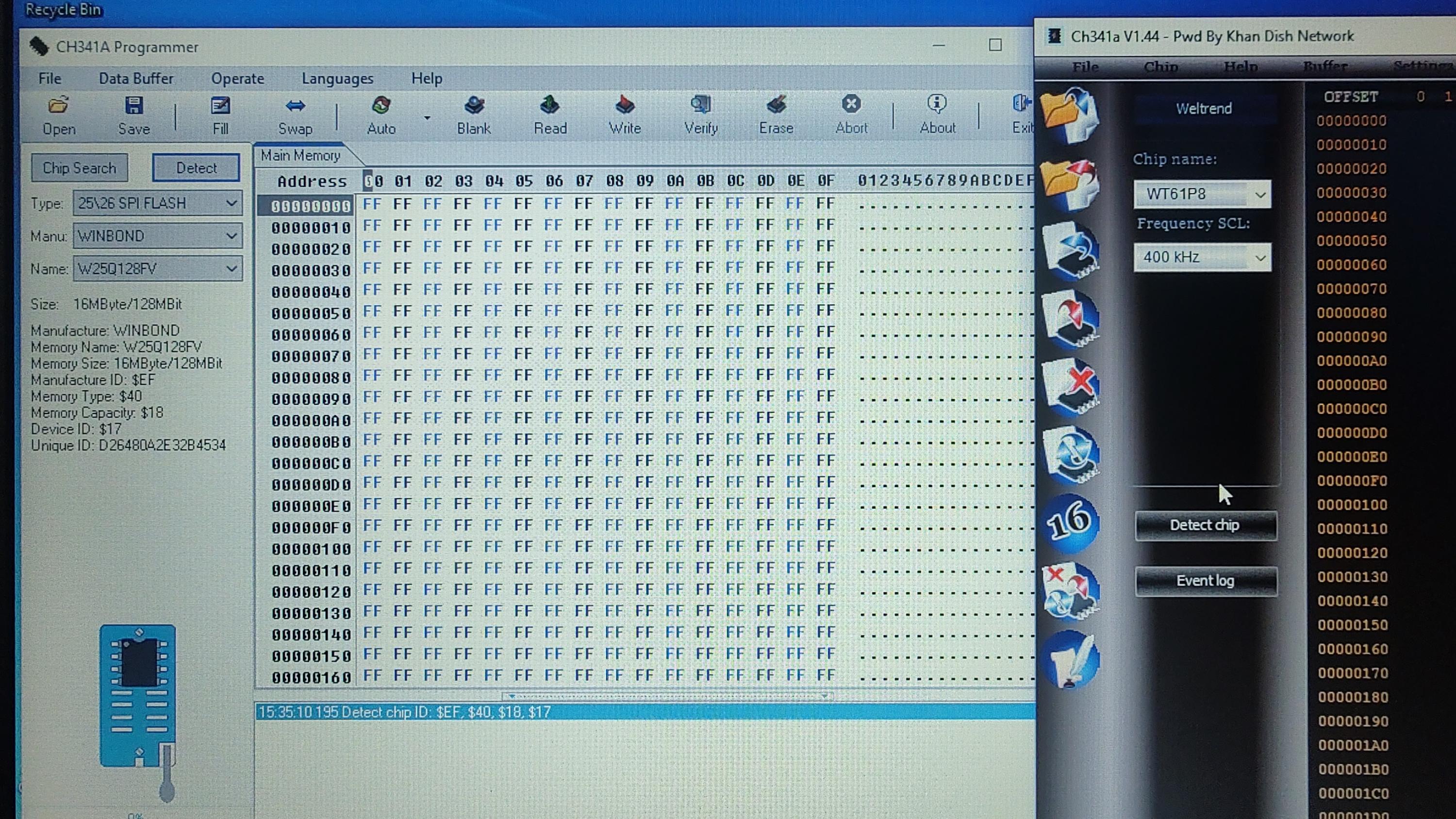

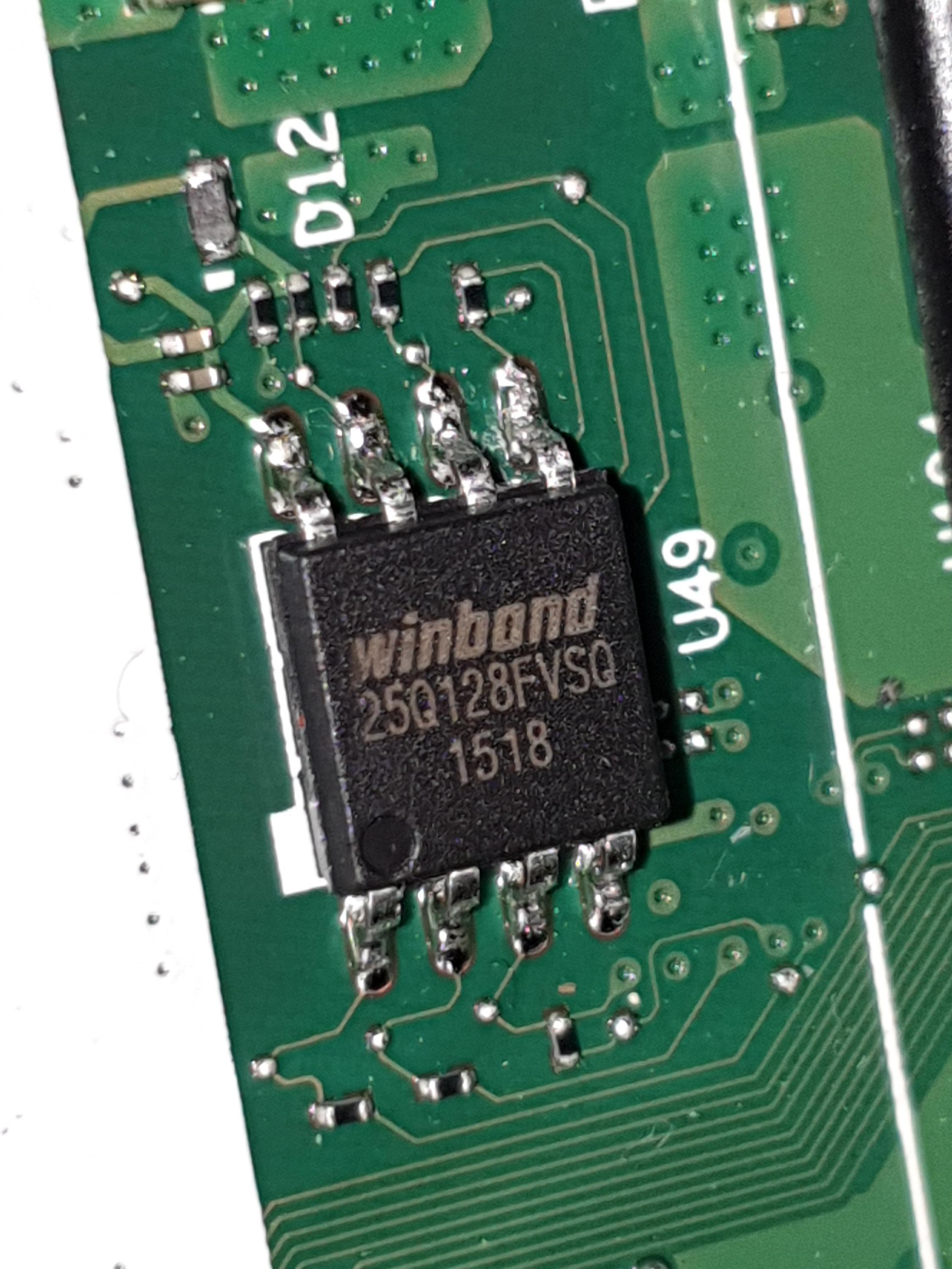

                        A bit off, but I don't want to start a new one for one question.
                        I would like to read my bios chip.
                        I try and try and try, but cannot.
                        With chinese app it read, but verify wrong at 50%. All the time at 50% .
                        The russian app detect my chip wrong.
                        Image attached.
                        My laptop is Lenovo T450.
                        Chip is : W25Q128FVSQ
                        I tried a T460 with similarly chip, and there was no problem.
                        It read it both chinese app and russian app too.
                        My laptop working. Running Windows 10 on it.
                        Only the bios have password.
                        Why I cannot read my laptop chip?
                        My chip image attached.

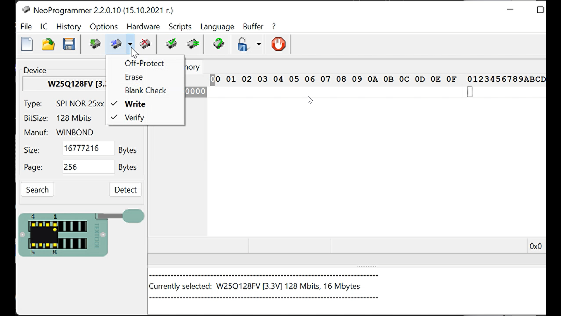

                            #73
                            Re: BIOS Programming - Which programmer to use??
                            First of all thank you so much for helping.
                            I have a question:
                            I am following this guide:
                            https://winraid.level1techs.com/t/gu...rammer/32948/2
                            But this Neo Programmer app is different.
                            Example I cannot found:
                            "Go to "Auto" and uncheck "Erase" and "Blank check" options:"
                            I am not sure how to do with this app what is in that guide.

                              #74
