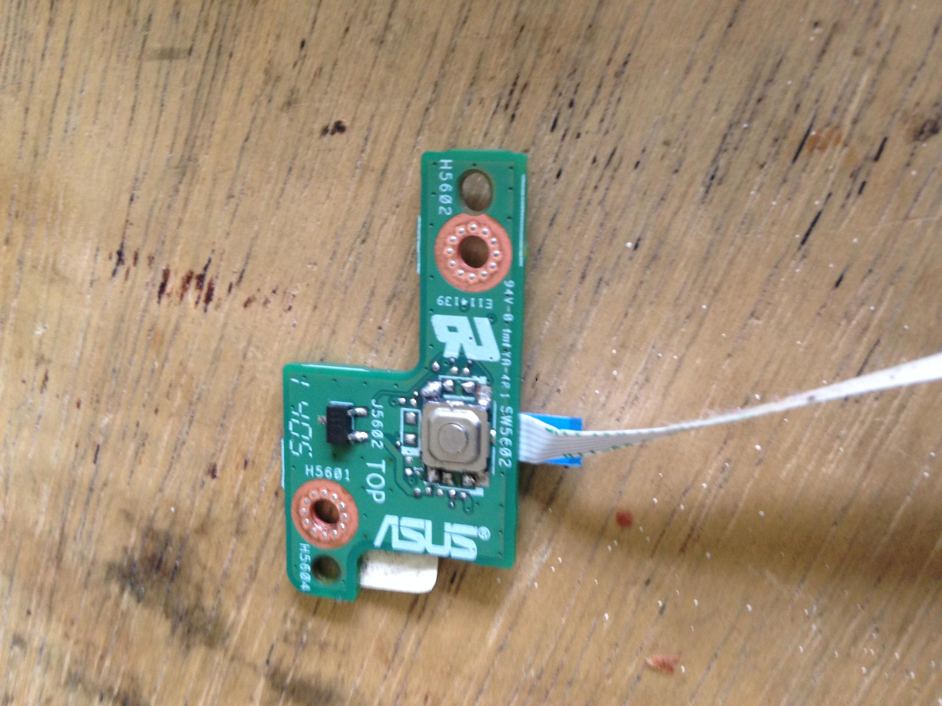

    i think this is not a bios isssue i cannot power on using power button but power switch board have 3.3v when i touch and short pin 3 and pin 4 it sparks and their is a green light, but when i do not touch those pins, green light goes off i think something short in that area anyone can help please

      Re: asus x452e bios needed
      update: i can power on the laptop if i short pin 2 and pin 3 but when put the power button switch board cannot turn on but there is 3.3v on button switch

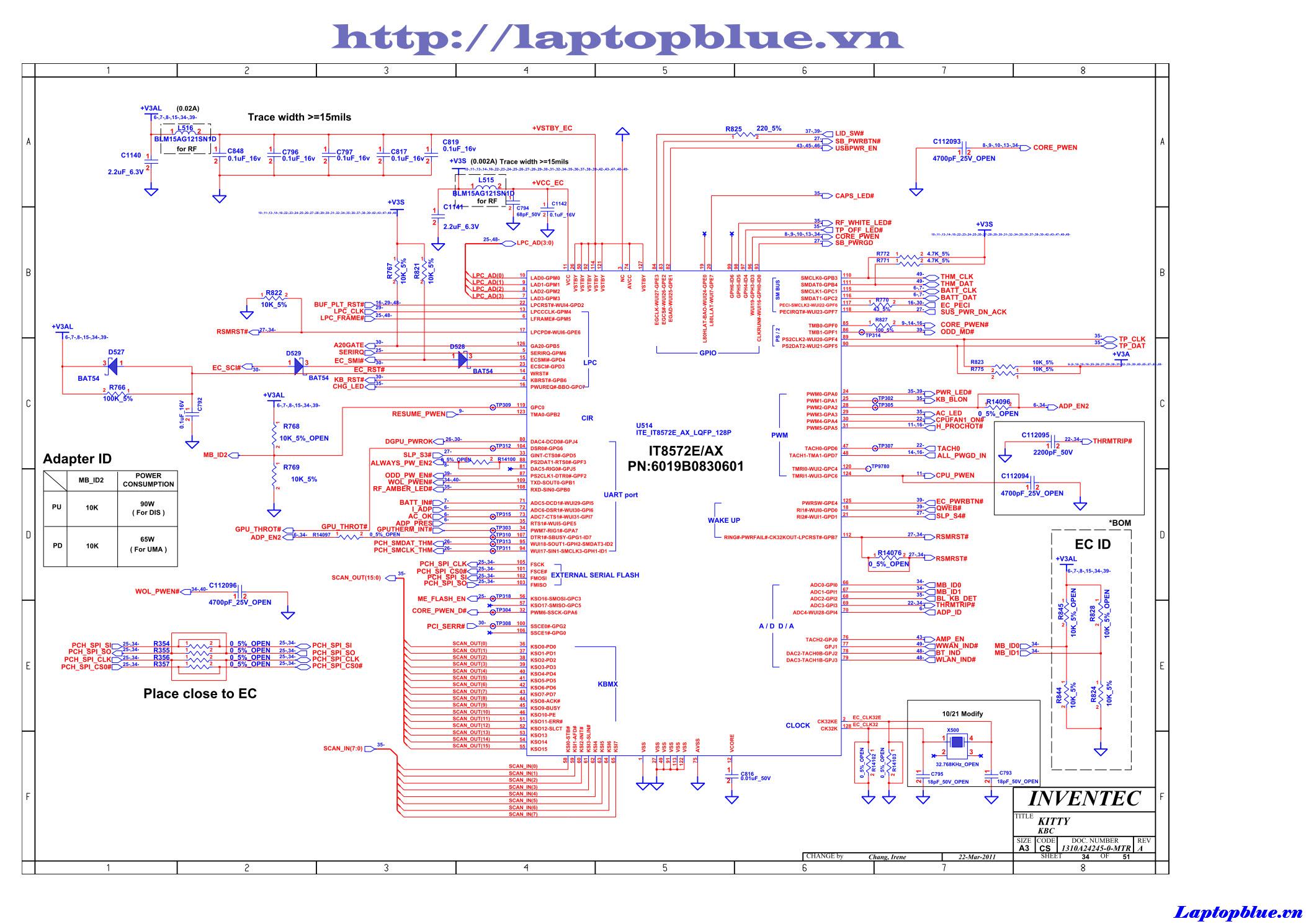

        Try to find the switching pin on sio and try to directly switch from there.
            Originally posted by Romulo
            thanks for the response mcplslg123 you mean i connect a jumper wire from kbc to power switch button? which pin i connect?
            I didnt mean that. Try to find out the switching pin on kbc and short that pin to gnd.
              Thanks for the response where could it be the switching pin for this please?
              • ridamouh159
                • Nov 2014
                • 365
                • maroc
                here is
                  still i cant resolved this issue i have attached the image of the switch board the two upper left and right of the button switch have 3.3v and the small transistor x311 on pin 2 have 3.3v but i cannot power on the laptop with this switch but if i short pin 2 and pin 3 laptop powers on and boot normal
                  • Romulo
                    • Nov 2016
                    • 484
                    • Philippines
                    and here is the image of the switch board
