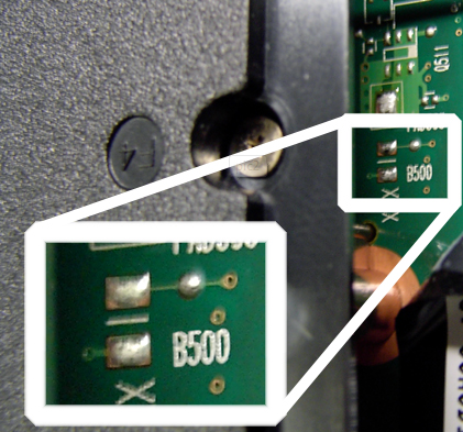

    I have Toshiba Satellite C650D-00E, forgot the master bios password. Please help me removing the password. Thanks in advance.

    Hi
    Check on the mainboard for a "xxx" or "b500" and do a short on these points usualy they are near the ram
