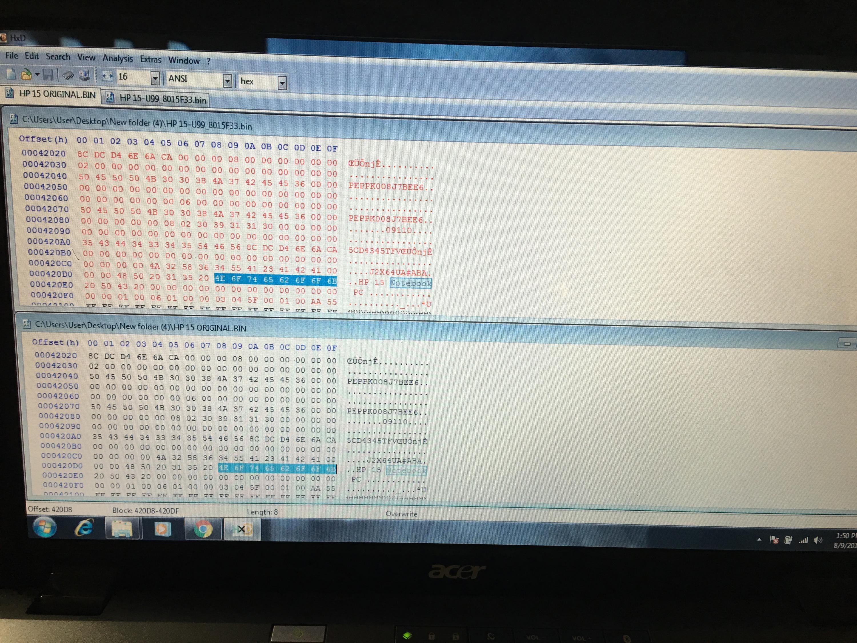

    HI FRIEND I UPLOAD FILE.
    Techman1025 CHECK THIS PLZ.
    LAST TIME U tutorial PROBOOK ADD DMI ITS WORKING GOOD. I TRY SAME METHODS NOT HEX VALUE SHOW.PLZ IF U KNOW UPLOAD TUTORIAL THANX.

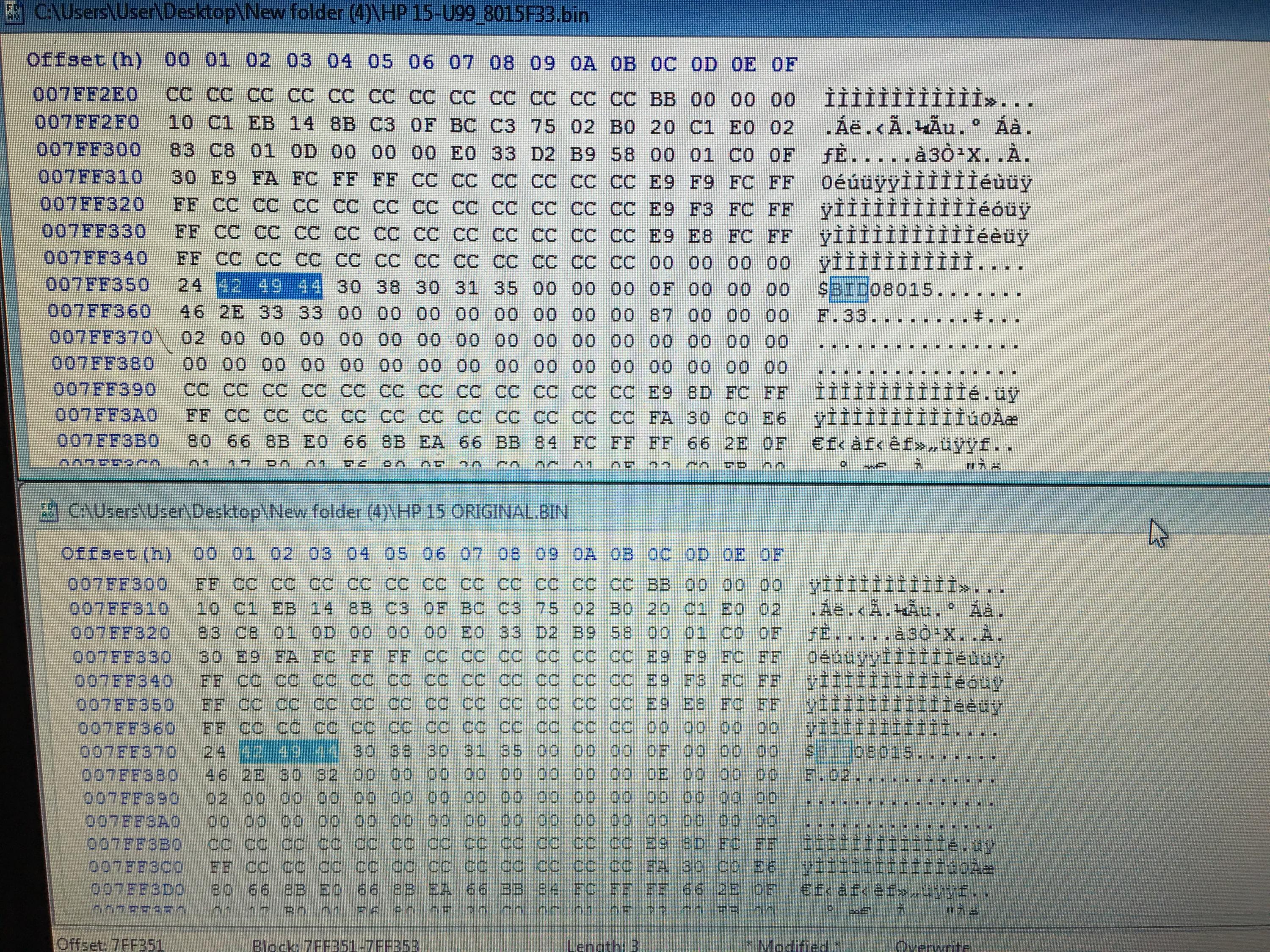

    Hi did it already ...to busy to do video ...look at attached file old model search NOTEBOOK right below is all DMI INFO Next your version number is not a exact match always SEARCH for $BID This is how to find the correct version when you extract a update from hp you will see it will have a couple of version # for that $BID compare it to the original the ending of your does not match your original so you will have problem ...
    this info should be a big help for YOU.

      THANX FOR INFO BUT I SEE ALREADY ADD SERIAL NO PRODUCT NUMBER BOTH BIOS WHEN RESTART LAPTOP DISPLAY SHOW PRODUCT NO SERIAL NO ERROR Manufacture Programming Mode in Unlock mode . HOW TO REMOVE THIS WAIT TOMORROW I HAVE SAME ERROR I UPLOAD 2 FILE CHECK THIS.
        Re: Hp add dmi.
        Here files upload serial no show in bios file but display show no serial no product no found.old file not error dmi new file error dmi.

          hi did it already ...to busy to do video ...look at attached file old model search notebook right below is all dmi info next your version number is not a exact match always search for $bid this is how to find the correct version when you extract a update from hp you will see it will have a couple of version # for that $bid compare it to the original the ending of your does not match your original so you will have problem ...
          This info should be a big help for you.

          oh yes you r great man such a great experience i understand. Last night i have a laptop 8mb file a upload i try many time but not success 8mb file i half 2 part first 4mb file inside the new bios and success because the serial num inside 4mb file many thanx sir.
