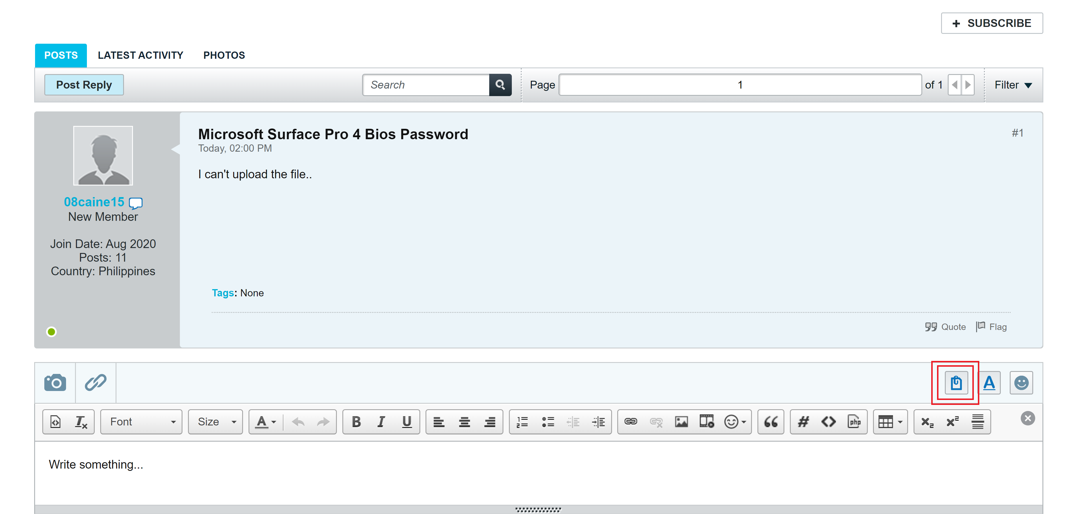

                                      #58
                                      I can't upload the file..
                                      • volinakis
                                        • Jan 2021
                                        • 2677
                                        • N/A
                                        #59
                                        use winzip or winrar to compress file ...
                                        • hoaca388
                                          Badcaps
                                          • Jan 2022
                                          • 11508
                                          • Viet Nam
                                          #60
                                          CCCCC
