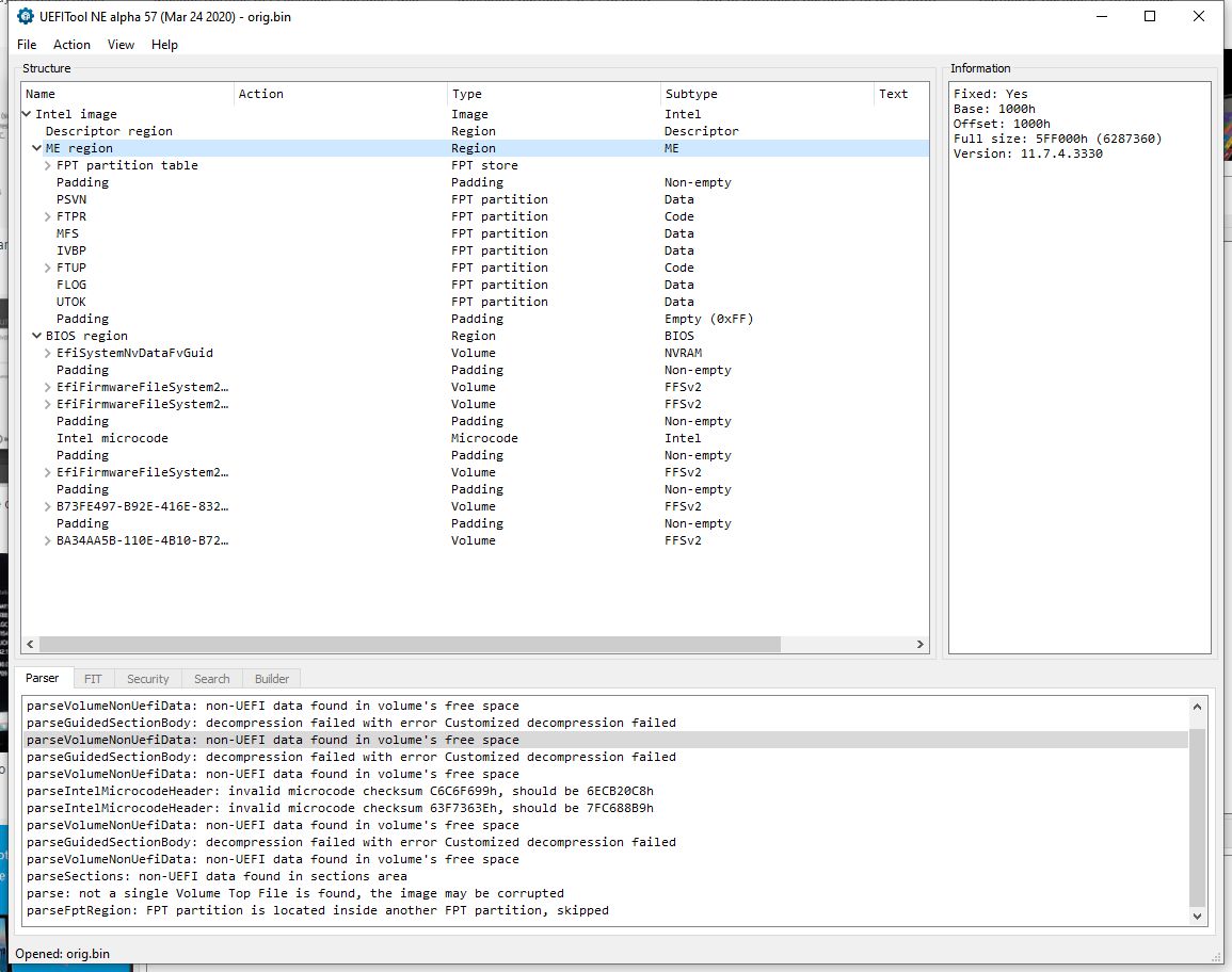

    please help to remove the bios password for Surface 4 pro
    here is a bios dump https://www.badcaps.net/forum/attach...1&d=1603708949
    Thanks!

          Re: I need bios dump for Microsoft Surface 4
          The surface does not turn on.
          Nor with an original dump, though, the reading doesn't seem to be flawed.
          Do you have an idea?
              Unfortunately not good, the original dump doesn't turn on either.
              "Copia_ClearPWD" downloaded at second post
              turns on but does not recognize the windows update, nothing works.
              I'm clueless.

                remove the bios chip from the system board before writing or reading.
                • pricer
                  • Sep 2017
                  • 6
                  • hungary
                  Yes I made a mistake, I didn't remove it from the motherboard, unfortunately the dump became faulty.
                  I found another biost for everything that works except Me and Touch.
                  Some solution would be good for a touch controller.
                  Can't use anything from the faulty backup that can help?

                      #30
                      Thanks.
                      Power-up time has been accelerated, something has been installed and updated.
                      I deleted the "internal driver" Me and Touch driver from the control panel, no longer trying to install unsuccessfully at startup.
                      Bios touch controller firmware : 0.0.0.0
                      Bios model name: Oem product (so you can find the necessary drivers for the next installation?)
                      I think the wrong program (ch341 1.34) caused the faulty backup, only v1.18 can read properly write to W25Q128FV.
                      With 1.18, writing is also successful.

                            Hi, sorry for so long answer.(Nightshift)
                            The problem is that the Touch is not working and the ME version in Bios is 0.0.0.0.0. In the last few day i tryed to replace ME Region with help of a Manuel from Win Raid forum. I replaced it but display dont come on. If insert usb drive in, i can see that surface is power on but nothing happend. I can turn it On and Off but it not booting and i cant see Surface logo.
                            Sorry for my English...
