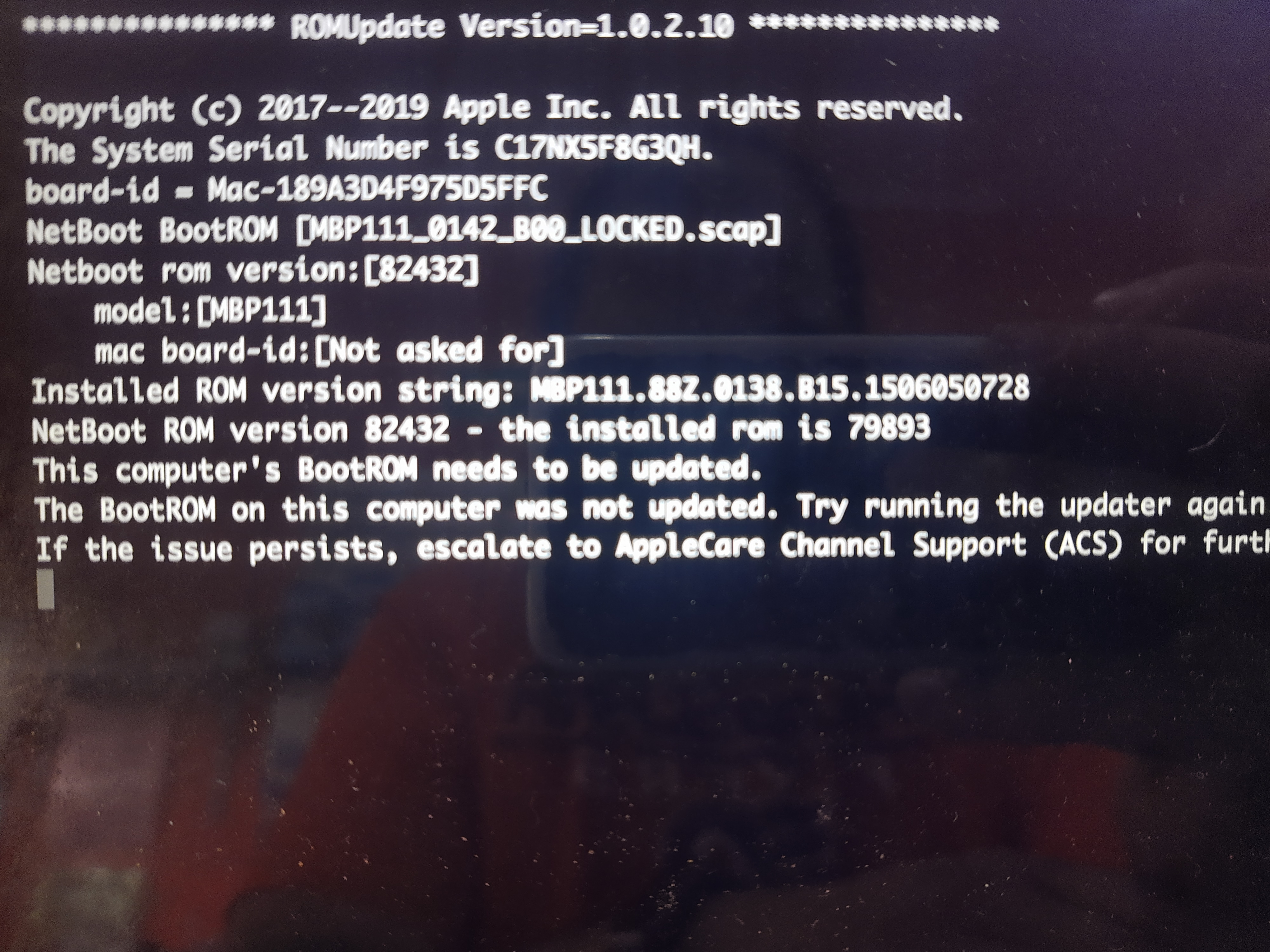

                              • Xiran
                                • Jan 2019
                                • 49
                                • Qro
                                #75
                                Hi to all!
                                Can be posible, to do an efi firmware update manually? I've tried with Apple app without luck...
                                It's an a1502
                                0138.b15.150605072
                                I have a macbookpro11,1 who i revive from a water damage, i can use macos sierra normal from usb, but i can't install high sierra (yes, the firmware is not updated), somebody sells me, without turning on (only for pieces), but actually, i hopefully repair it, but don´t include the original ssd... =(, so i put an adapter.
                                i´ve tried to update directly the firmware with MACBRTOOL_V1.0.0_IMG, but no luck...
                                I've checked the list, and it appears:
                                MBP111_0142_B00_LOCKED.scap 82432 0142.00 MBP111 Mac-189A3D4F975D5FFC
                                Here are the pic:

                                  #76
                                  Hi friends!
                                  I have:
                                  Apple MacBook Pro A1502 (820-3476-A)
                                  Board-id: Mac-189A3D4F975D5FFC
                                  serial C17NX5F8G3QH
                                  EFI update please?
                                  I put the next firmware updated, but no constant power on...
                                  • peste
                                    • Dec 2016
                                    • 13661
                                    • ROMANIA
                                    #77
                                    Originally posted by Xiran
                                    Hi friends!
                                    I have:
                                    serial C17NX5F8G3QH
                                    EFI update please?
                                    Try..
                                    • Xiran
                                      • Jan 2019
                                      • 49
                                      • Qro
                                      #78
                                      Originally posted by peste
                                      Try..
                                      Thx for answer peste!
                                      ARe there some efi Shell Commands to do the task? For not desolder and resolder the chip... =(
                                      • Xiran
                                        • Jan 2019
                                        • 49
                                        • Qro
                                        #79
                                        Try..
                                        Excuse me peste, but it don´t have the apfs driver... =(
                                        • Xiran
                                          • Jan 2019
                                          • 49
                                          • Qro
                                          #80
                                          Ok, here comes god news, with this file i can install high sierra (with apfs driver dxe), but doesn't detect wifi card...
