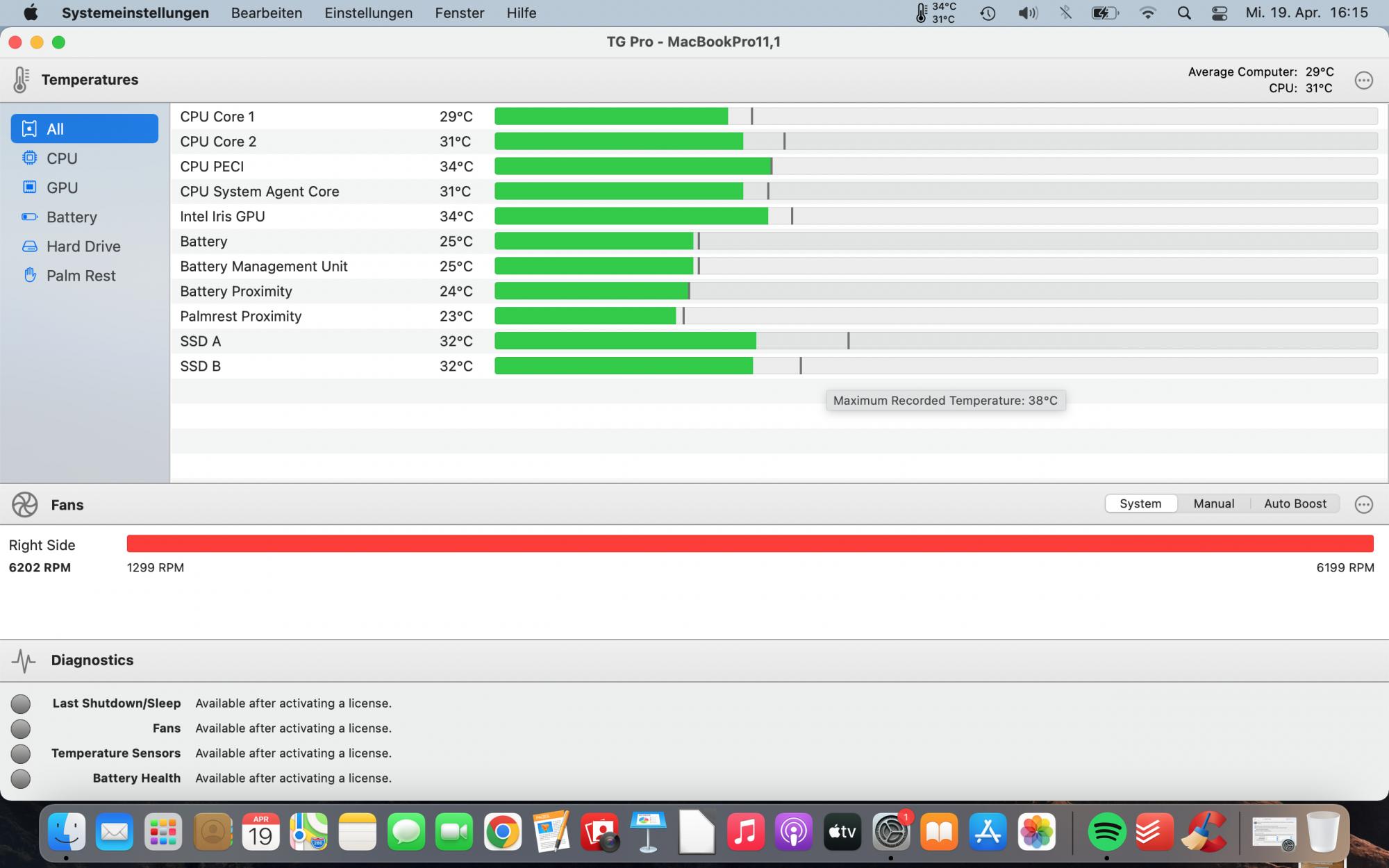

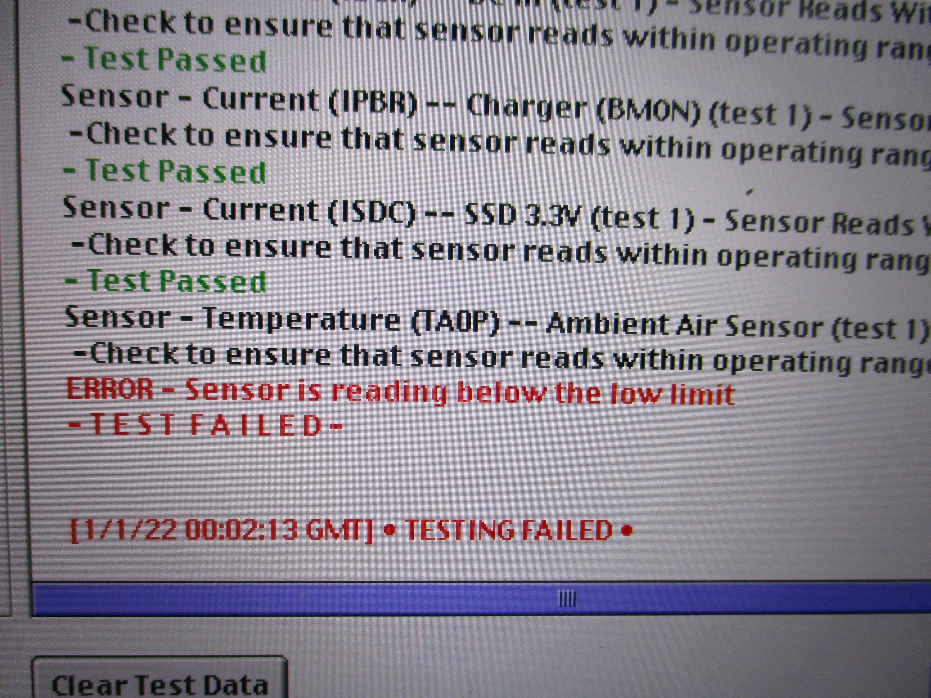

    got this defective Notebook. It boots, but CPU is throttled and fan always 100%.
    MacBook Pro Core i5 2.6 13" Mid-2014
    A1502
    EMC 2875
    Mainboard 820-3476-A
    I know, this fault is most likely a defective temp sensor, but Apple Diagnostics is useless (PFM006, PPN001 & NDC001) and TG Pro also does not show any issues. Any idea where to start? Thanks!

          Re: Apple MacBook Pro A1502 820-3476-A Slow / Fan full on
          Run ASD instead of AHT/Diagnostics. Also several sensor reading software won't show erroneous sensors so they are useless in this situation.
            Thanks! I had no idea of it's actual existence.
            TA0P - Ambient Air Sensor

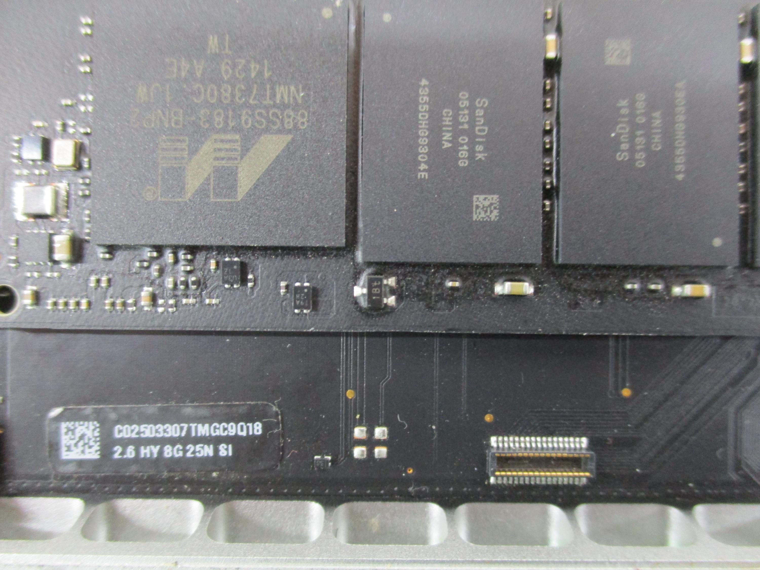

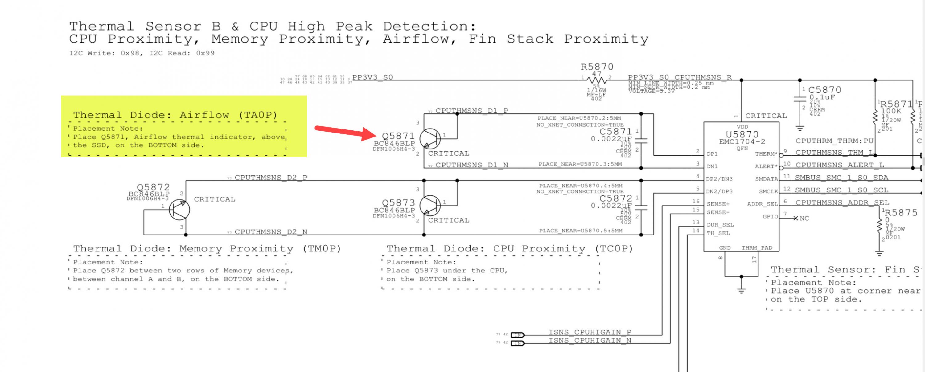

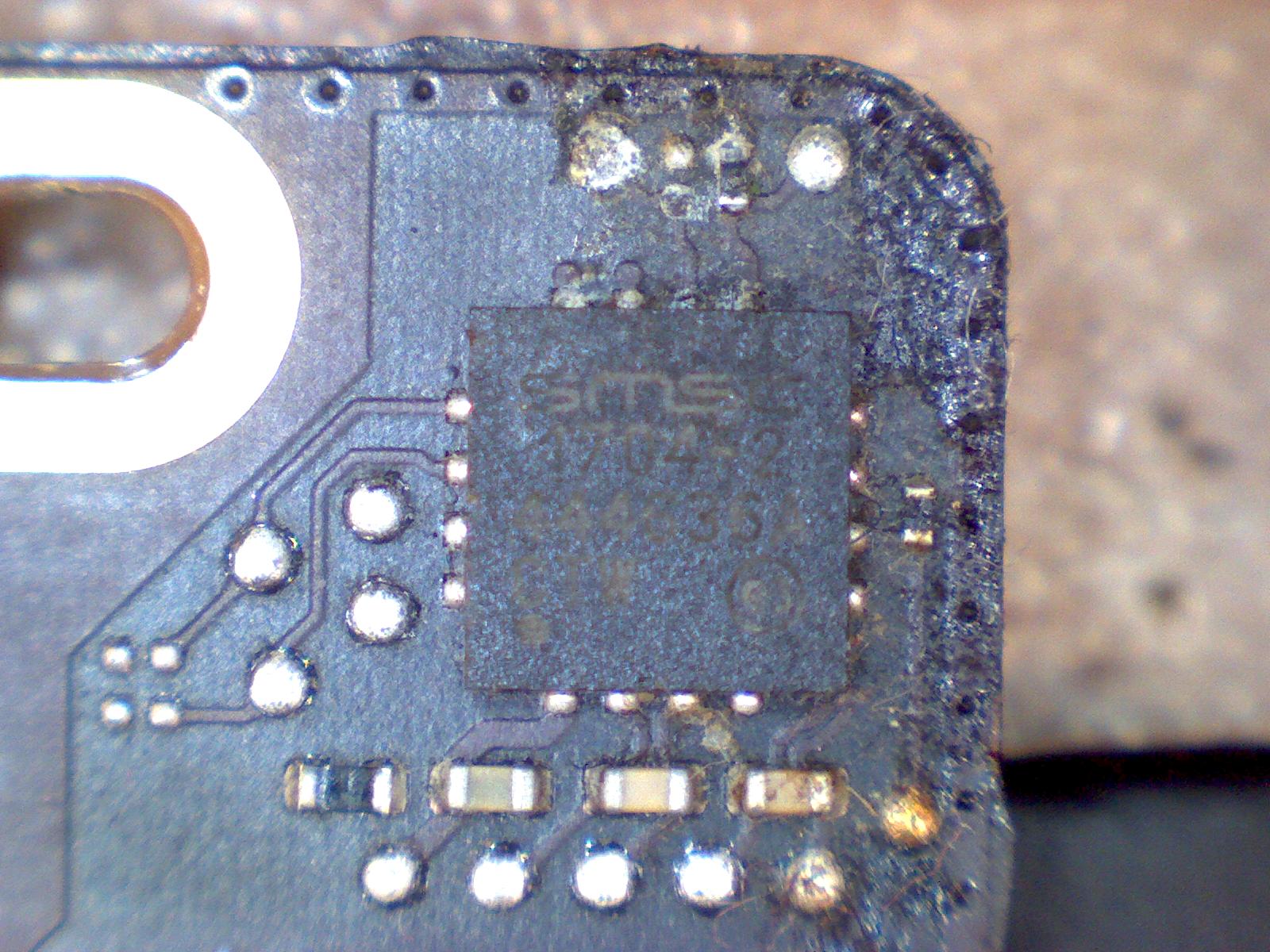

                  If I am following this thermal sensor correctly, you should have a 2 wire transistor that must be applied onto the body of the SSD / drive for thermal checking. Do you see any such piggy backed device on the SSD ?
                  If not, you can make your own using a cheap transistor - we have done this in the past.
                  • REpairAT
                    That's the closest I could find.
                      Yes, that very well may be a thermal sensor. Where is this located? Near your SSD?

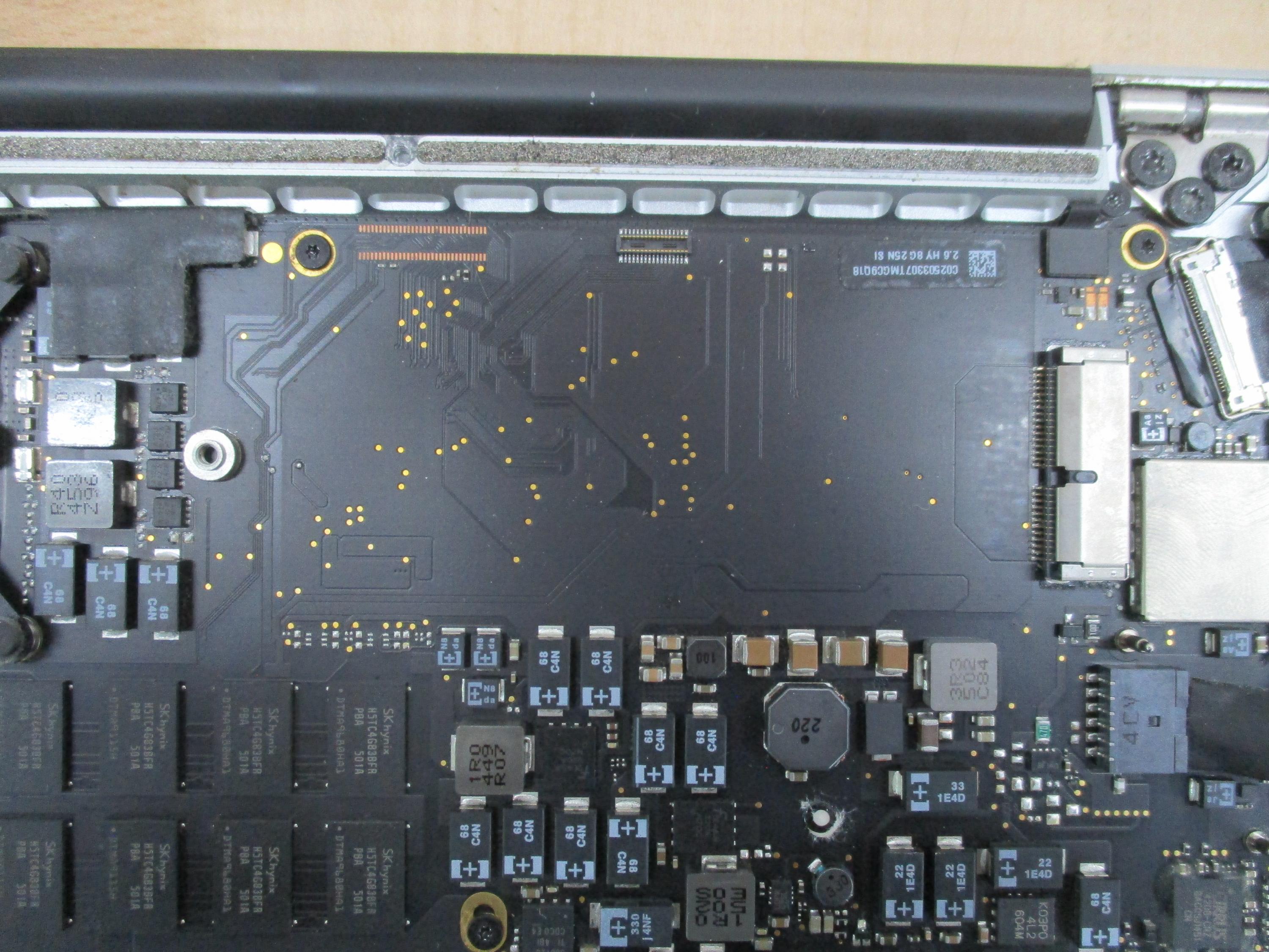

                        It's on the SSD Board itself

                            Set ASD to continue on error to see if there are other bad sensor readings.
                            • REpairAT
                              • Nov 2020
                              • 144
                              • Austria

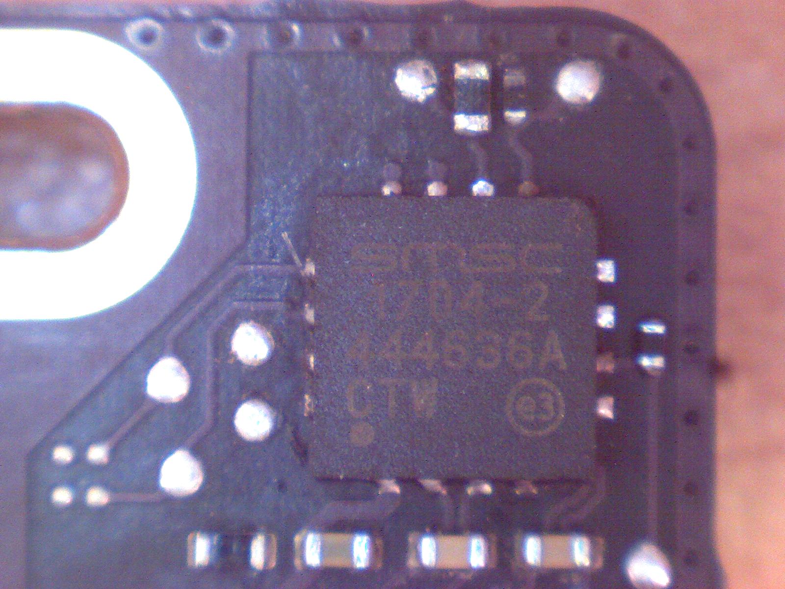

                              Thanks, it was absolutely stupid to cancel after the first result.
                              So here we have:
                              TA0P (Ambient Air Sensor)
                              TC0P (CPU Proximity)
                              TM0P (DDR3 Proximity)
                              Th1H (Right Fin Stack Proximity)
                              ... and I assume, each of them is read by U5870 on the picture, mon2 shared above. I will focus on this and report. Thanks so far!
                              • mon2
                                • Dec 2019
                                • 14685
                                As per above suggestion, review the smbus lines that drive this common sensor ic. If the lines are stuck, they will all fail. Measure the voltage to ground of the SCL and SDA lines for this group.

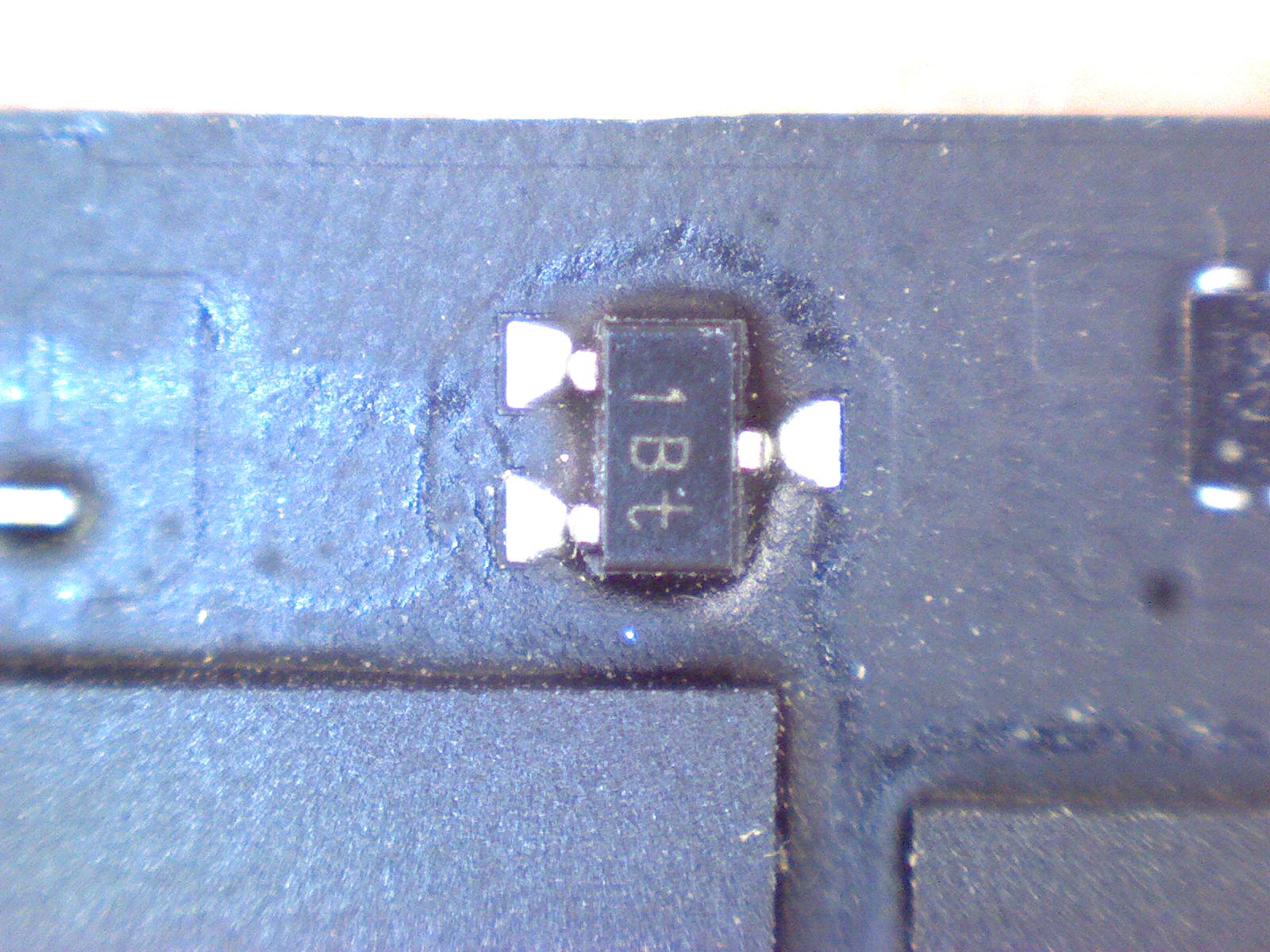

                                  Quick update, was busy last week: Job is done! Thanks again for your support. Under the microscope, the issue was obvious, no idea how I could miss it first. All working fine now.
                                  BR!
                                    Now, THAT is a nice cleaning job!!
