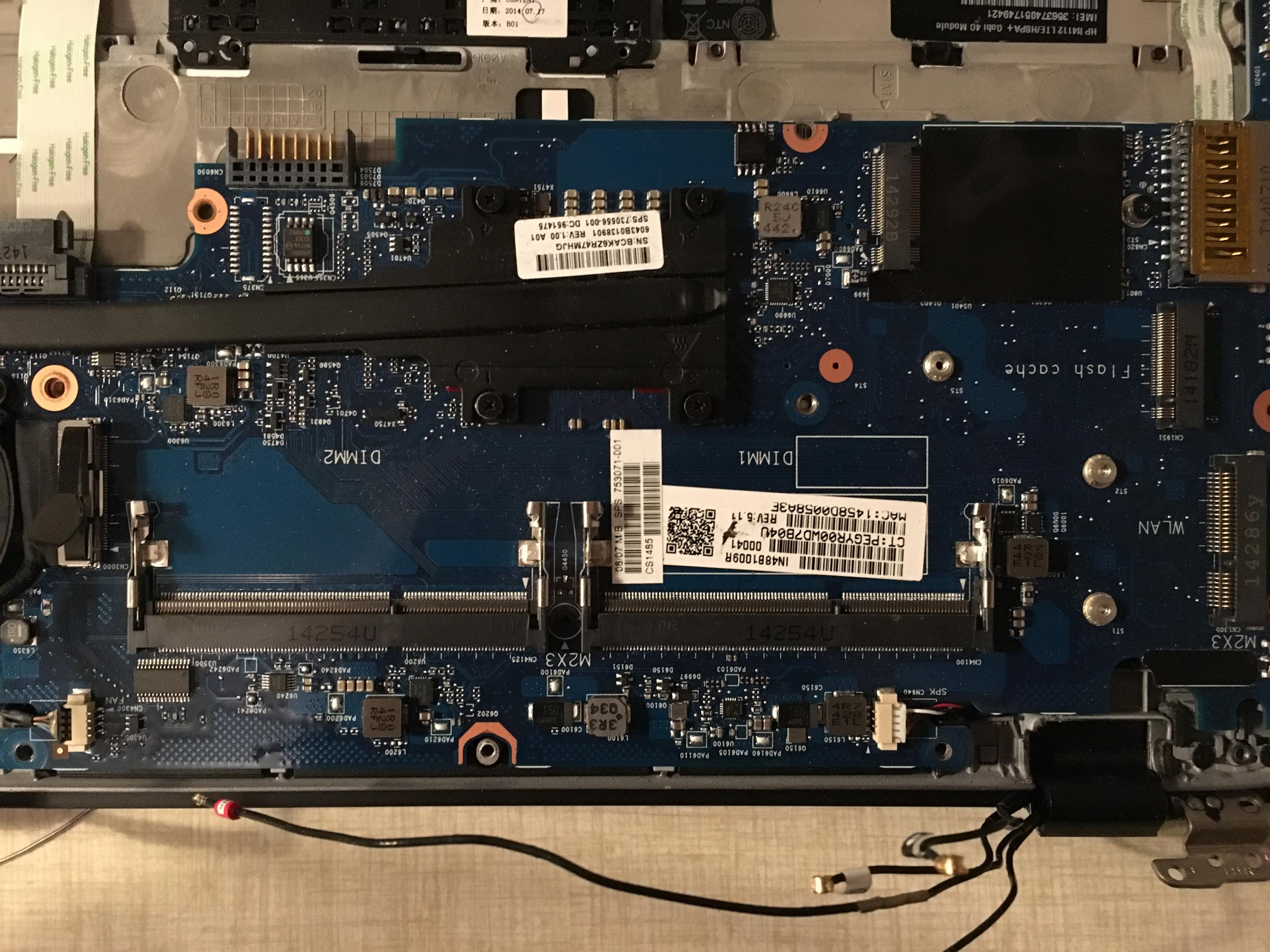

                      HP Elitebook 820 G1 - Still BIOS password after flash
                      The problem is that the BIOS is password protected and i have been reading a lot of threads about this.
                      I bought the "USB Programmer CH341A Series Burner Chip 24 EEPROM BIOS Writer 25 SPI Flash". (had to wait about a month to get it...)
                      The BIOS i got from HP.
                      Since im good at electronics and soldering i desoldered the BIOS chip from the mother board without any problem.
                      Then i reprogrammed the new BIOS and resoldered the chip.
                      To my dissapointment the BIOS is still password protected.
                      How can i solve this, is the password stored somewhere else?
                      I have attatched the bios files, the "bios_backup.bin" is a backup of the bios.
                      I tested 2 different bios versions from HP and a 3d one which i found here in the forum somewhere.
                      What am i doing wrong?

                                Re: HP Elitebook 820 G1 - Still BIOS password after flash
                                to remove password you should reprogramm ec eprom and bios eprom with a dump taken from the same machine.
                                This method works only if a bios password is enabled, if someone has enabled other protect measure, stored on tpm chip you need to solder this chip taken from a donor board, with its ec and bios firmware
                                  I reflashed the Winbond chip using the HP Elitebook 820 G1 file.
                                  Flashing was no problem but it still tells me:
                                  "USER ID: BIOS Administrator
                                  Enter Password"
                                  I cant get in
                                    Whats the ec eprom?
                                      can you post a photo of the bios chip area ?
                                      I haven't this schematic in this moment.
                                      There should be another chip like bios chip (It depends on the motherboard model) , this chip contain the firmware for the ec also named super I/O
                                        Here is the main board. The bios is the one upper mid left of the copper ring. There is a chip with same package just below the battery connector.
                                        But even if i identify the ec i dont have a dump for that :/
                                        What can i do?
