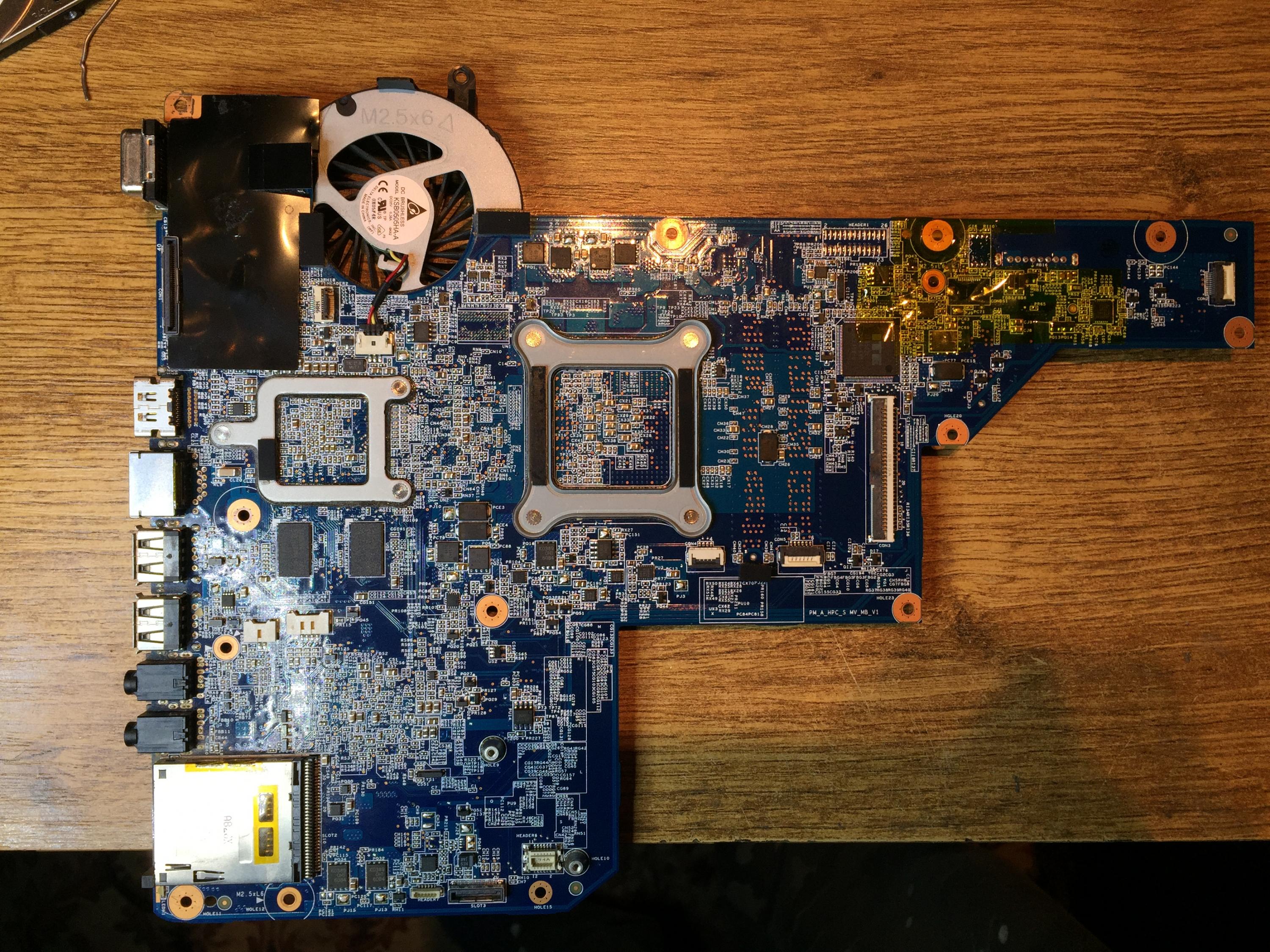

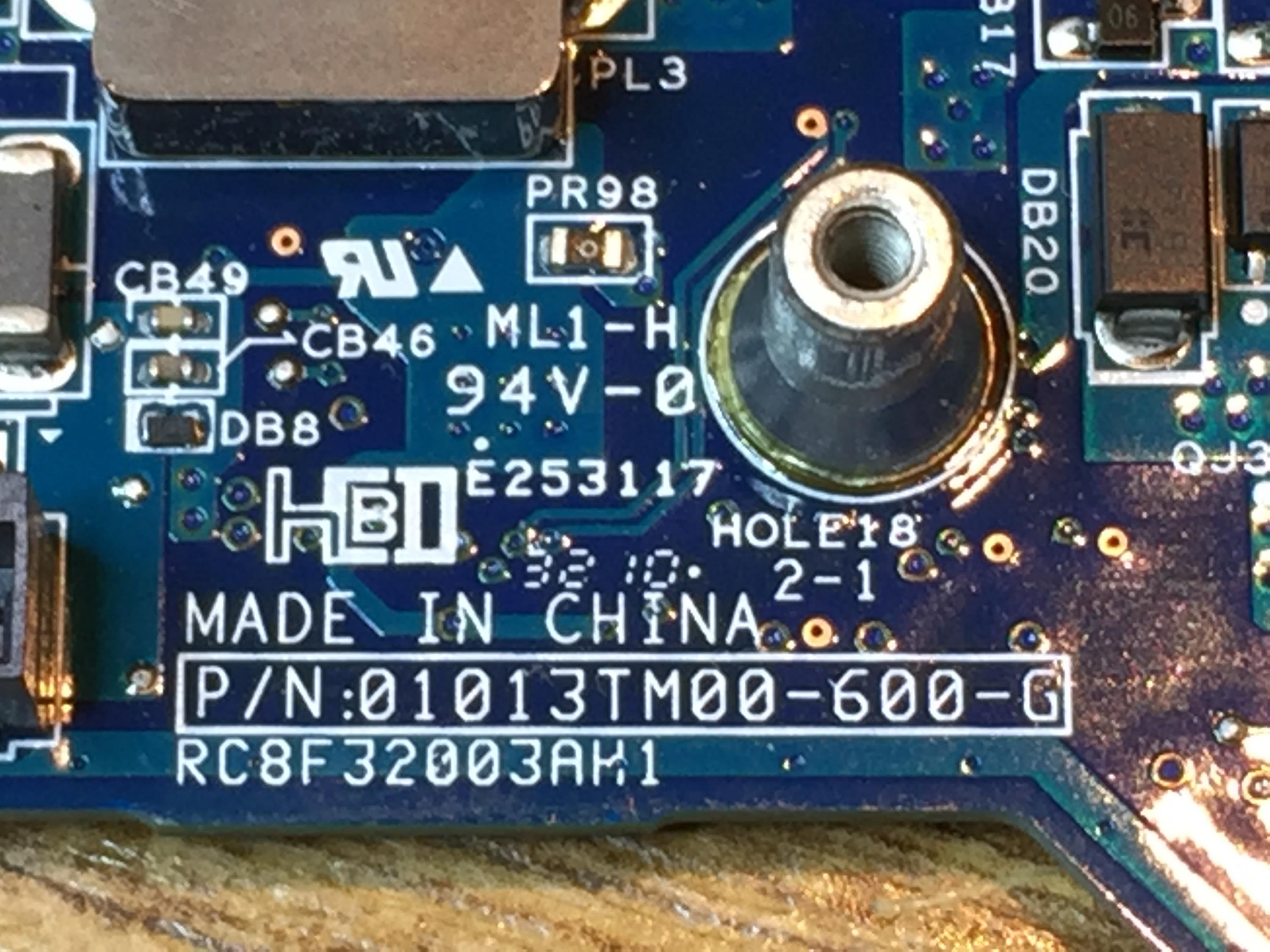

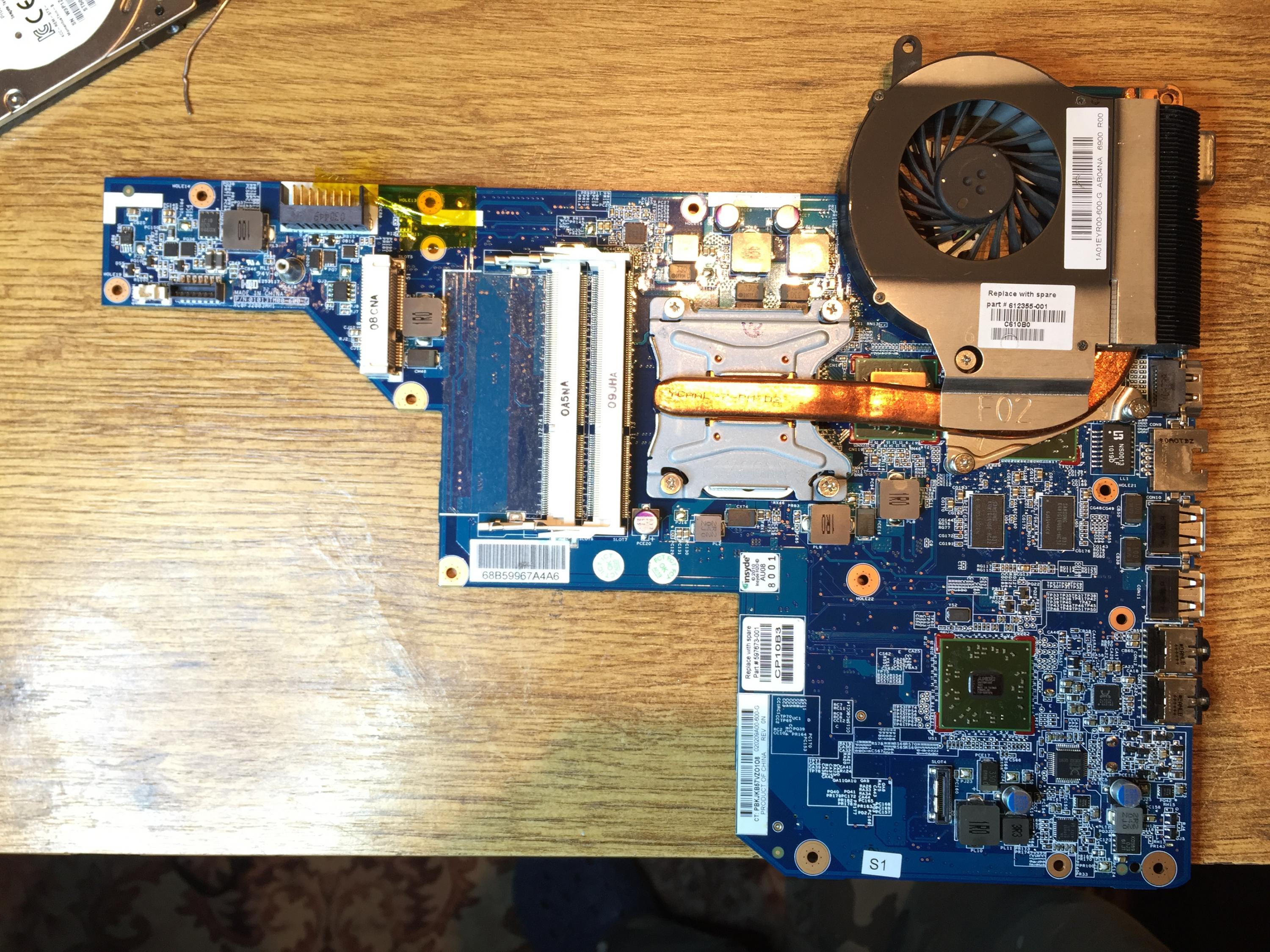

    I have problem with this laptop. Laptop turns on automatically after power adaptor is connected, fan running , leds lights up and screen is black and when I hold power button to turn laptop off , it only reboot laptop. Have someone EC bios dump for this laptop? mb p/n 01013tm00-600-g
    thanks for any answer!

      Don`t bother with bios...this board has only one main bios...you have a faulty northbridge...Replace it...

        I replaced 216-0752001 and still black screen. Any idea?

              now measure voltage on pin 33 and 125 of IT8502E before and after plugging the AC adapter in.

                With adapter:
                pin 33 - 3.345V
                pin 125 - 3.342V
                Without adapter - zero values.

                  u have GPU so reball it or replace it

                    check whether a pulse appears on pin125 or not.

                      ktmmotocross: I'll try another dump and then reball gpu.
                      caspian: on pin 125 is still 3.3V

                        unfortunately, SIO and PCH may act strangely sometimes.
                        they make it difficult to diagnose sometimes.
                        we cannot diagnose whether it is SIO or PCH which is faulty.
                        For example, I replaced SIO this week but it was not faulty in the following thread:
                        https://www.badcaps.net/forum/showthread.php?t=65278
                        replacing PCH is not cost/time-efficient on cheap mainboards.
                        So if you can get a healthy mainboard, just replace the entire mainboard.
