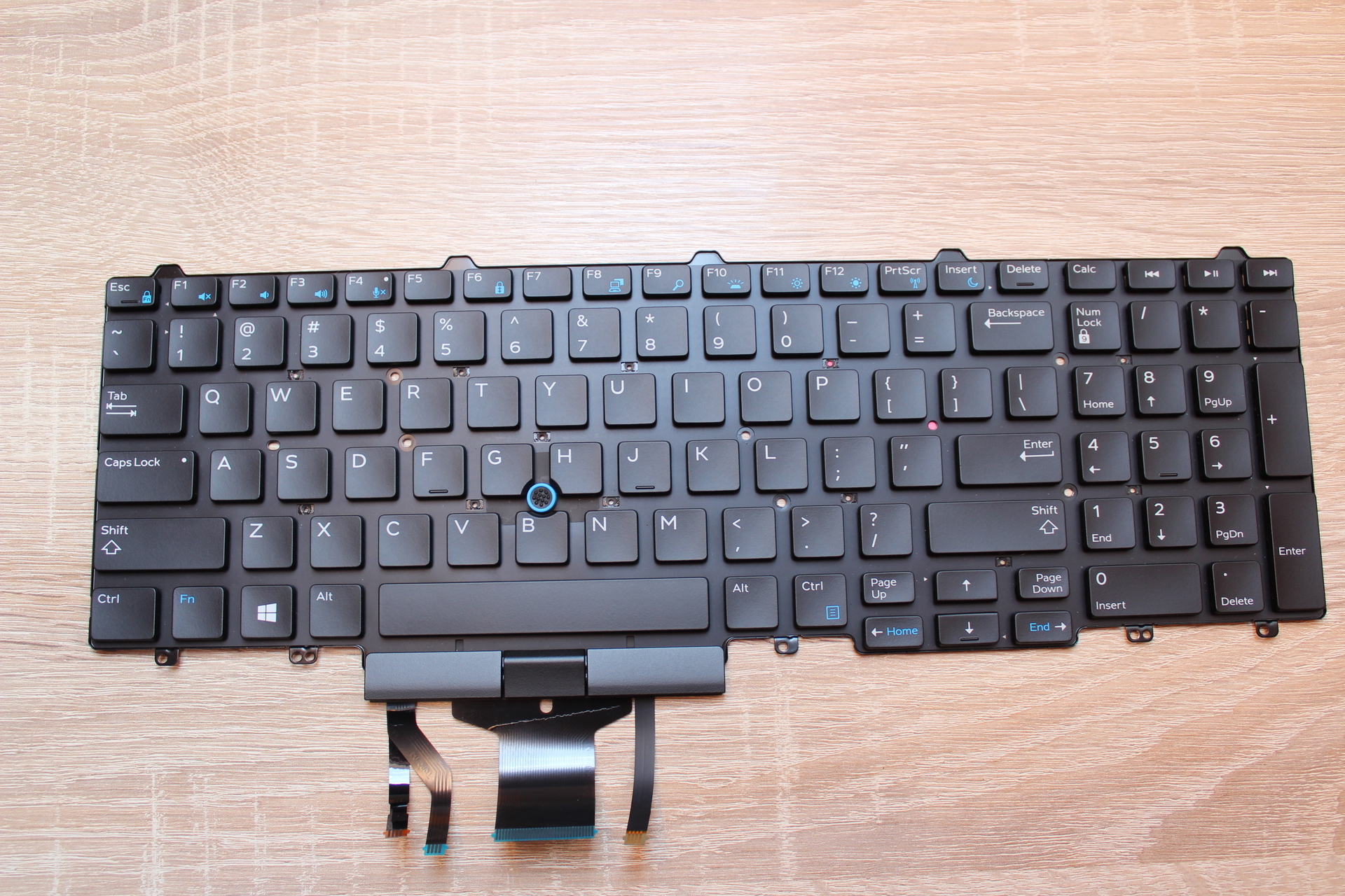

                #147
                Re: urggent plz Dell Latitude E7470 Bios Password
                Originally posted by ZetGka
                thank you very much for your answer, unfortunately the codes don't work
                Please note the password is written for a US QWERTY keyboard.
                Must also be forced to enter.
                • Markus1741
                  • Sep 2020
                  • 983
                  • N/A
                  #148
                  I think entering this password correctly should work, at least that's how it always worked for me.
                  HP6M3G2-E7A8 = 9zJ83m2hrZ[r7FJ9
                  Not forget to press Ctrl + Enter
                  See also the picture of a Dell E5570 US keyboard.
                  • ZetGka
                    • Feb 2023
                    • 3
                    • Polska
                    #149
                    Thank you very much Markus1741, it worked. Greetings
