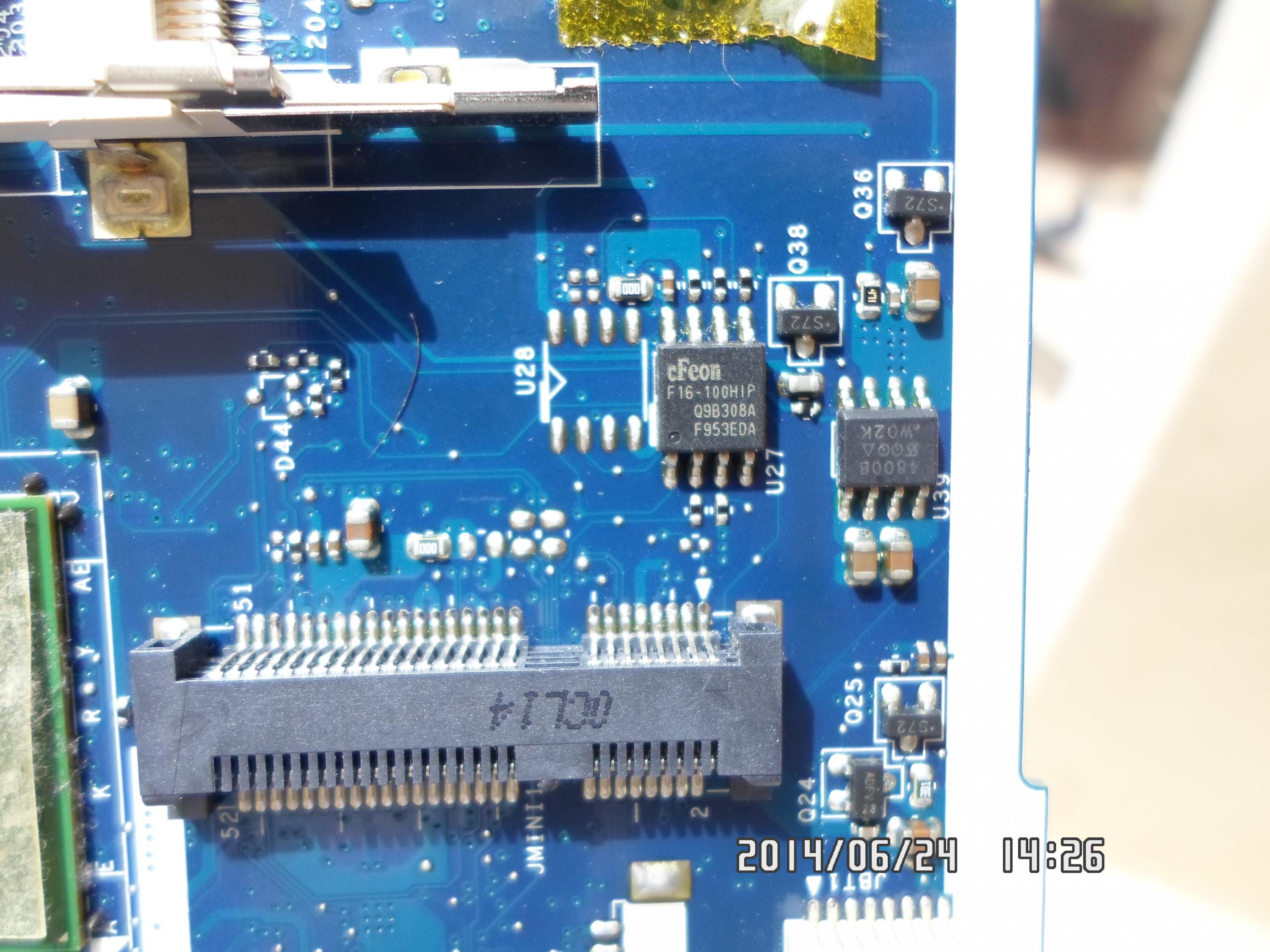

    I'm going to flash the bios on my Acer 5552 can anyone tell me the location of the bios

    The bios chip little big mosfet find near kb controller or graphs chip.
    The bios chip winbond/cfeon/ or many manufacture name.

      check u27

        U27 between DDR slots and mini PCI-E
