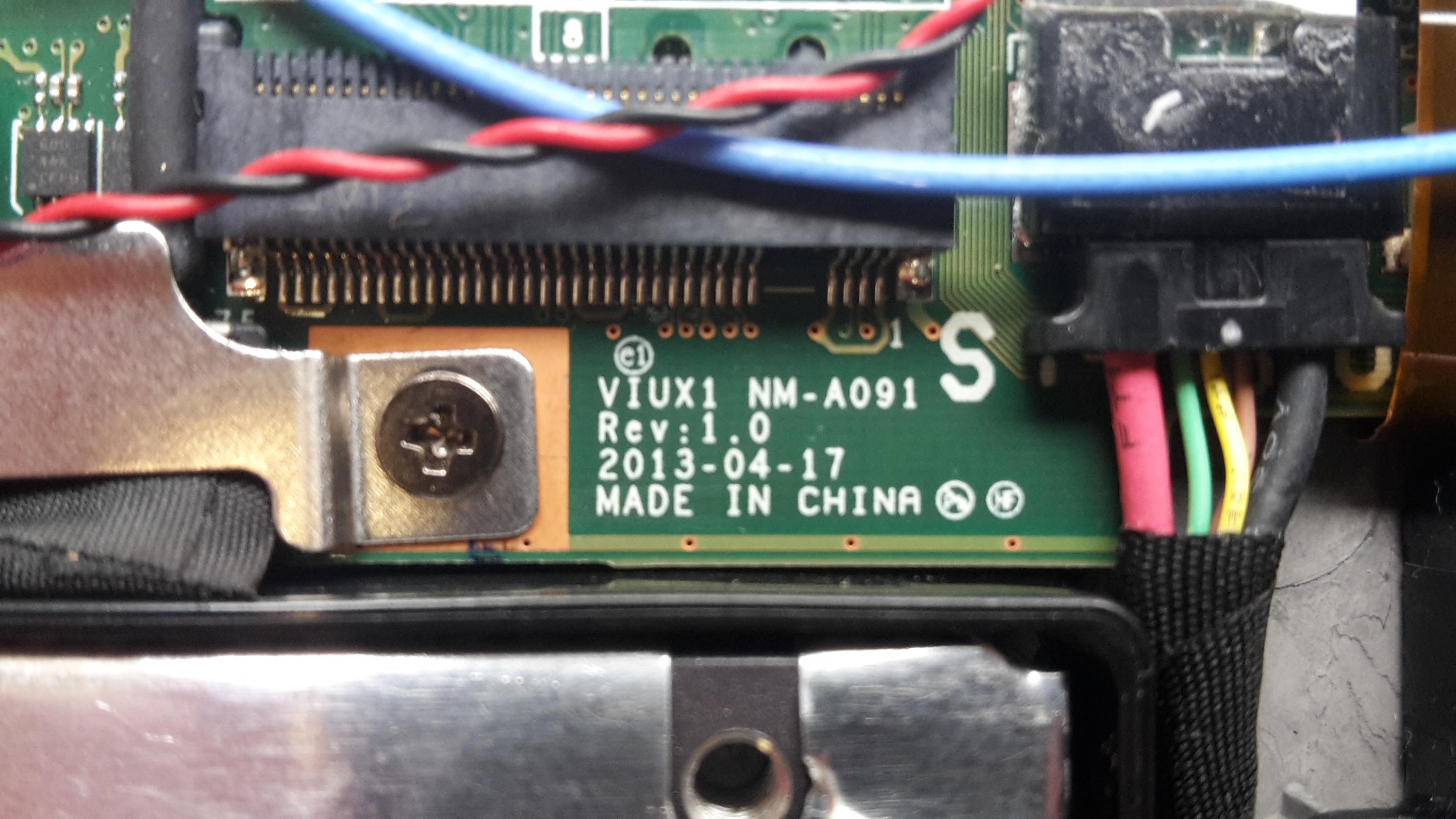

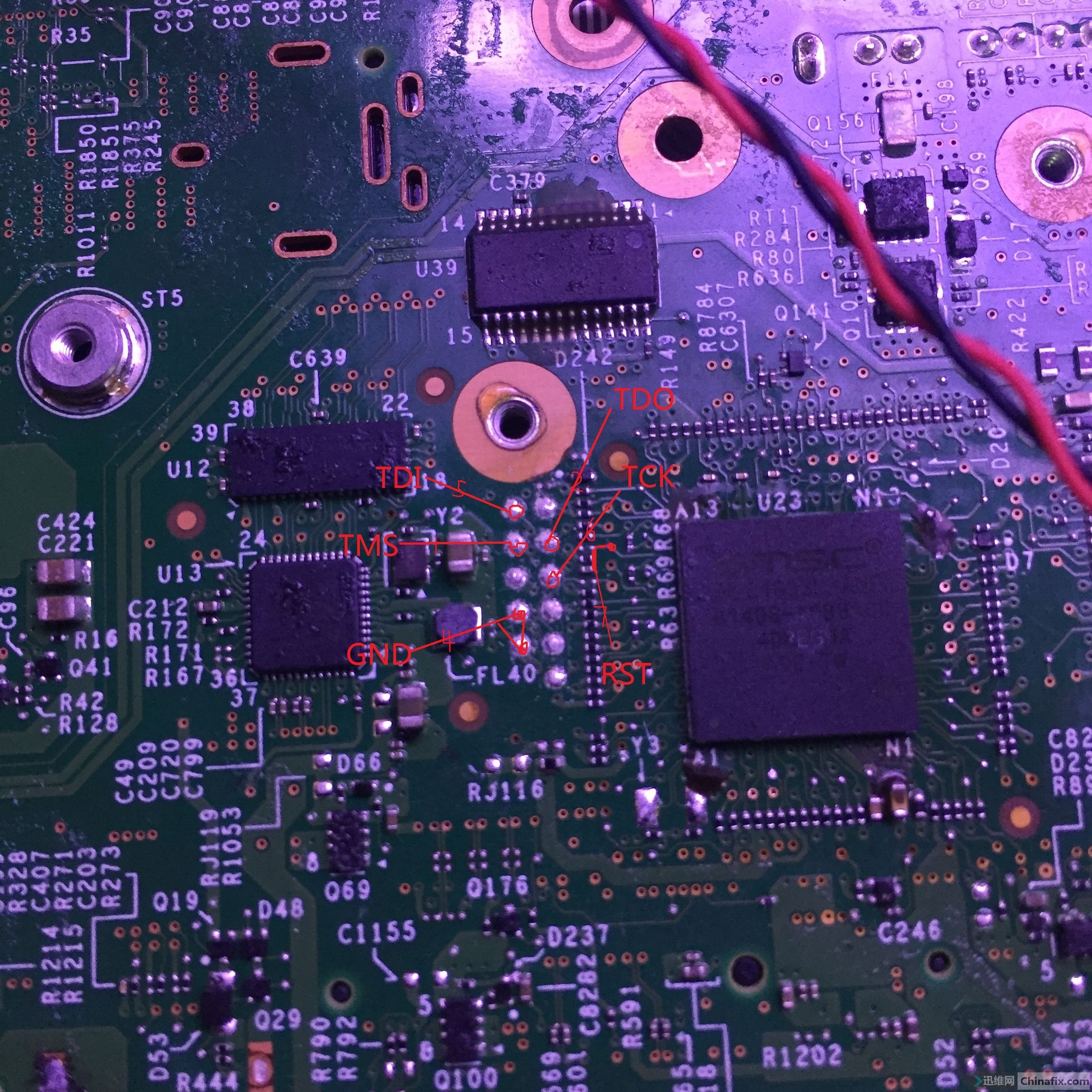

                  Re: Need bios dump for Lenovo Thinkpad X240
                  the problem is, my little son somehow put a bios password and i dont know it
                    my dear son if the password is supervisor password doesn't work bin file and bios dump the supervisor password remove replace the security chip on the board.
                            pass không nằm trong bios, nó nằm trong mec1633
