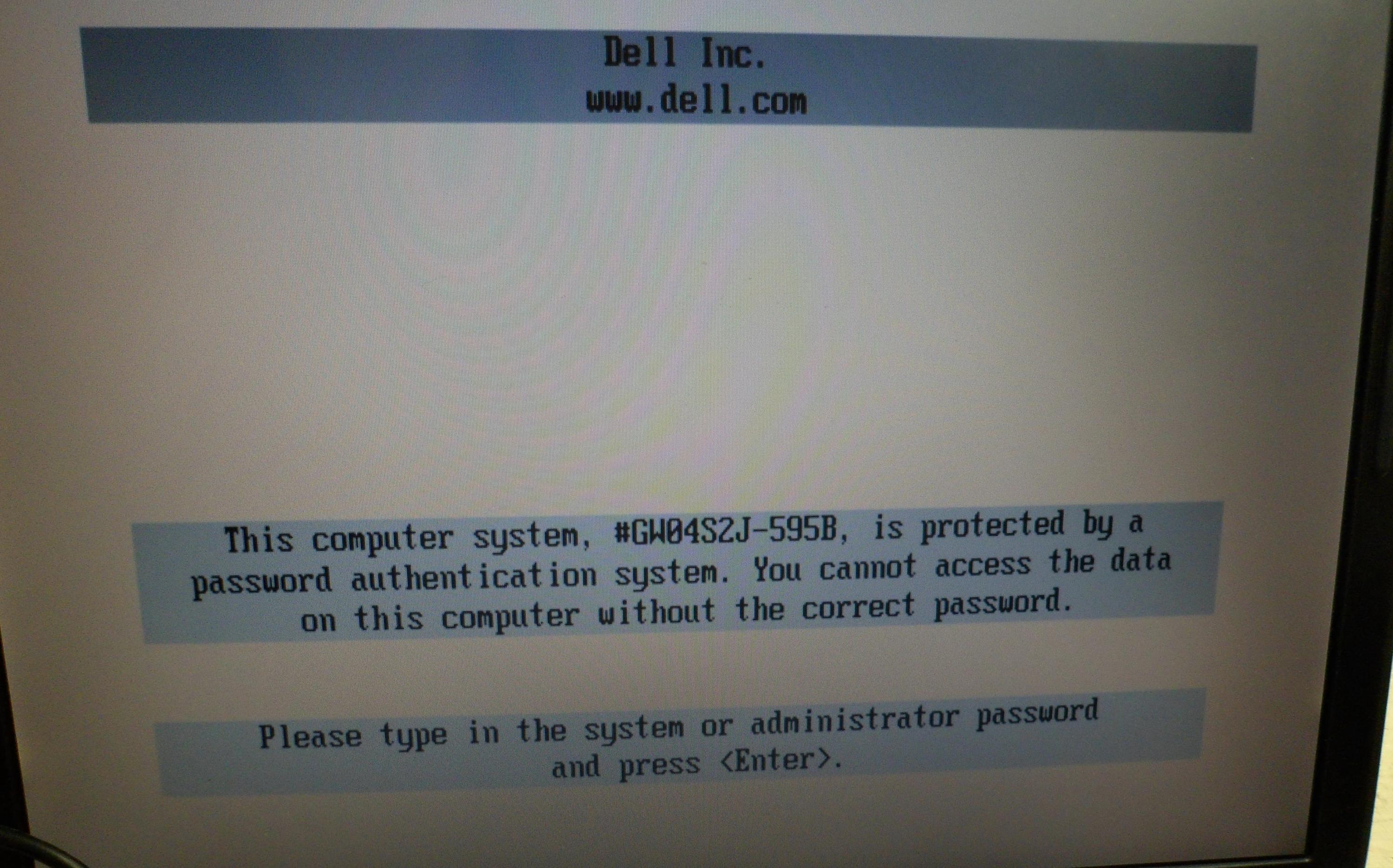

    Hi .....
    i need your help . a DELL LATITUDE D520 coming with problem .
    a password in bios and i can 't enter in bios setup or system .
    i have flashing the bios but still the same .

    This password should do it, 1zxqpxrz
    needs to be entered on a Qwerty keyboard
    good luck

        it s ok mr trebo
        1zxqpxrz is the corect pass
        thanks

            the problem is not solved
            after to inter to setup and restart the same message .
            i don't know why

              must enter bios setup, input password and set security to disabled and then save and exit setup
              after that flash bios

                TAHNKS ala_borbe
                IT S OK
