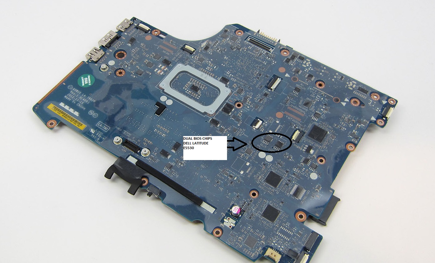

    Hey
    Please help for a bios password
    Dell LATITUDE E5530
    System Number 4X7QVY1-1D3B
  • wallyoz7
    • Mar 2015
    • 21
    Re: Dell E5530 Bios password needed
    If you could replace these chips , bios password will go away.

                Re: dell latitude e5530 password reset
                1d3b service tag password only solution bios flashing new dump if u have eeprom programmer try this dump.
                    File ROM 64 U52.rom is 64 bytes longer than it should be, is this dump tested and working?
                    • imranromi
                      • Jan 2015
                      • 1291
                      • Pakistan
                      yes this dump is working and u52.rom is 8mb file size.
                      • IDislikemakingLogins
                        • Feb 2017
                        • 38
                        • moon
                        i trimmed the extra off ROM 64 U52.rom. was just extra FFs at end of file. Thanks works well.
