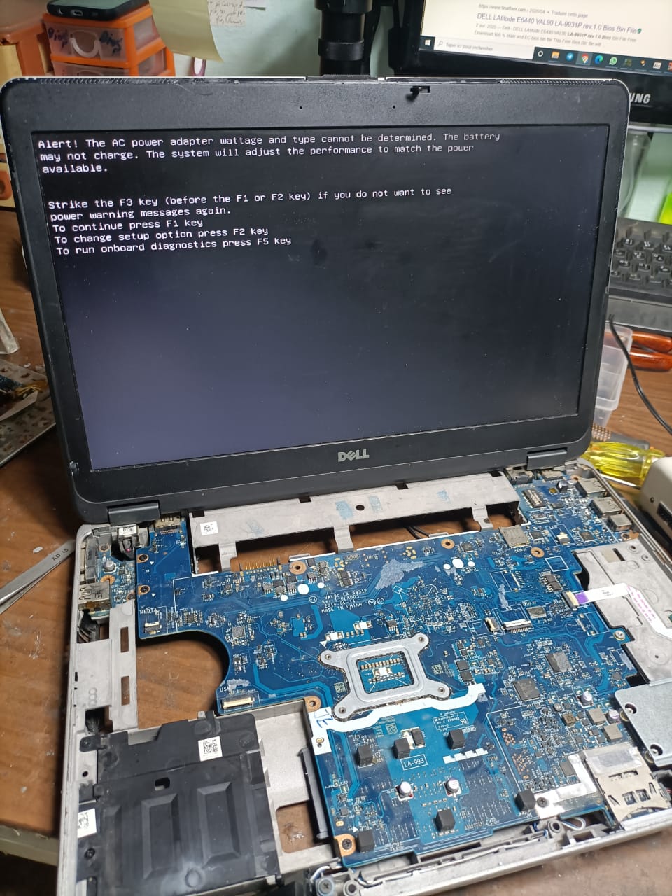

        E6440 Shout Down After 20 second laptop auto run
        hello guys,
        Model: Dell Latitude E6440 When I close my laptop, it opens automatically after 20 seconds. I don't have any match in any of the EC bios nets. If you take a bios from the net, the display doesn't come. I gave two of my bios. If you give me a little bios, I will benefit. Thank you all.
        • hoaca388
          Badcaps
          • Jan 2022
          • 11874
          #64
          Re: Shout Down After 20 second laptop auto run
          Originally posted by bdschemetic
          hello guys,
          You have to upload original bios file of that laptop here.

            please hell me la-9931p bios ec 4mb bios not working no display.
            my bios is display run but not shutdown 20second sometime run
            (emadarion) ec bios dispaly not run please clean me bios
            Brother, I don't know how to download File as a new user.
            hi friend
            can anyone give me cleaned me bios bin of dell latitude E6440
            thx
            my orginal bios here

                VAL91 LA-9931P Rev 1.0 (A00)
                bin tested
                • brokecil
                  • Feb 2022
                  • indonesia
                  #68
                  Re: Dell e6440 LA-9931P BIOS
                  Originally posted by matusiq
                  This one is my BIOS tested and Cleaned ... Working without any delays. Try it
                  Flash 8MB and 4MB ...
                  Report back.
                  its working in my notebook..
                  thanks sir
