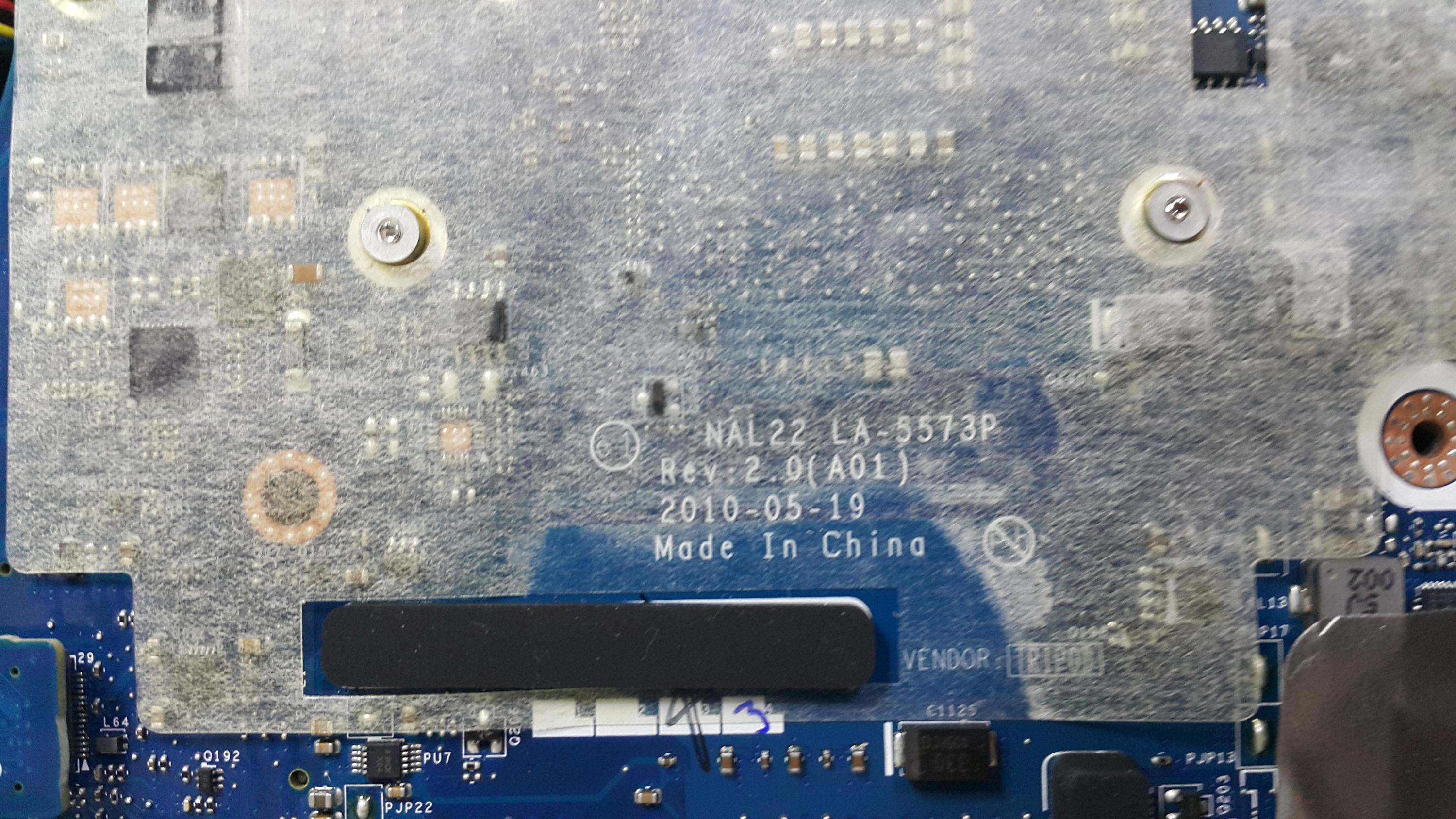

      Re: Latitude E6510 BIOS PASSWORD
      Latitude E6510, Compal NAL22 LA-5573p ( v.04)
      try this one .
          i tried this file before but password remain change only bios version A06 but the password remain .
          Any other suggestion please.

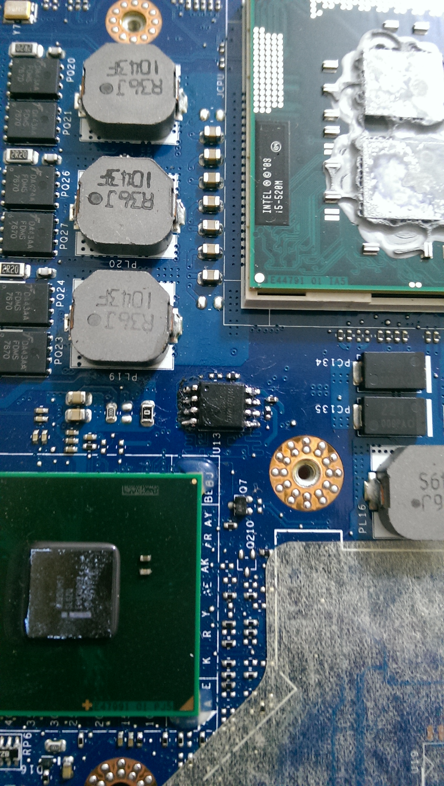

                            no change password remain again , replaced with another WINBOND 25032BVSIG (the same like the original) flashed with dump without password.
                            I find another chip like bios chip U35 but my eeeprom EZP2010 not detect this chip.
                            i don t know what can i do i have 3 pcs from this model ?
                                  remove that U35 , and start laptop without.
                                        Originally posted by Claudio Silva
                                        OK friend
                                        Dell Latitude E6510
                                        Service Tag: 3VCJ1P1
                                        Express Service Code: 8425842517
                                        Is that correct?
                                        i just try to remove U35 burt not power up without this chip , stag and axpress code are ok.
